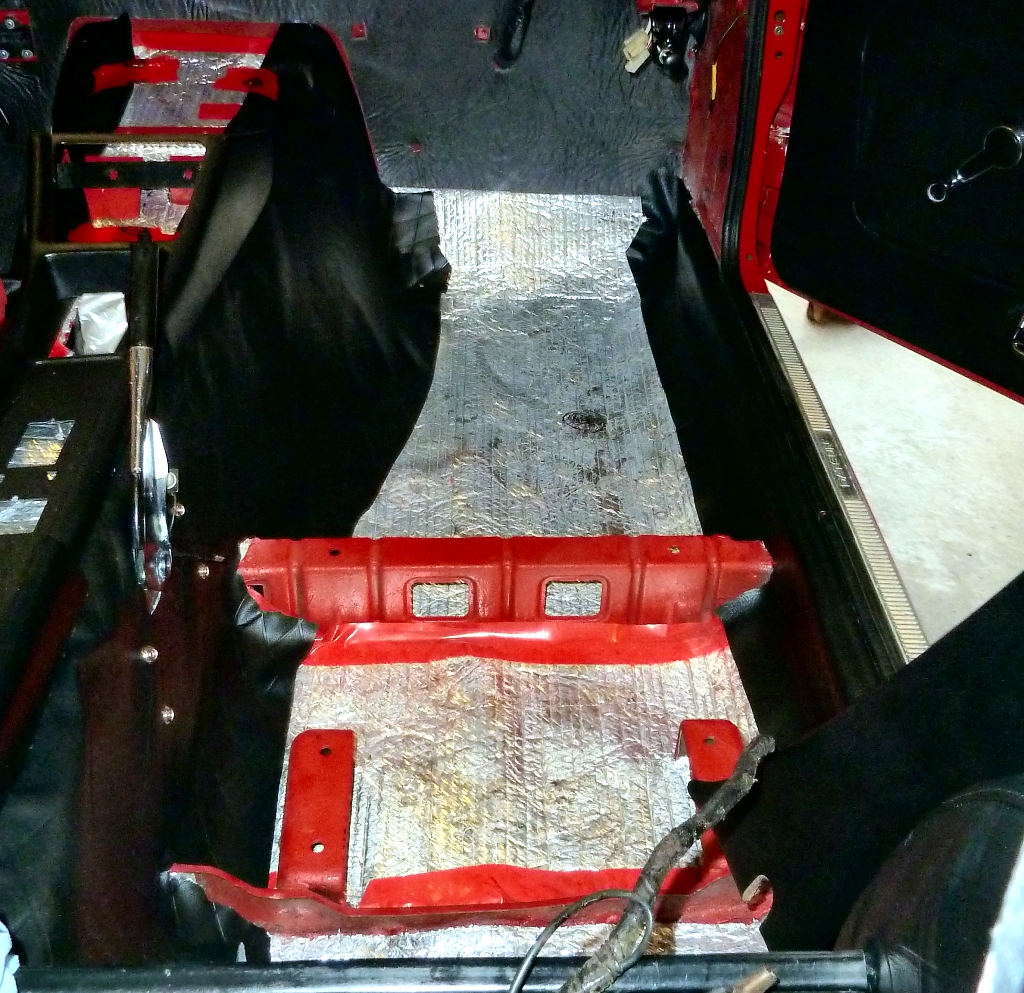

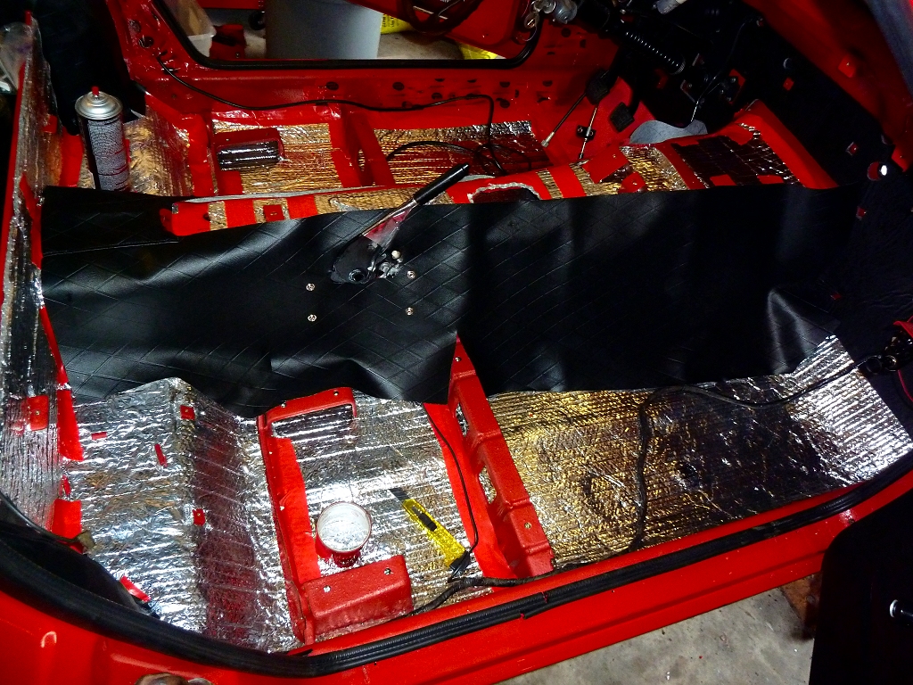

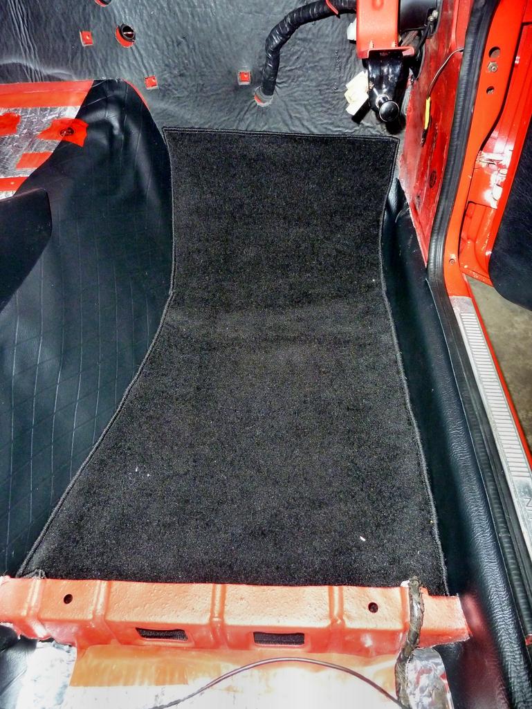

Here is what I did. I had to use anti-slip rubber as the floor mat would slip

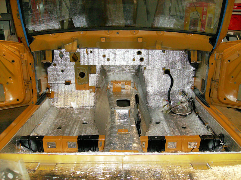

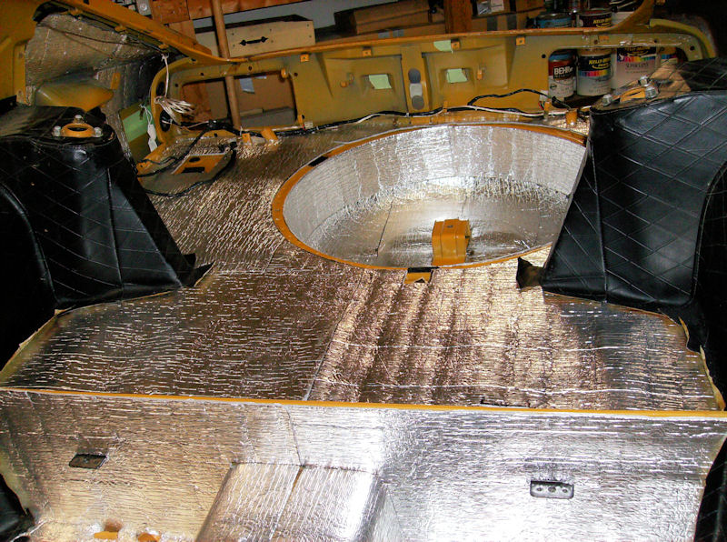

I did the same thing as Blue throughout the car. And had the same carpet slip problem, also solved with some adhesive-backed non-skid strips in the footwells. DO NOT use bubble insulation for this - it will crush and also breakdown. This is foil-backed 1/4" closed-cell polyethylene insulation, installed with 3M spray adhesive.
