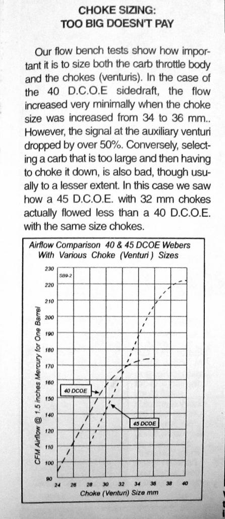

AS luck would have it, I happen to be looking through my Weber carburetors tuning tips and techniques book and it happens to have a cutaway from a DCOE 15/16 and how to check the float level on those particular carbs. Man, the usefulness of books and literature is just staggering in this hobby.
The main venturi is called out in my weber book to be a 38mm for a 45 DCOE 15. I know I have a hotter cam which would need more airflow if the head can supply it adequately. I think on the roadster forum there is a flow bench test of the U20 head. Each barrel of the carbs must feed a full half liter, a whopping 500cc, where as in the L28 I have in the Z each barrel must feed only 466cc
go down to a L24 and naturally it drops to 400cc
Going to a smaller choke size may increase my sensitivity to a throttle inputs. But I will leave that alone, as the 45 DCOE 15 was made originally on the 1800 BMW sedan. So while engines differ, my hot 2.0 liter should be able to handle it within reason.
Now I still need to verify the chokes are in fact 38mm and now some 40mm monsters.
