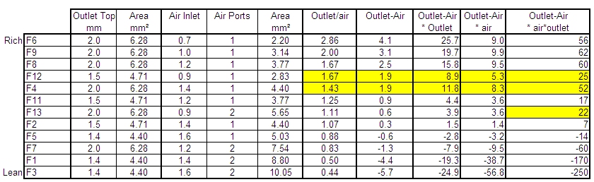

The problem is the F9 runs marginally richer than the F8 given the same fuel orifice per weber documentation:
Rich - F6 F12 F9 F8 F11 F13 F2 F4 F5 F7 Fl F3 - Lean
So the 50F9 could have been much closer to the 55F8 than I wanted, which makes sense as the results were only slightly worse.
Likewise, the 60F9 was probably two many steps to the rich side as I think she is burning a bit rich on throttle application, but I have zero hesitation or stumbling.
What I should try is a 55F9 or a 60F8

Here are the dimensions of Weber Idle Jets in case you wish to drink and drill :)
