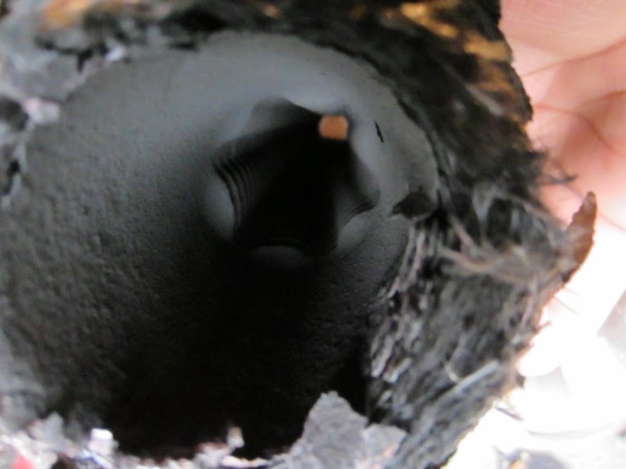

Top glasspack broke off! Not only was the glasspack a 2in inlet to a 1.5in outlet(already impossible to find) but the interior looks completely different than the modern glasspacks.

Original
https://lh6.googleusercontent.com/-QtZ2x3NiWQw/UYunJpST29I/AAAAAAAALFA/2gjvkhMrIBM/w903-h677-no/IMG_1640.JPG

The interior looks like a typical glass pack that I've seen.

I didnt install it, im guessing it was installed back in the day at some dealership along with the Racer Brown cam aka "Slalom camshaft" in the comp. catalog. I know 2" is probably too big and true duals make less power but if its made it 43 years like this I dont really see a reason to change it (plus ive got power to spare ;):stupid:LOL). I think the small outlet helps a bit but I think whats making that raspy noise is the interior of the glasspack. Ive still never seen anything like those fins inside. A big issue I noticed coming from the straight pipes is the resonance at about 2k and im not sure a homemade glasspack would help with that (or honestly how that works). I know a bunch of people probably think im crazy for wanting my car to sound like a bees nest but after a while you really start to like it. Magical fins?
