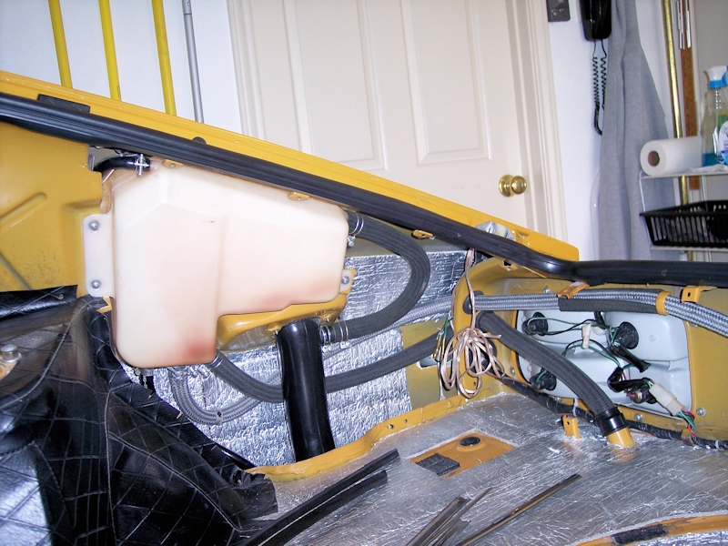

Here's a picture of the evap tank hookups to the fuel tank. Your evap tank may be metal but the connections should be the same. Look closely at the top left of the evap tank for a small hose - this one connects to the steel fuel vapor line running back from the engine bay. At the bottom left of the evap tank is another small hose that connects to a small pipe on the top of the fuel tank - this is the return line for any fuel that condenses in the evap tank. You will have to have this hose in place on the fuel tank before you raise it back into position. I'll look for or take some pics of the engine bay vent line connections for another post. On the major tank vent hoses I used genuine Nissan parts but others have substituted generic fuel line hoses with great success.

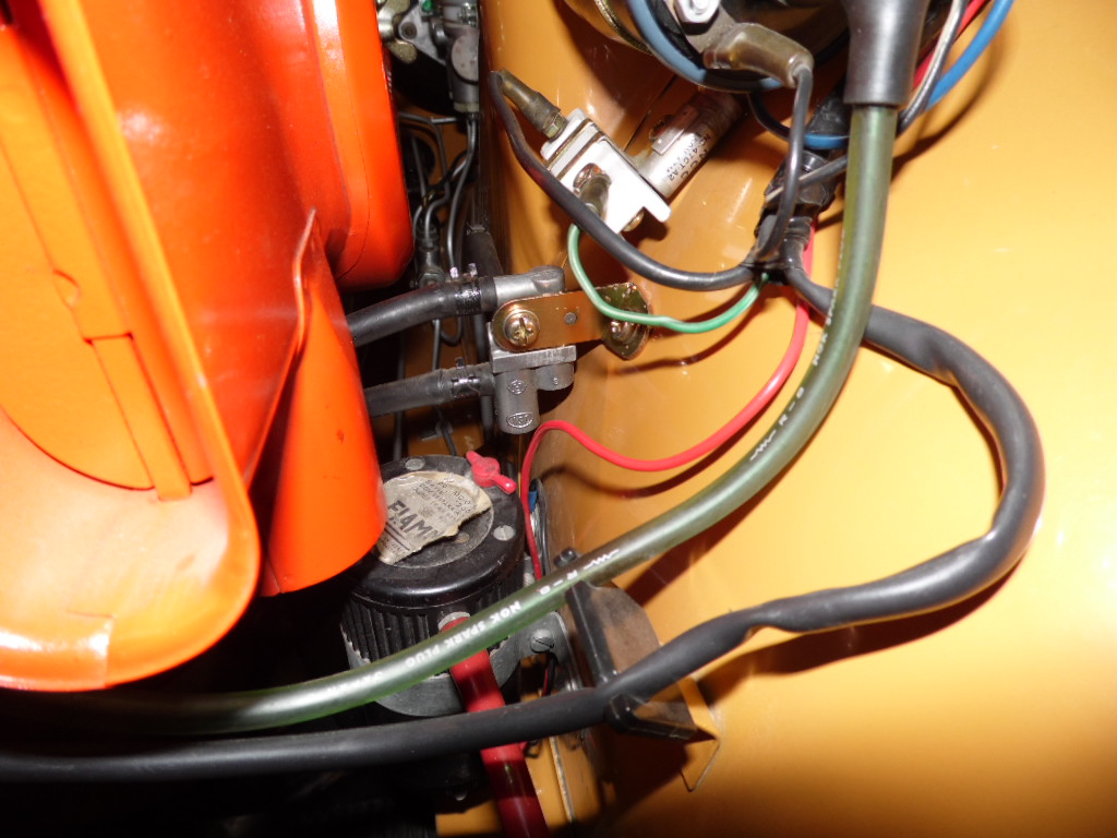

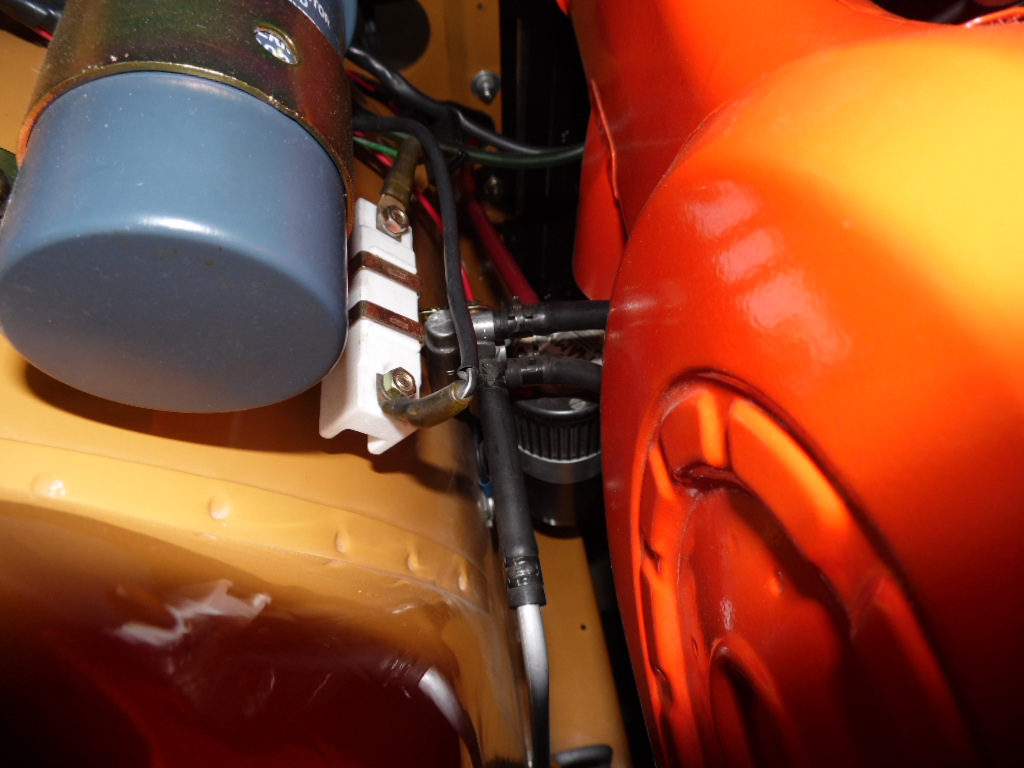

Here is the vapor check valve that should be on your fender under the coil and ballast resistor. The top hose comes from a small pipe in the center of your air filter box. The lower hose comes from a small pipe on the large crankcase breather pipe coming off the engine block. The second pic shows the return hose onto the steel line returning to the rear of the car. The steel line should be visible along the left rail.

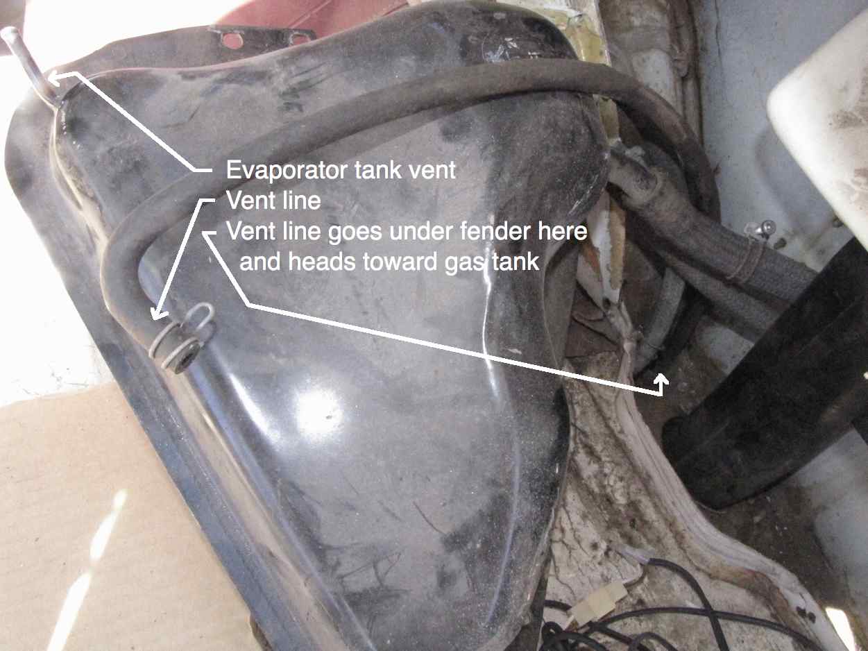

This is a picture of a 1/1972 car evaporator tank laying on its side. The vent line heads for the gas tank after it exits the bottom of the fender next to the filler hose.
The rubber vent line was pulled off of its connector on the evap tank before this picture was taken.
