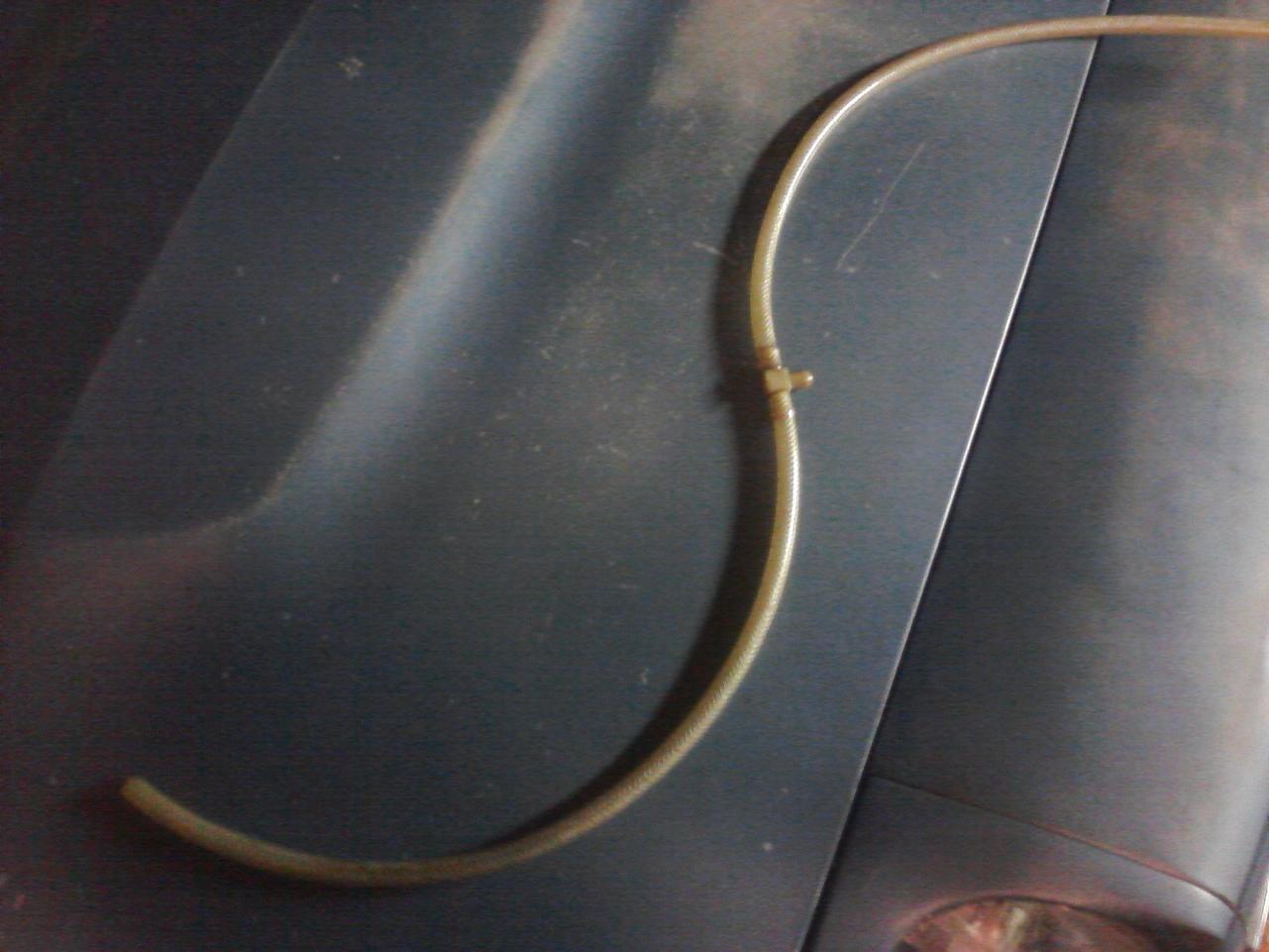

I've already sealed up the new connections I made at the sending unit so I tried shorting the yellow and black at the gauge. It didn't work out so I put this down the filler neck trying to raise the float
Guess what happened? yeah the T got hooked and wouldn't come out. Since I was old enough to walk, over and pick up a hand full of gravel and put in my Dad's lawnmower's tank, I've known not to put anything down the tanks hole. I'm pretty sure it was "DON'T NEVER EVER, NOT NEVER, PUT ANYTHING BUT GAAASE IN 'NAT HOLE!!". I spent 30 minutes coaxing that out, finally using a length of hard copper wire to move it. After I changed my pants and underwear I went and bought 5 gallons of gas, too simple for a man on a mission.

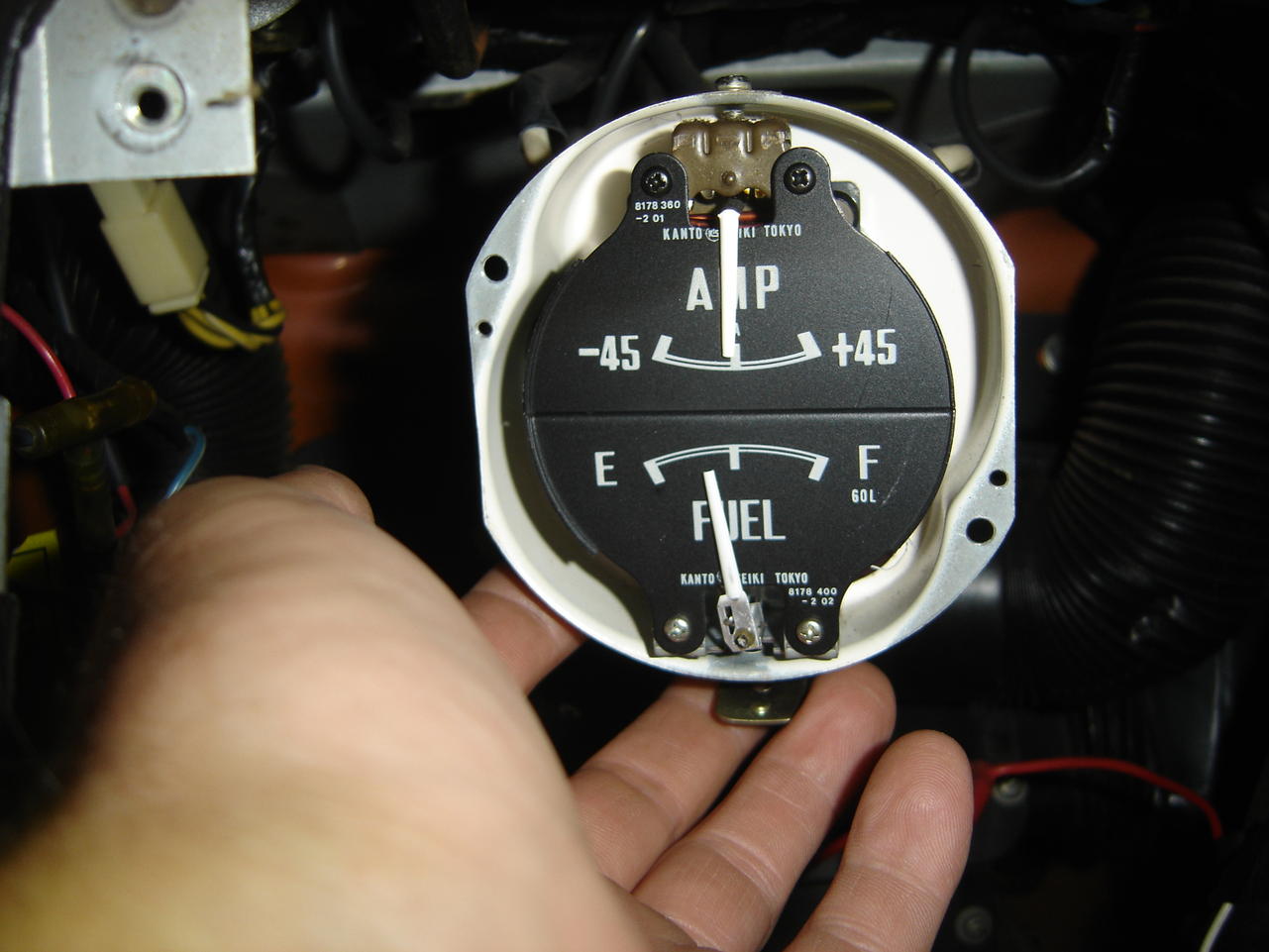

I think I've found the problem. While trying to get to rear of the cigarette lighter, which I can't without removing the heater control panel, I noticed the lens on the gauge had a gap on the right side. So I've double over some Gorilla Tape and pulled the lens off the aluminium divider between fuel and amp gauges. The needle moved! So I'm thinking the Barners I bought this car from, tapping on the gauge too hard has messed it up. The sending unit was frozen with rust and I guess they thought the gauge was the problem. I'll let y'all know what happens. And respect to EScanlon for the write up on removing that panel, RIP sir.
I found the same problem when repairing my gauges. The lens was pushing against the needle. Glad you found it. I glued my lenses and then put it back together.
