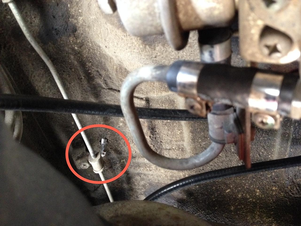

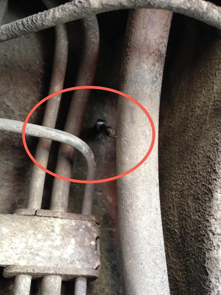

today i had the car up on ramps and was messing around the rear suspension when i saw a shiny screw tip poking down through the sheet metal, and realized it was one of my deck spacer screws. then i saw 2 more of them and just about fainted when i realized just how close i had come to piercing my fuel lines with one of those screws, and my brake lines with another!! i was completely clueless when i was drilling and screwing down from above - incredibly lucky that i didn't wind up with a very different kind of post!!
Brake line near miss:
Fuel line near miss:
