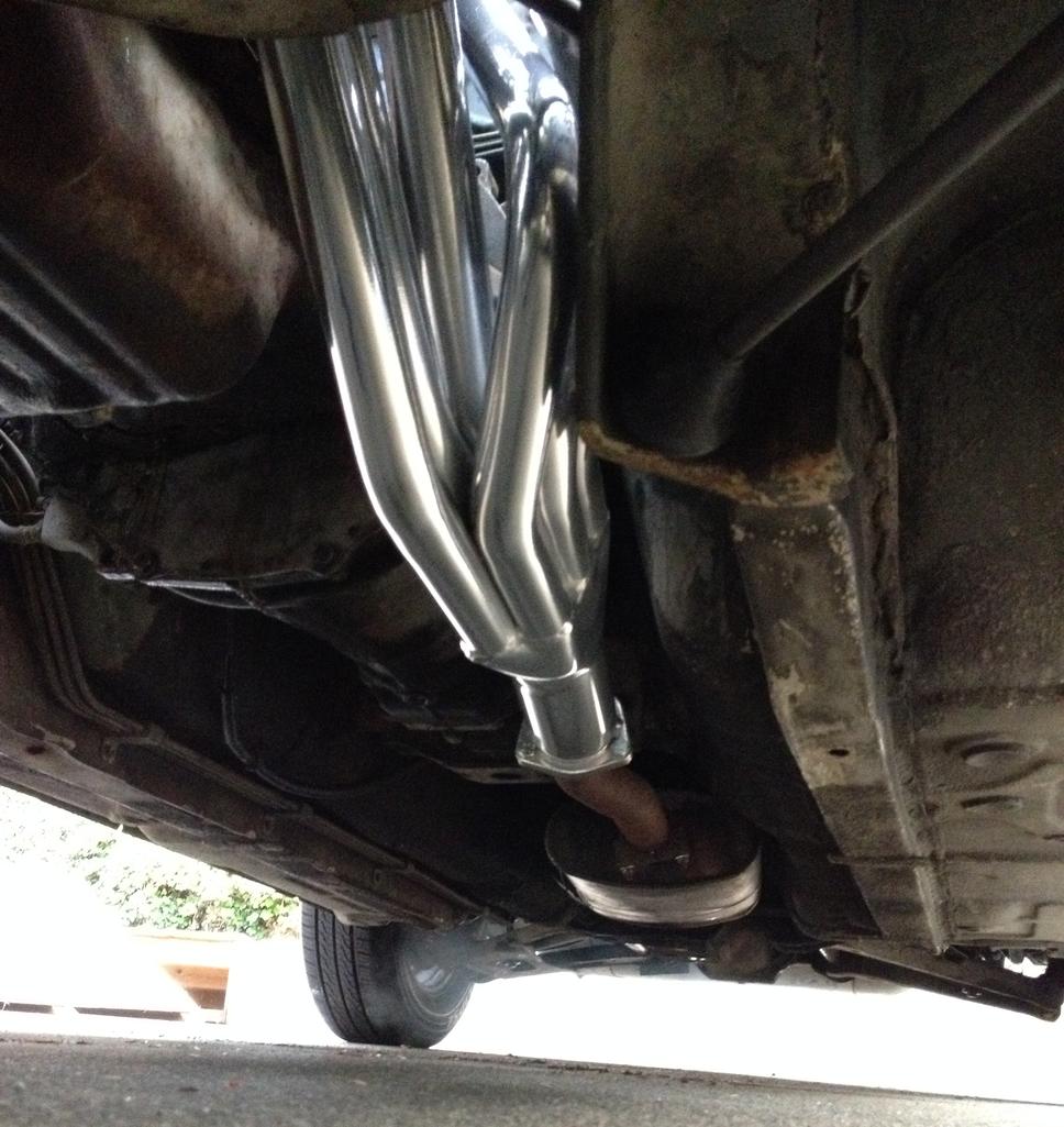

grabbed the bits of oem exhaust i had laying around and hacked off a piece that had a flange on it (from the mid-muffler back), and stuffed it into the old fart-can that used to hang off the back, bolted it up to the header and hung it from the e-brake pivot with a piece of bailing wire to create a surprisingly functional hillbilly exhaust. shocking how quiet it got with less than 6' of junk hung on the header... took her for a longer drive around the neighborhood (raised no eyebrows on this run) and she runs really smoothly. nice idle, smooth revs. i think i need to fiddle with ignition timing and afr a little as it seems a bit rich, but i didn't want to push it for a bit just to let the top end settle in.

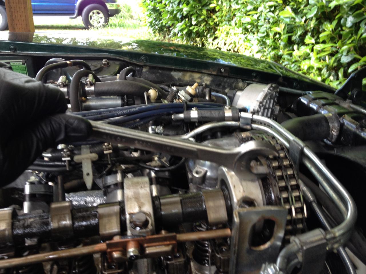

btw - getting the cam gear on took some leverage, wound up using a large open end wrench to pry it up against the cam tower till it was lined up w/the cam nose:

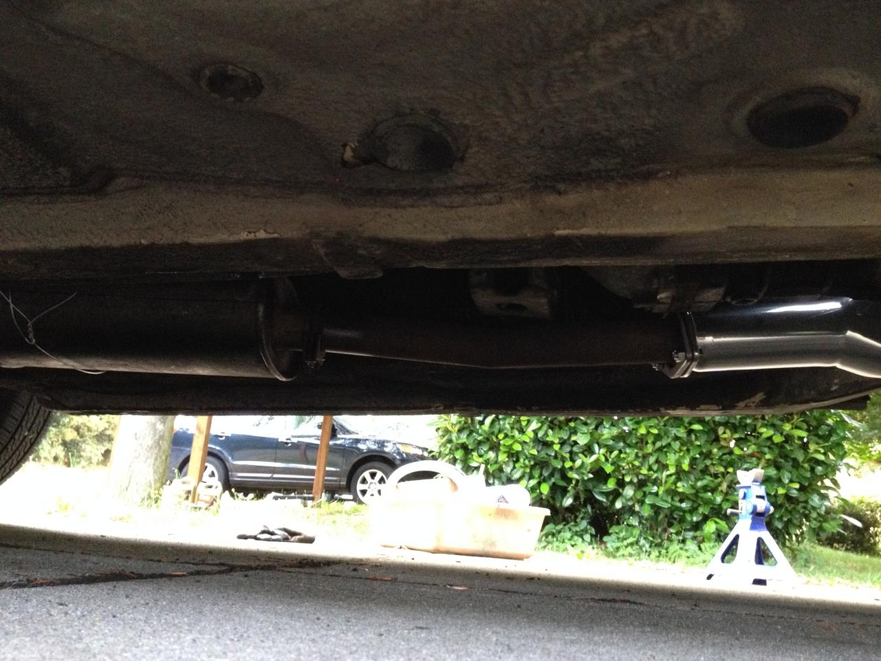

the rossiz hillbilly exhaust:
running smooth AND quiet:
