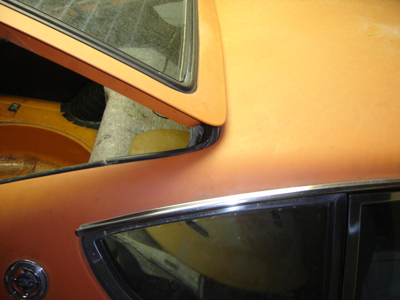

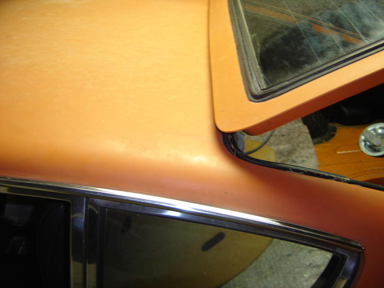

I've always looked for cracking where the hatch's top line comes down to the side window. It's where the strength and rigidity of the body design comes together with a weld and smoothed with some type of body filler. A friend of mine a looong time ago cut the top out of a '75 his Dad gave him. It started "folding up" and he had to have reinforcement welded along the bottom side. Dummy used angle iron and it would get stuck on speed bumps. It's kind of like an eggshell, when you take part of it away you loose the strength of the whole. If it's inspected and has been insured it probably is OK. I'd do some research on it, talk to the shop that did the top and make sure the guys being truthful.

Good info guys, thanks! Will definitely look into that. Hopefully it won't be a problem because that is the one thing the seller really had a lot of knowledge about and talked a lot about the reinforcement etc, and said it cost him over 10k at a custom shop, so hopefully it was done right. But you guys are right, definitely worth a thought/check.

Yikes, inspection didn't go so well. Obviously I didn't think it was going to be perfect but it seems like there are a lot of issues. Amongst other things: Cracks seem to be indicative of previous bondo, big ol' rust spot on the undercarrieage in one of those pics, and the statement that "The door panels seem to be separating from the door jambs up on the top of the door" which I'm not 100% sure he means, but which may be an issue of the convertible conversion not being done effectively, as psdenno pointed out above. What do y'all think? I'm thinking it's just a straight pass at this point, probably not even gonna try to negotiate with the guy.
