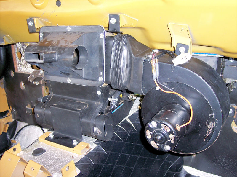

Do I have to remove the ac or just the blower?
This is what you have to deal with AFTER you get the A/C components out of the way. The squirrel-cage housing pretty well blocks all access to the hose clamps, hoses, and water ****. The housing is bolted to the firewall in at least two places as I recall. As to replacement radiator and heater hoses, stick with pre-bent versions and avoid collapses that will restrict coolant flow. Check out RockAuto for your radiator hoses - excellent values!
Well damn! I may be without heat. I don't want to remove all that for a long time, when I restore it right, 10 years or so. Those hoses Bart's talking about are your A/C lines, they come in above the frame rail under the battery on my firewall.

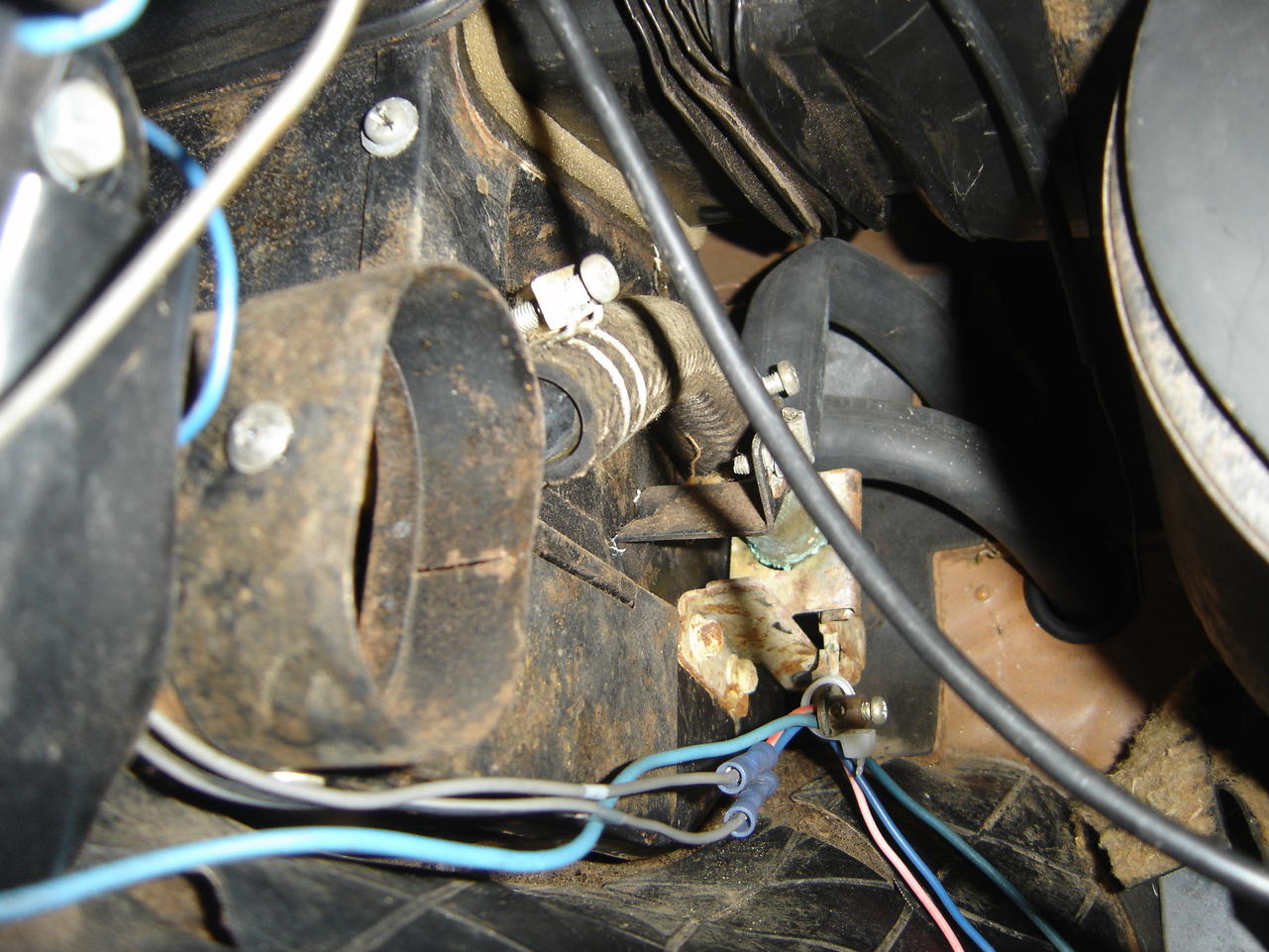

Here's my crusty valve and pinched hose,

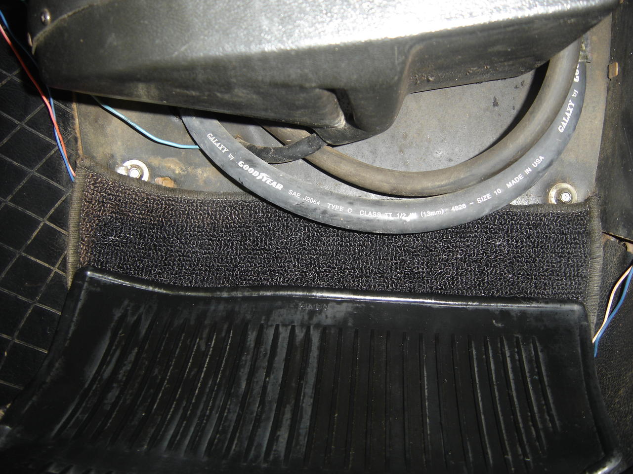

Found the culprit first I removed the seat then I remove the glove box then drop the AC and the hamster cage then I can see the small hose attached to the heater control valve busted i'm going to change the Heater control valve and the hoses and I should be good
Looks like the one that busted is #10, Datsun 240Z Car Heater (To Jul.-'73)
The replacement # is B7118 instead of 27118, according to online nissan parts stores
Those worm gear clamps aren't original, somebody's been down that road already.
