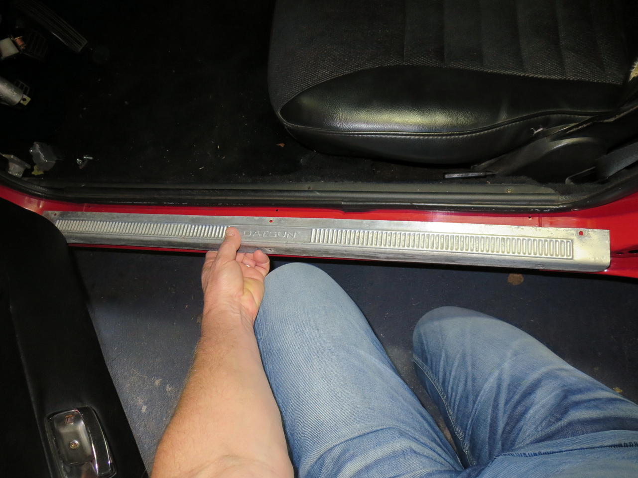

The holes are not the problem. These are simply too long.
My 280Z came from California and was sitting in a garage under the PO's house until I bought it in 2010. It didn't have them when he got it, so the owner in the US removed them for what ever reason.
I found another guy selling a set close by, but with out the Datsun stamped in the center.

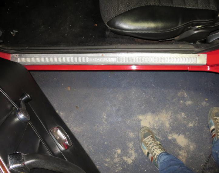

If you look in this photo you can see the three holes in the body and the difference in the sil plate length.
