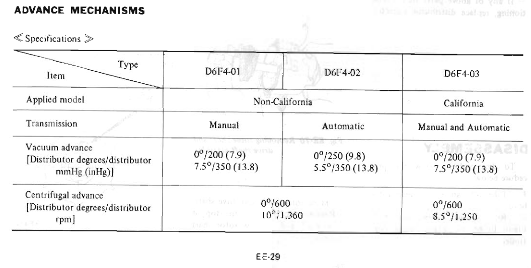

Not clear why it would hunt at 2000 RPM but not at idle.  2000 is in the range of the centrifugal advance slope.  Have you been inside the distributor?
