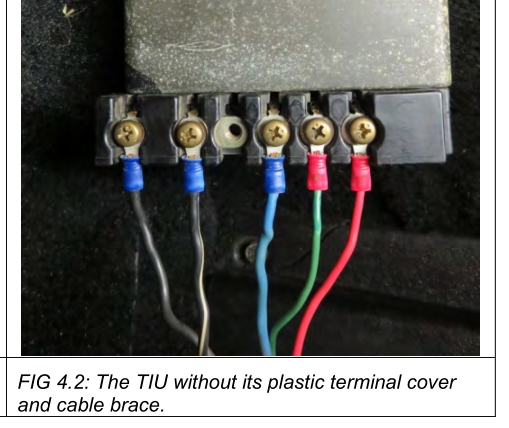

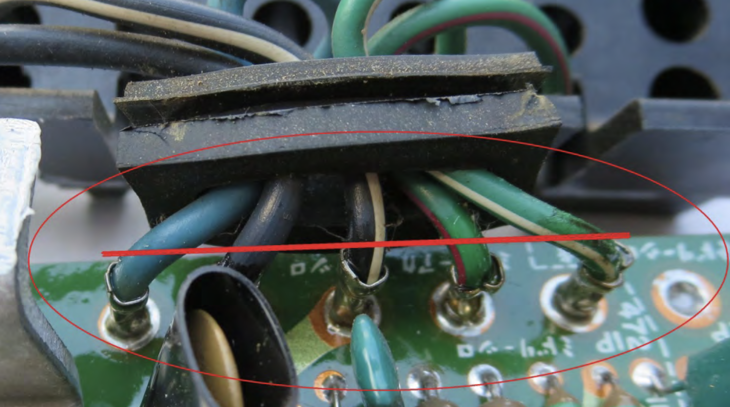

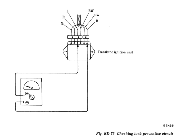

Actually, in his drawing he does show the G and the W labels on the module.  You have to follow the green wire all the way to the module pin.  All of the modules have letter labels on the pins.  That has been my way to remember, the G on the module attaches to Green from the harness.  That leaves W for the red wire.

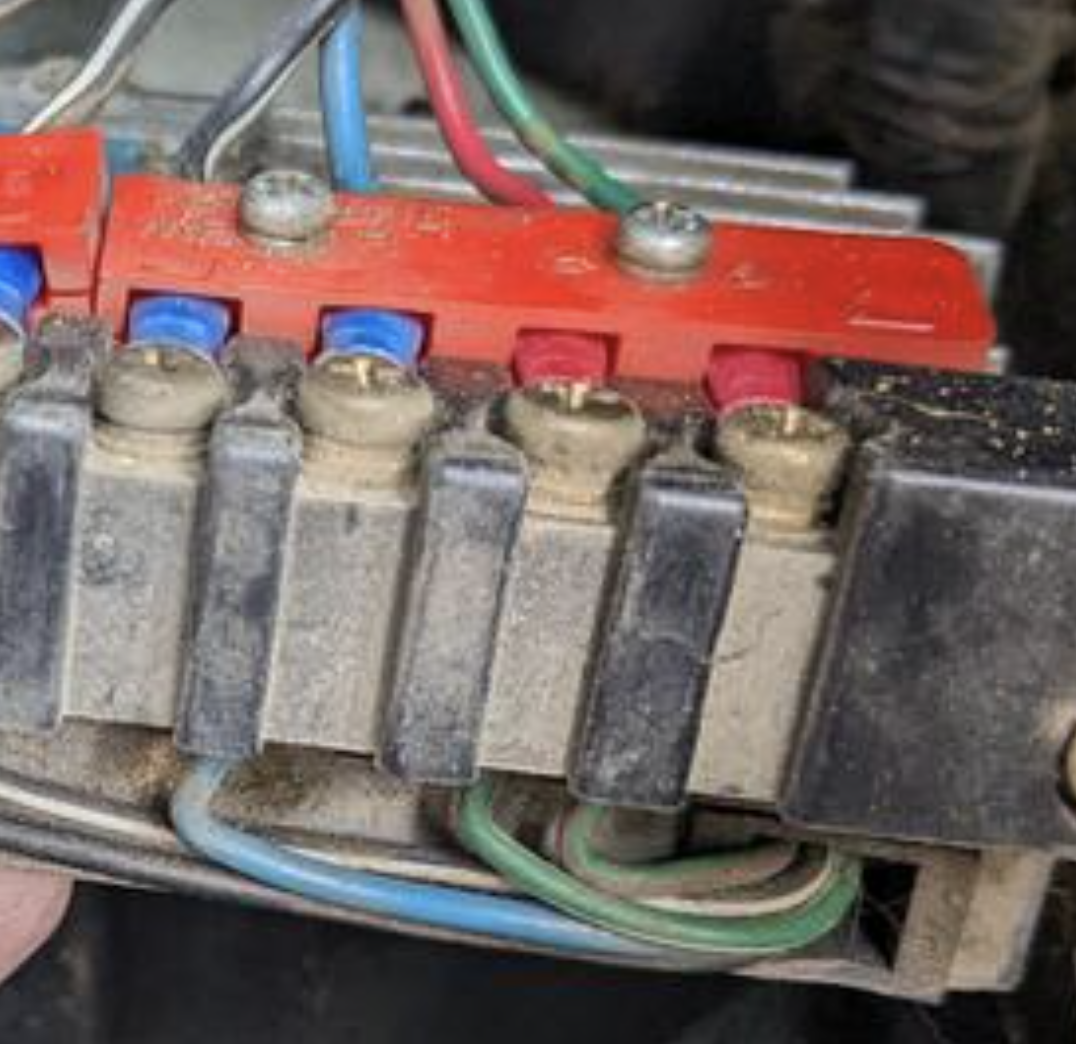

You seem to have it backward.  By the way, maybe you didn't notice but the red wire clamps on your original module have labels also.  G, R, L, BW, BW, B.  L = blue.
I see the G & W on his, I just have no clue what he means by W...
Not sure what you mean by having it backwards though - the Gn wire goes to Green-Red on the module side, the Red goes to Green-White
I am aware of the labeling on the wire retaining strip, I just didn't know if it was a difference between CA market & others, since there was another poster who said he had to reverse the wires compared to the same pic of his with the red on the outside...

11 hours ago, Zed Head said:
G (harness) = Gn-R (module)
R (harness) = Gn-Wh (module)
The W on the module is from GM's labeling.  Might be that GM used a white wire.
In your writing above I thought that you were referring to the GM HEI module not the Nissan module.  Didn't realize you were deep in to the circuit board of the Nissan module, looking at those wires.  Most people just use the diagram or the labels on the wire clamp.
Don't know anything about the other person, but the basic test to see if the wires are connected correctly is to watch your timing light mark afterward.  If it jumps around it's probably backward.  If they're backward it won't hurt anything you just swap them.  There's an accurate edge of the variable reluctor signal and a fuzzy edge.  @Captain Obvious has some old comments about that.

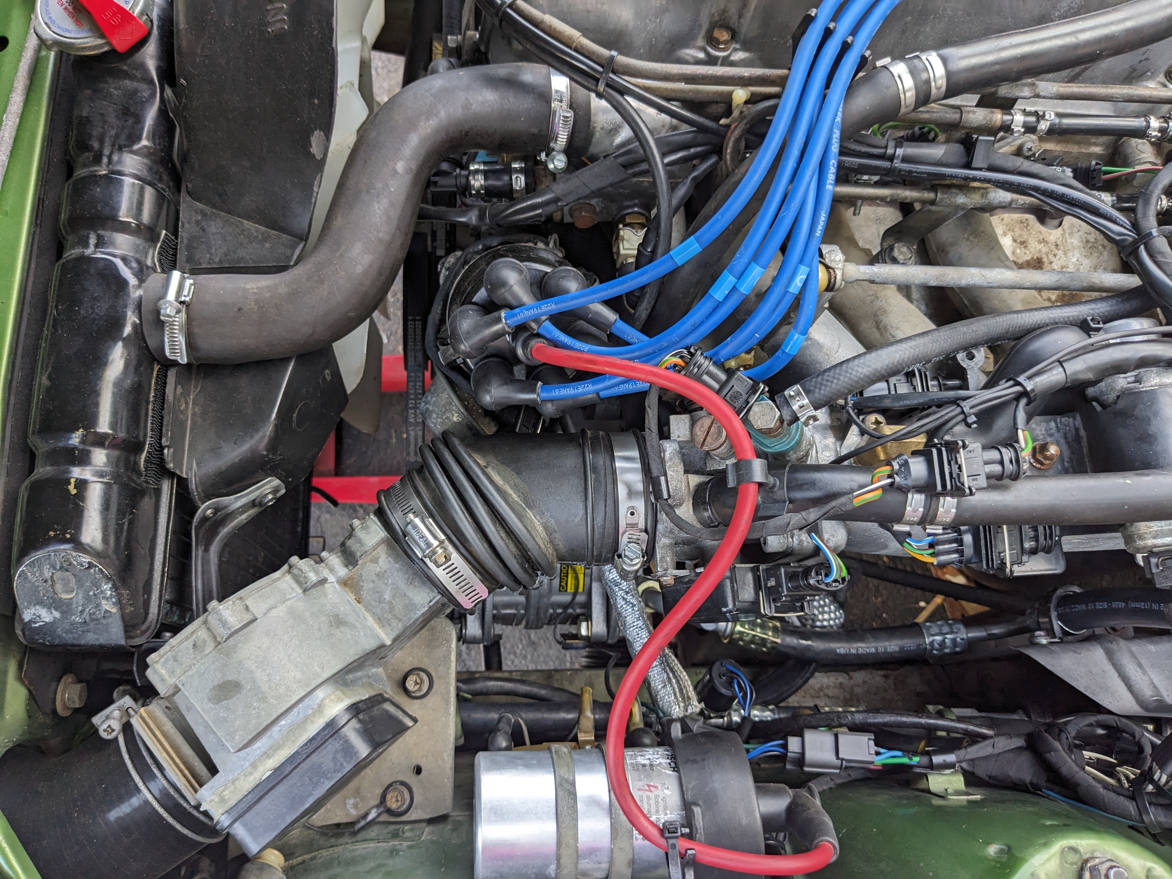

I mounted the HEI module/heat sink  to a bracket I made, that attaches to the side of the stock relay bracket, where the interval relay previously lived. Made it so the assembly is unscrewed from the face, as the bracket screws are otherwise inaccessible. I'll make a sub-harness so that the module can be removed with that attached

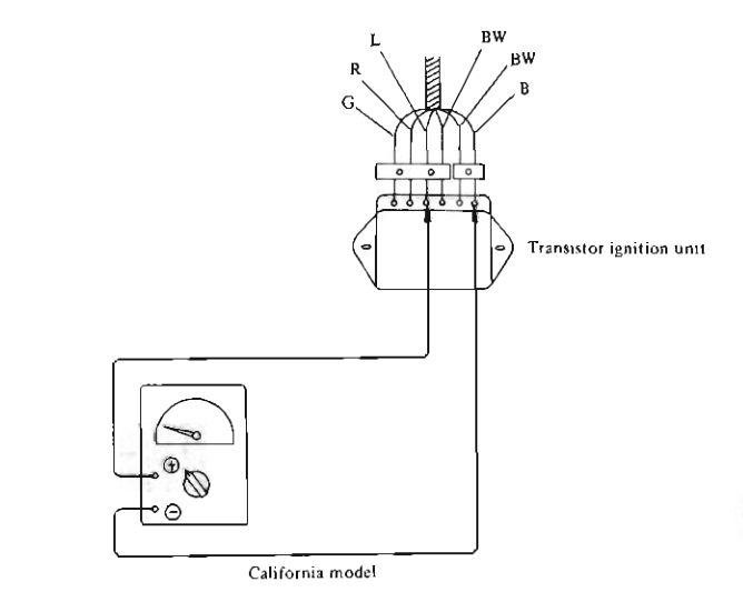

Hi,
I accidently swithed the wires when I quickly connected the TIU for a photo. I noticed it a year or two later, but funny no one else has made a note of it until now. Respect.gif
The wiring for the HEI is correct. Trust me, when I was first testing it would not rev over 2500rpm. That was because I connected the two red - green wires on the TIU backwardsfacepalm.gif
Working from left to right, looking at the TIU with the wires coming out from under the TIU.
B - Black wire: HEI Ground. Very important.
BW - Black/White wire: HEI B (battery)
BW - Black/White wire: Not used.
L - Blue wire: HEI C (Coil trigger "-")
R - Red wire: HEI W (reluctor input)
G - Green wire: HEI G (reluctor input)
You can set up the HEI next to the coil if you want. Just disconnect all the wires from the TIU. You can then use the power to the coil to HEI B and the HEI C terminal can connect to the coil negative. The blue wire on the coil negative will still need to be connected for the tacho to function. Make sure you ground the HEI well.

The FSM's all show Green on the outside.
Here's EuroDat's -
Here's 75 and 77

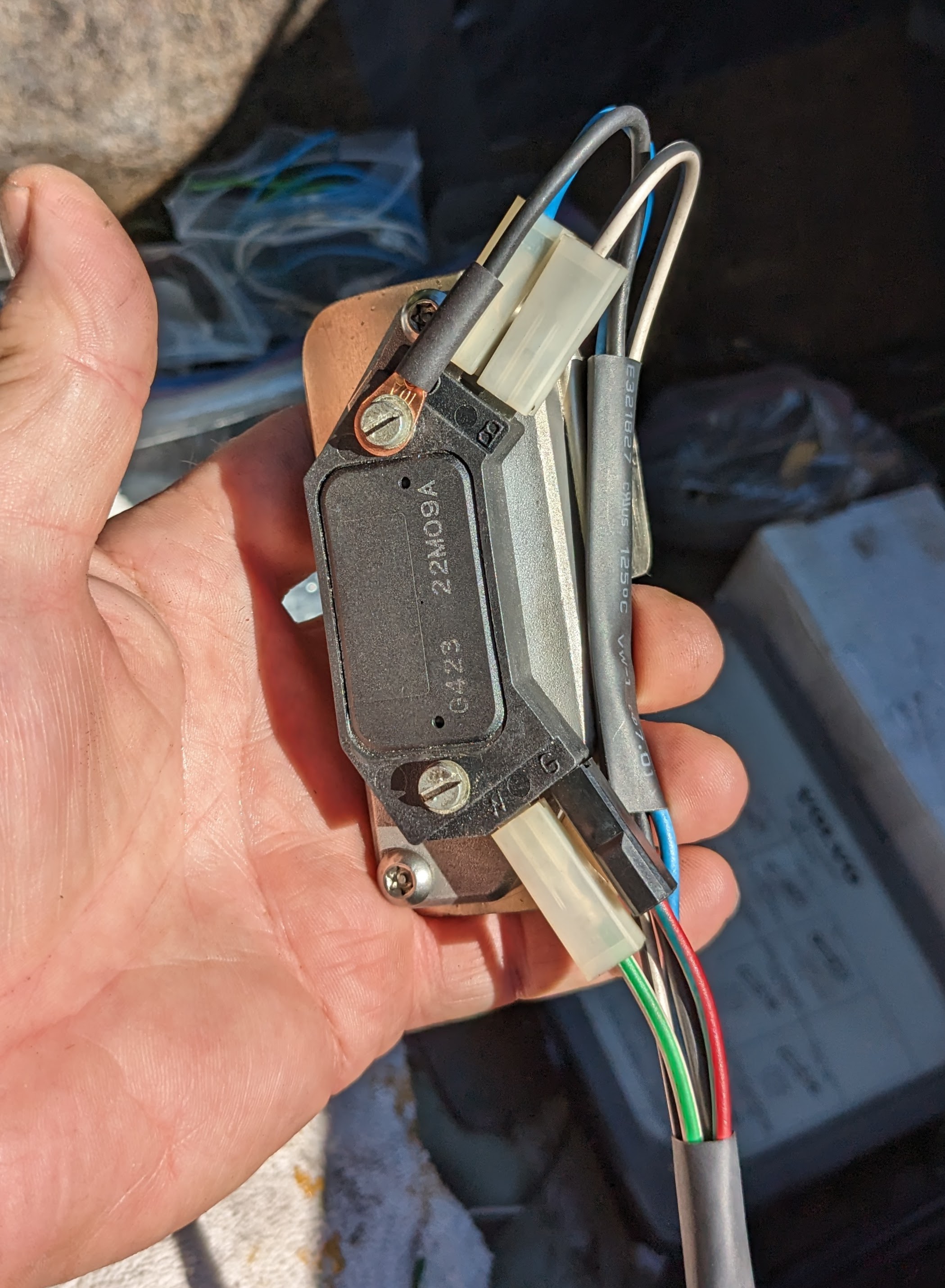

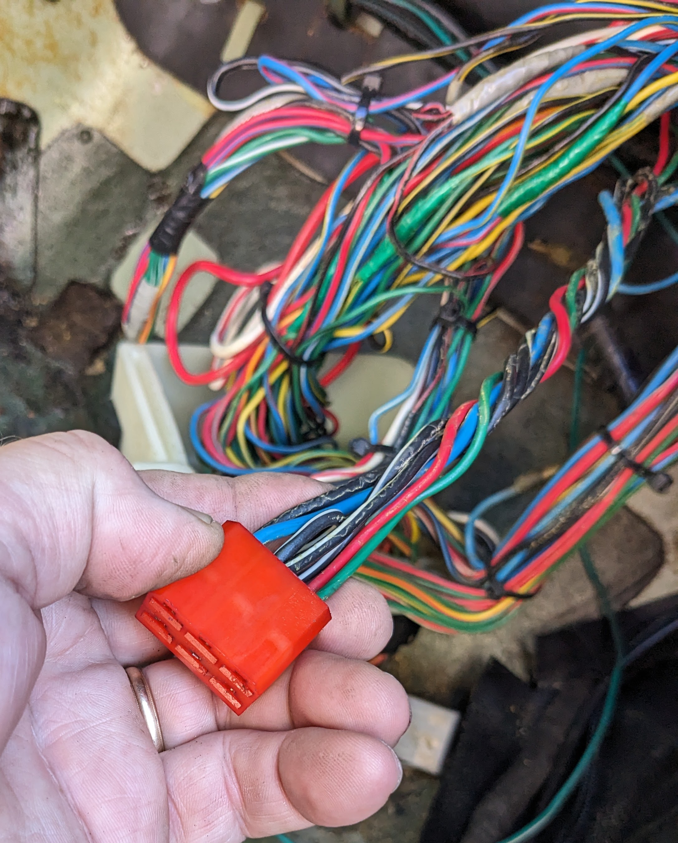

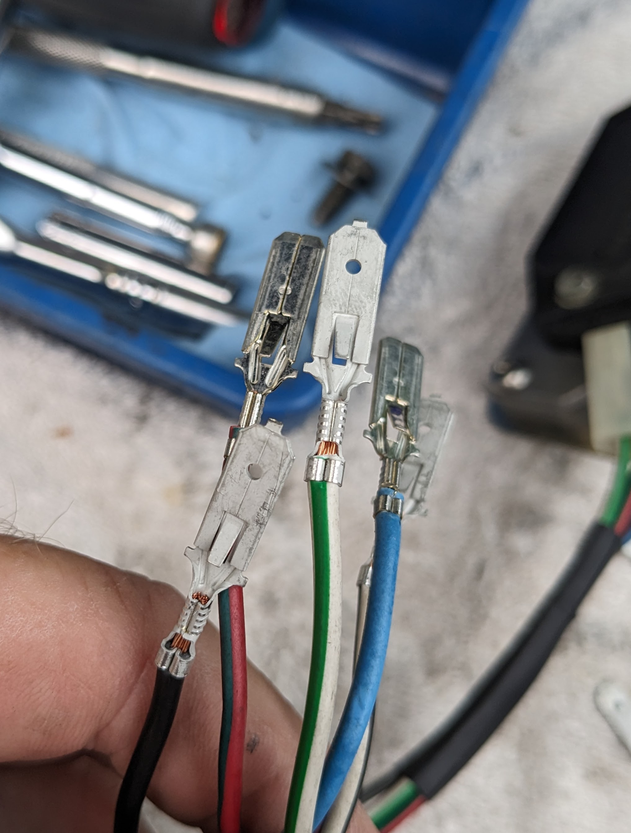

I wired the sub harness for the HEI module today
6.3mm spades for the connection to the factory harness
I made a bridge on the harness side, to connect both Blk-Wh together

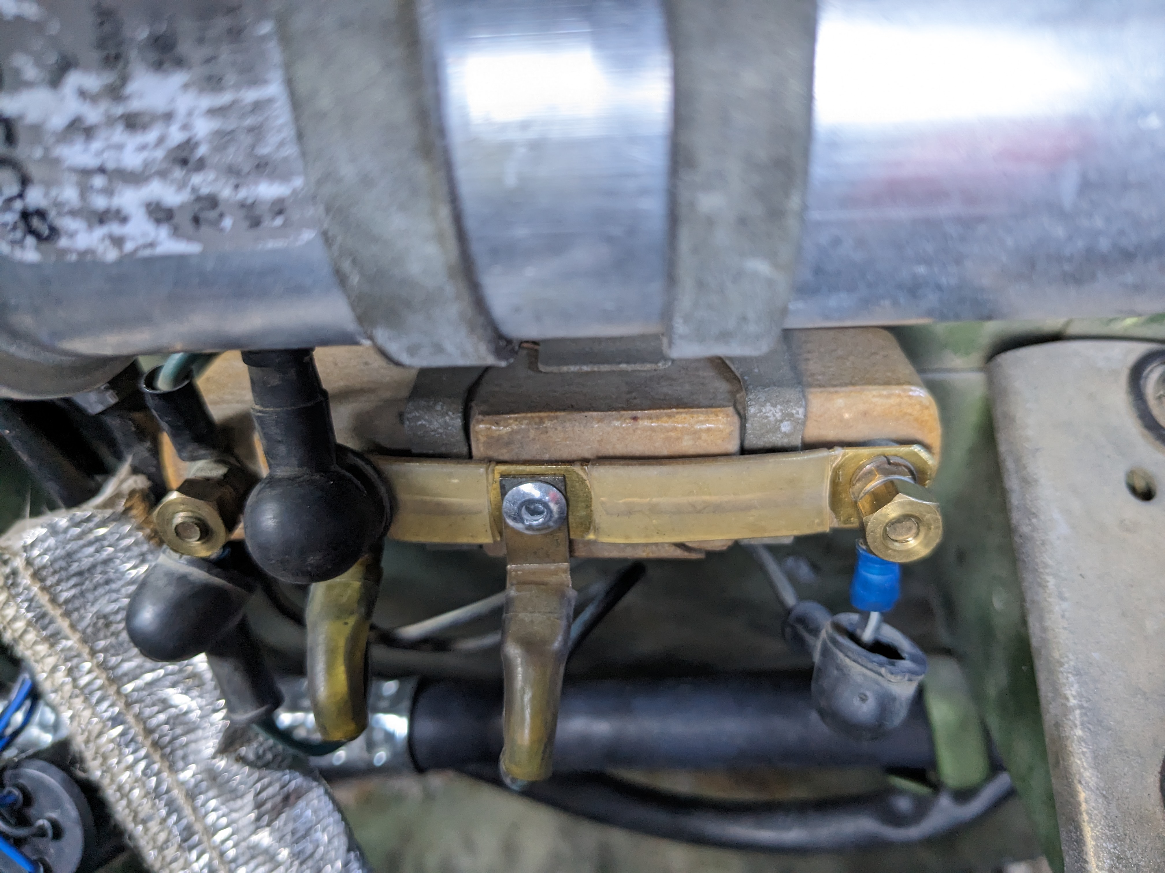

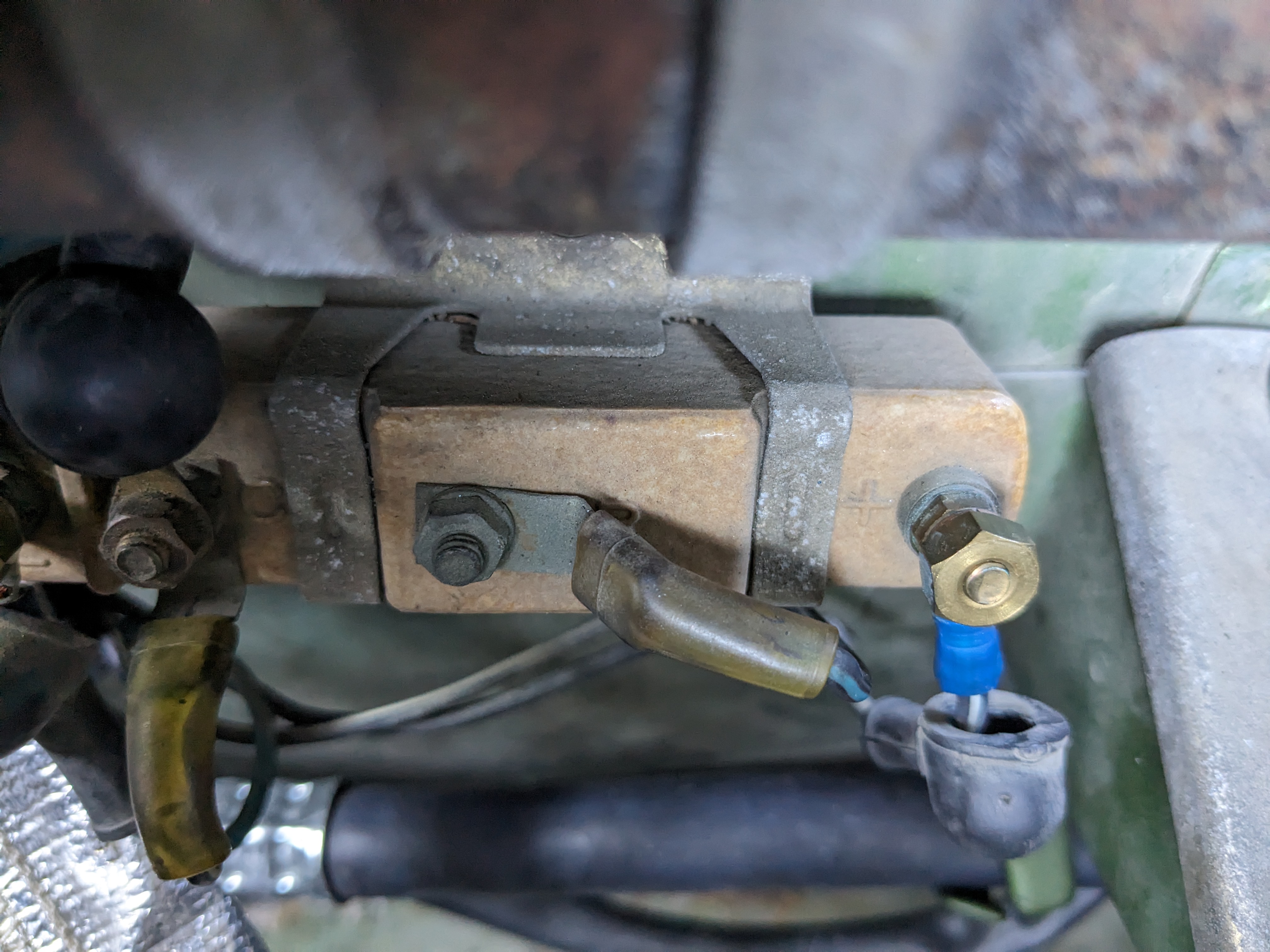

Did the resistor bridge today, and installed the Bosch coil
original
center post snapped off, so I riveted the spade tang to the bridge. Doesn't really matter since the coils gets full battery voltage at any of the connections
