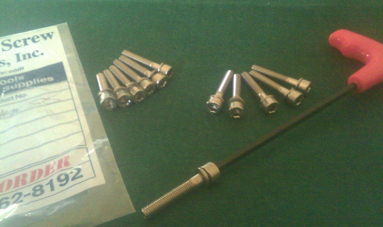

This might help you out on the injector screws.
Go to any big industrial nut and bolt place and ask for .....
Stainless Steel M5 x 30mm metric socket head cap screws & the stainless M5 lock washers (12 needed)
A long 4mm allen wrench is nice to have for them too.
I just purchased some and they were $5.15 for the 12 stainless allen screws and a whopping 45 cents for the 12 lock washers. I don't know what nissan charges but it might be higher.....
