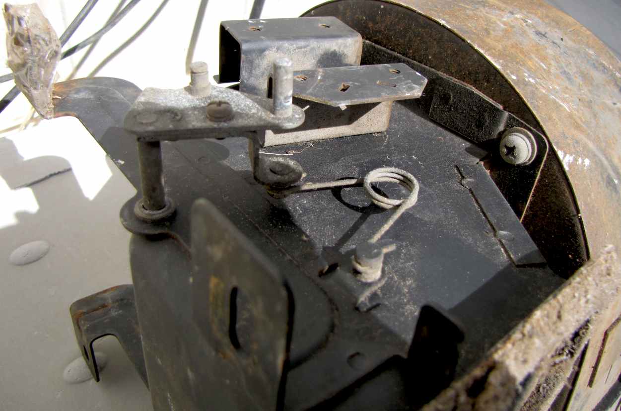

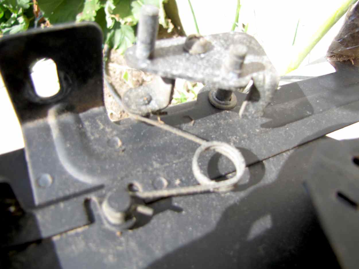

Well, I cleaned up my interior and installed a new dash cap. The problem is... reinstalling the center heat/vent controls. Specifically..
I know the longest cable goes to the fresh air vent flap behind the blower motor... in my infinite wisdom, I didn't take a picture and now cant figure out how it goes back together... simple you say... well I disassembled the "L" shaped bracket and "V" shaped spring, like a dummy. How are they oriented to the pivot? A picture or diagram would be great!

Per your profile you have a
1972 240z? These pictures are from a heater blower from a 1/1972 car:
V spring position 1:
V spring position 2:
