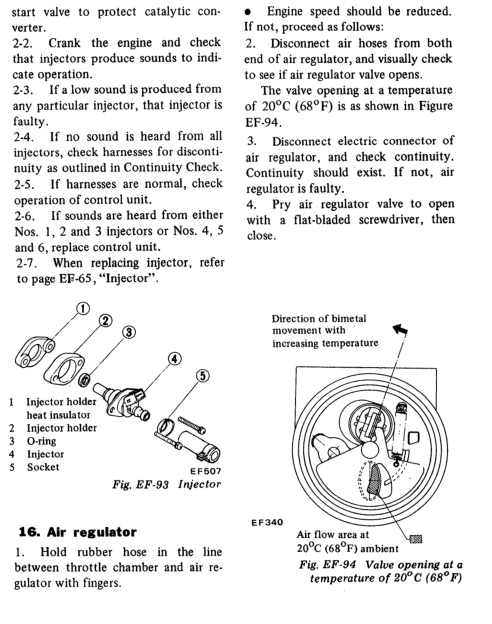

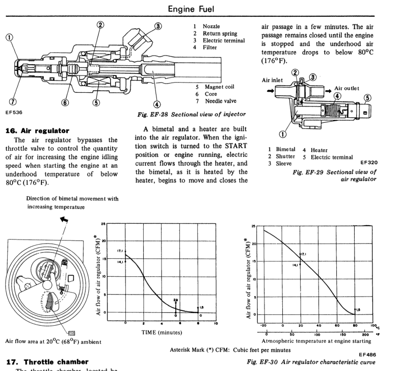

Read up on the Auxiliary Air Regulator (AAR). It is a device designed to increase idle speed when the engine is cold by allowing air past the throttle blade. They get stuck often, there was actually a dealer-installed fix for them, but only if people complained.

There are a threw things that can cause your problem. The thingS that springs to mind is the Cold Start Valve, Thermotime switch and Auxilery air valve (Air regulator).
Do you have a copy of the FSM (Factory Service Manual) and the Supplement aka EFI Bible. Plenty of test you can do to troubleshhot the EFI. Follow link to downloads
