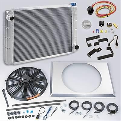

With the aftermarket radiator its doubtful that you will get an OEM shroud from a Z to work. You can try different shrouds from other vehicles but that could be an endless journey. you could make a shroud out of aluminium with little more than a jigsaw and a drill, and it might even look nice if you're careful. This radiator/shroud combo set details what your looking for when you build your own. Notice how the shroud surrounds the fan and radiator:
Fans blow air much better than they suck it, and your engine fan is sucking which is why the shroud helps. This is where you need to play it by ear and see what works for you. Start by replicating a typical OEM setup: Mount the condenser right to the front of the radiator and see if both it and your radiator operate at good temperatures, you might get lucky. If you cant keep things cool you can start getting creative:
You might consider spacers when you mount the condenser in front of the radiator. Putting a gap will allow air to come through the gap instead of forcing all air flow through the condenser and the radiator. The trade-off here is better radiator air flow and less condenser flow. You could also wire an electric fan just for the condenser that only engages when you activate the AC. Lots (maybe all?) of modern vehicles with electric fans actually do force the fans on when the AC is engaged regardless of engine temp to cool the condenser.
You car should idle without fail all the time even in horrible conditions. If you car doesnt you should start there. The easy way to do things is to increase your idle from say 750 rpm up to about 900 rpm during the summer, or whatever you car idles at nicely with the AC engaged. If you want to get fancy you can build in an idle air control valve to automatically adjust your idle when the AC is engaged. Thats sort of a separate topic and you shouldn't attempt it until you have a functioning AC system
