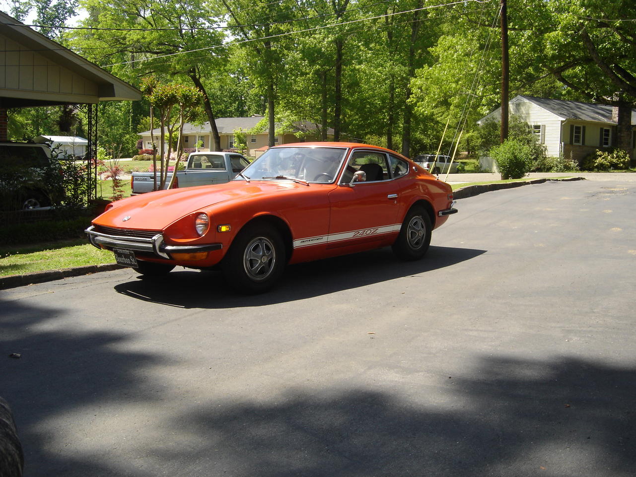

Here's #110 original paint, that one on E-bay looks more pinkish to me.
I had heard the same about the triples but thought it was a performance upgrade given how often you see/hear about them.
I like the original paint color better as well.
