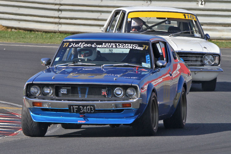

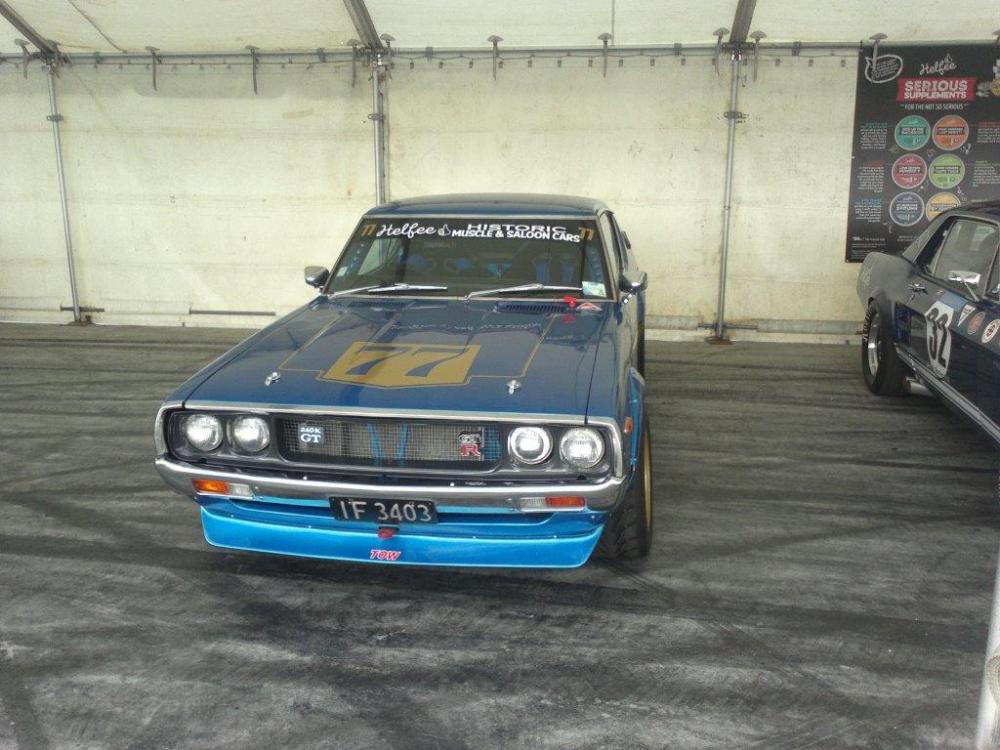

Well car ran flawlessly at the 2016 NZ Festival of Motor racing at Hampton Downs (except for a slight incident with a not quite tight radiator cap) , sorry no videos but here are some pics.
Our new brand Helfee- Serious supplements for the not so serious - was the class sponsor (shameless self promotion http://www.helfee.co.nz), but thought I better get a photo with the Pirelli girls too.

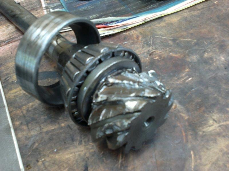

 Seems that we might have strained the old diff.  I had put a new Quaife LSD in it but left the original crown and pinion.  Well last race of the day.  We were doing handicap standing start.  I got beaten off the line by a dirty of Capri, but then the race was red flagged so we started all over again.  MIght have given it a bit more power of the line doing the launch as it made horrible noise and I quickly pulled over and it was making more horrible noises.  Thought I had snapped a wheel stubb again, but no that was not it.
 Yup those bits should be somewhere else
 Hmmm that looks a bit munted
 Well even I know that dont look right
 So we fitted the crown and pinion out of a Subaru R180 diff (quite a rare version out of 300hp Imprezza I think) - its a 4.44 ratio and much stronger.  We had to make a thin spacer plate and use the larger bolts, but other than that pretty much a straight swap.  The good news was that the Quaife LSD was sweet.  But they have a lifetime guarantee supposedly so must be pretty strong.

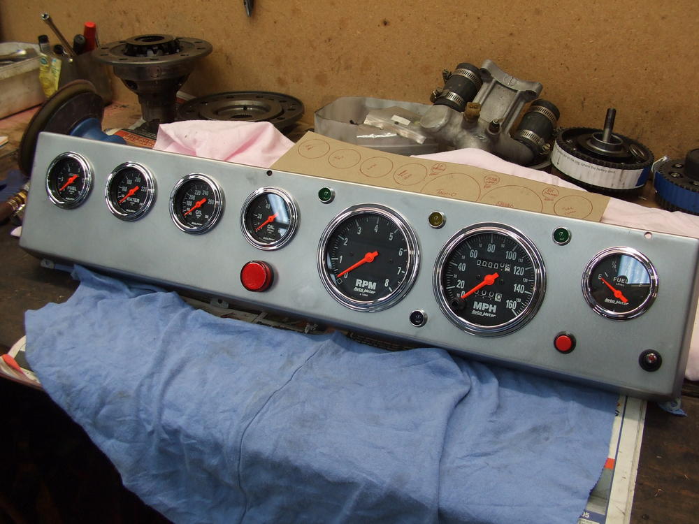

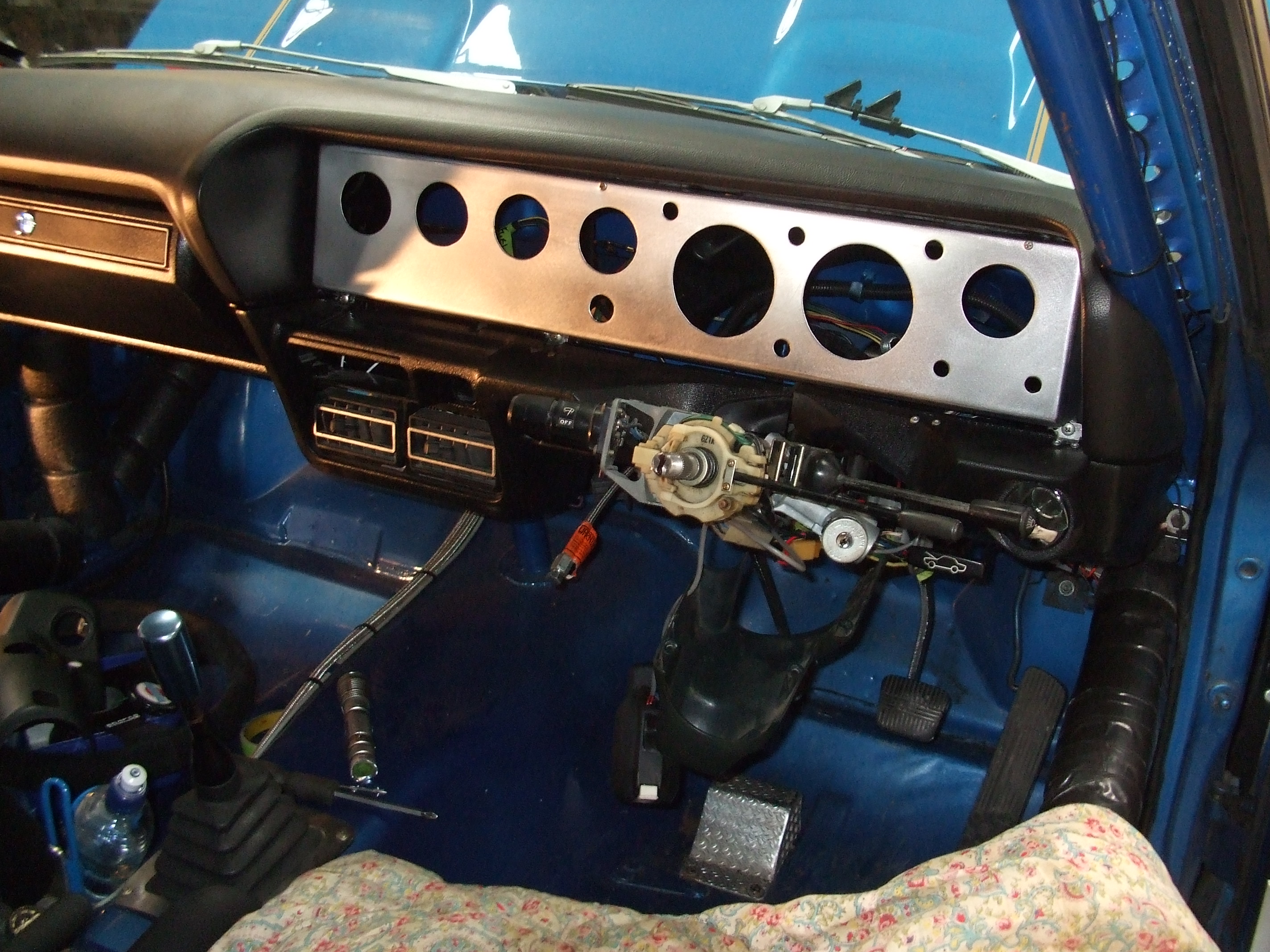

well actually next job is a few gauges - will post that shortly when finished.
