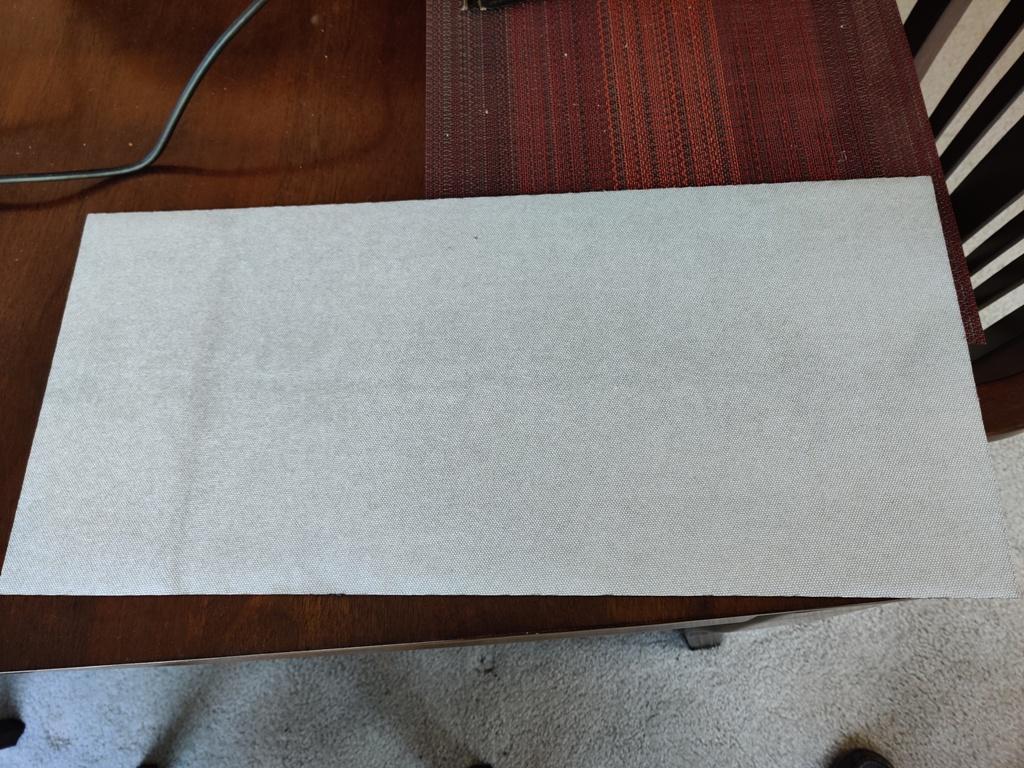

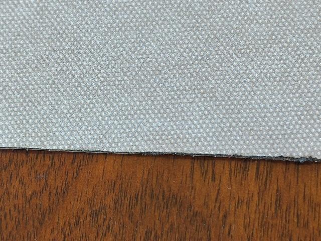

G5930-89902 is discontinued.  And though I was able to buy G5930-89904, it appears to be about .060" in thickness, and what I took out of my 1971 from the tunnel (floor "mat" was already gone) is about .090".  Package shelf appears to be about .090" as well.  It would be nice to confirm original thickness of the pieces for the floor and the tunnel, as well as the rear deck, for US cars that had them. For the record, I measure my 6/1971 tunnel pieces at about .090".  I will measure the package shelf piece and edit this post to include that information.
Edit - 5/9/2020:
The original package shelf sound deadening material is also about .090" (Same as tunnel).  I bought a pack of the Wurth sound deadening mat and unfortunately they have improved the product.  It now has cloth on the upper surface which is white/silver to my eye.  It no longer looks black like the original Datsun stuff.
