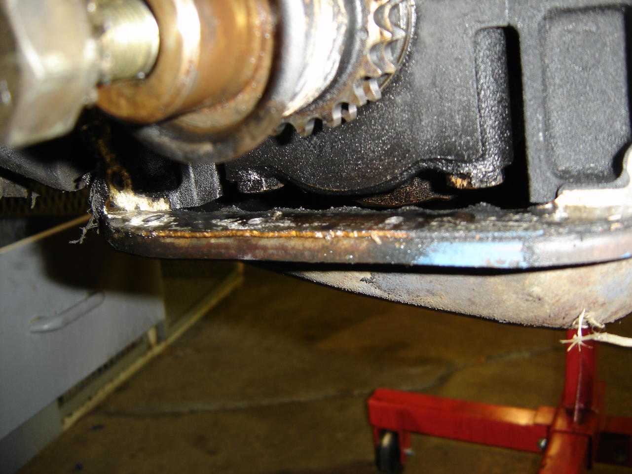

d) Adjusting the rotational position of the crankshaft might buy you that last bit of clearance needed to get the pan out (or back in).

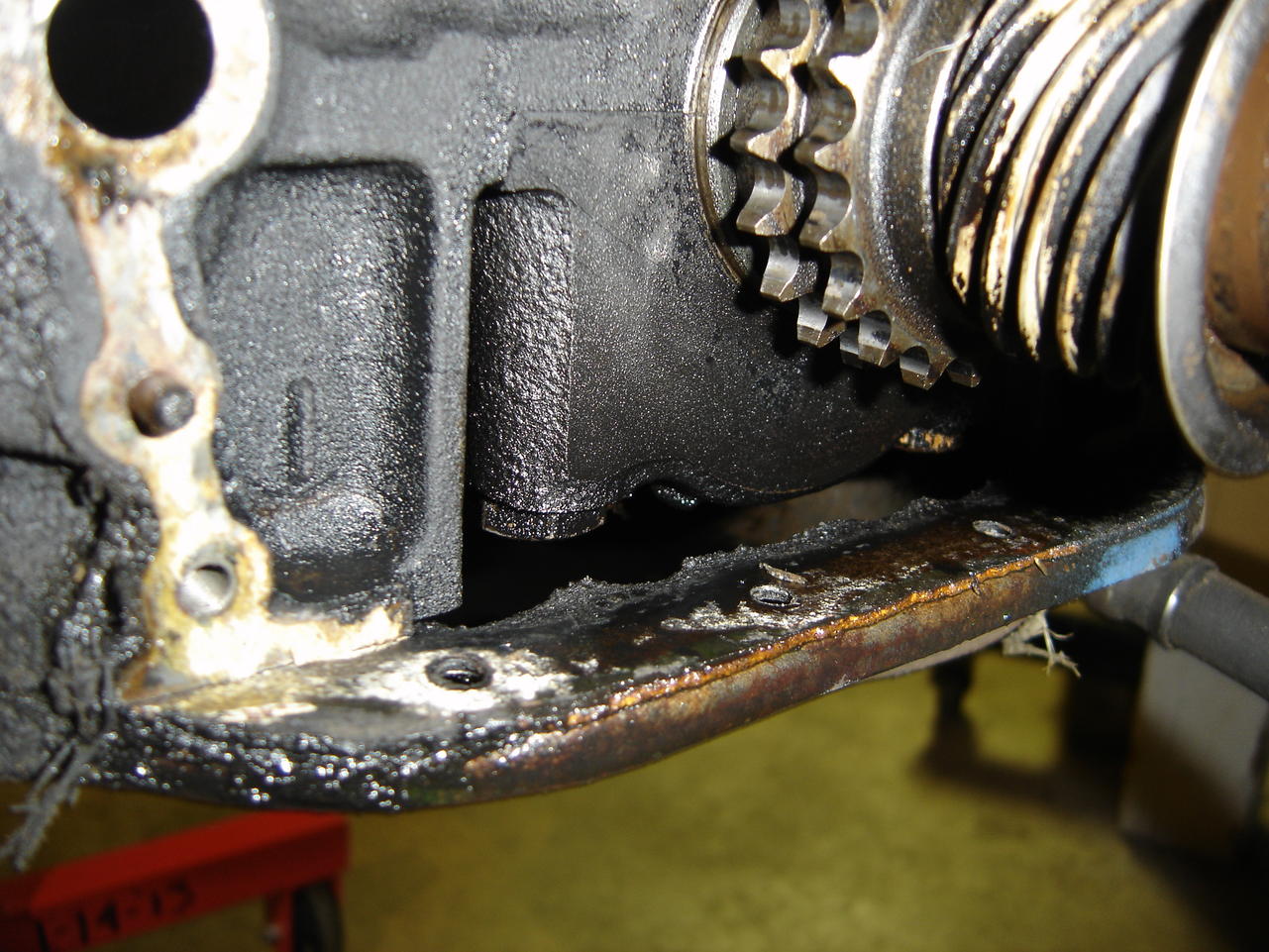

Once you've got the pan off (and located that pesky tensioner shoe and spring), check the pan's mounting flange for bending and/or dimpling at the bolt holes. Make sure the flange is flat and clean before you attempt the re-install.

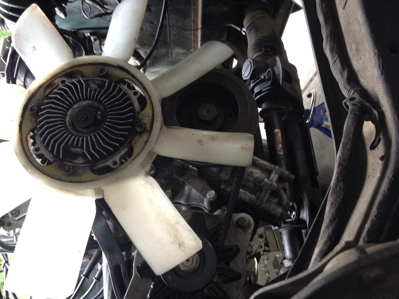

The fan shroud on the radiator gets in the way if you move the engine more than 1/2" or more. I had to unbolt the shroud.

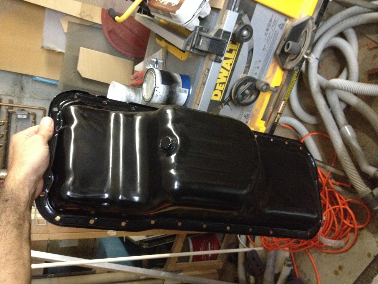

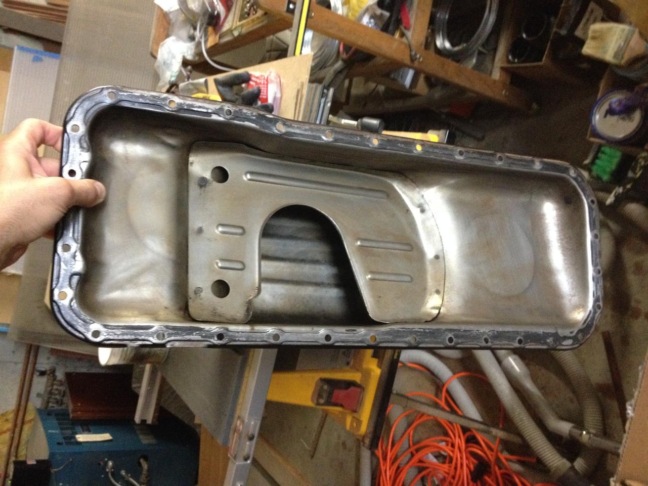

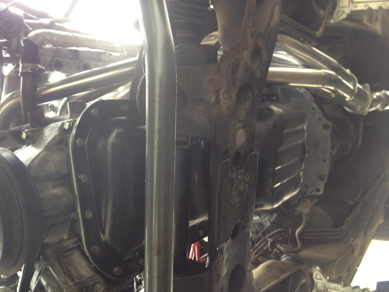

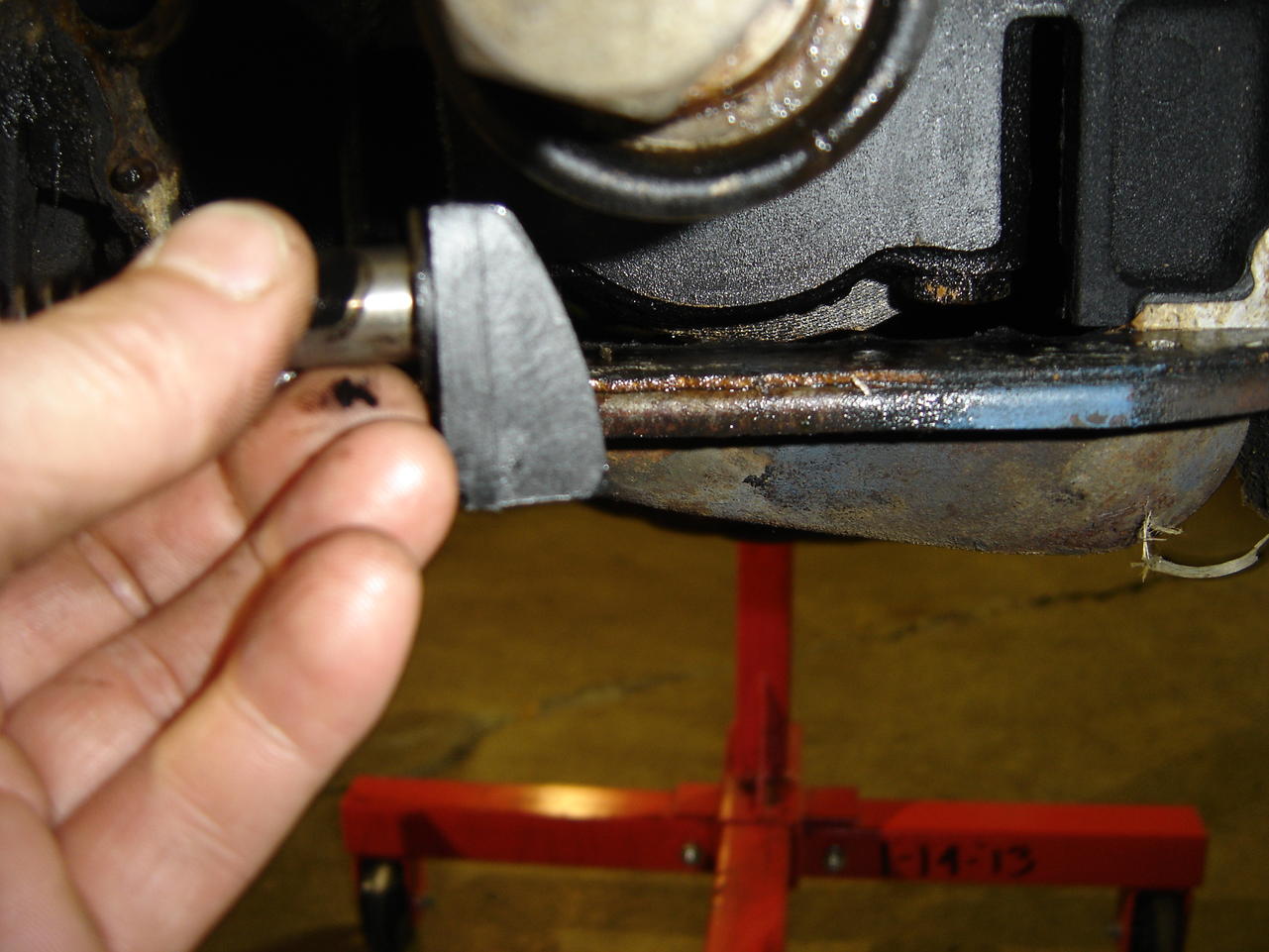

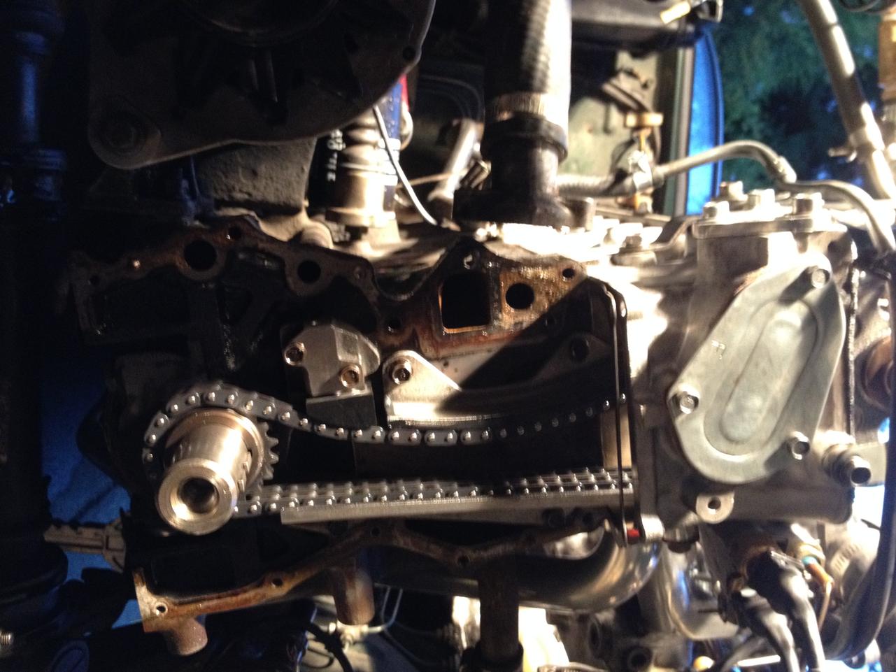

i pulled the oil pan first, but neither the chain tensioner nor any ground-up bits were in there. cleaned it up, hammered out all the dimples in the flange from the PO trying to stop a leak by cranking everything down too tight, gave it a new paint job and a new gasket. when i finally got the timing cover off, i found the chain tensioner broken in half (the head sheared off the plunger shaft) and the spring down in the bottom below the crank sprocket. took me a while to find the plunger shaft - it was hidden in a casting hollow in the block. amazingly lucky that those parts didn't get sucked into moving gears - no damage whatsoever to be seen!!

  • the oil pan comes off without lifting the engine or removing the pickup - just jiggle and you're good

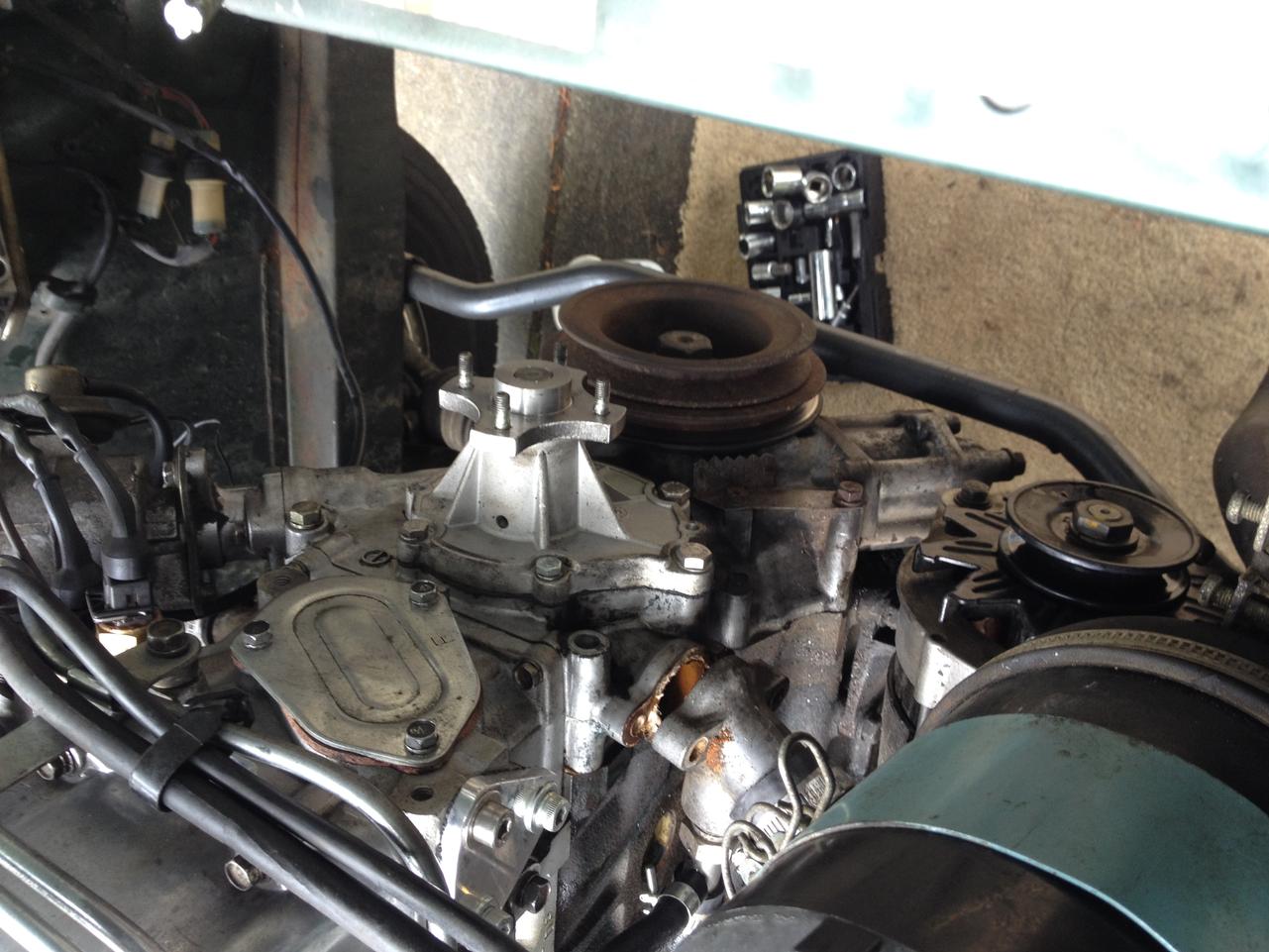

  • removng radiator makes a huge difference

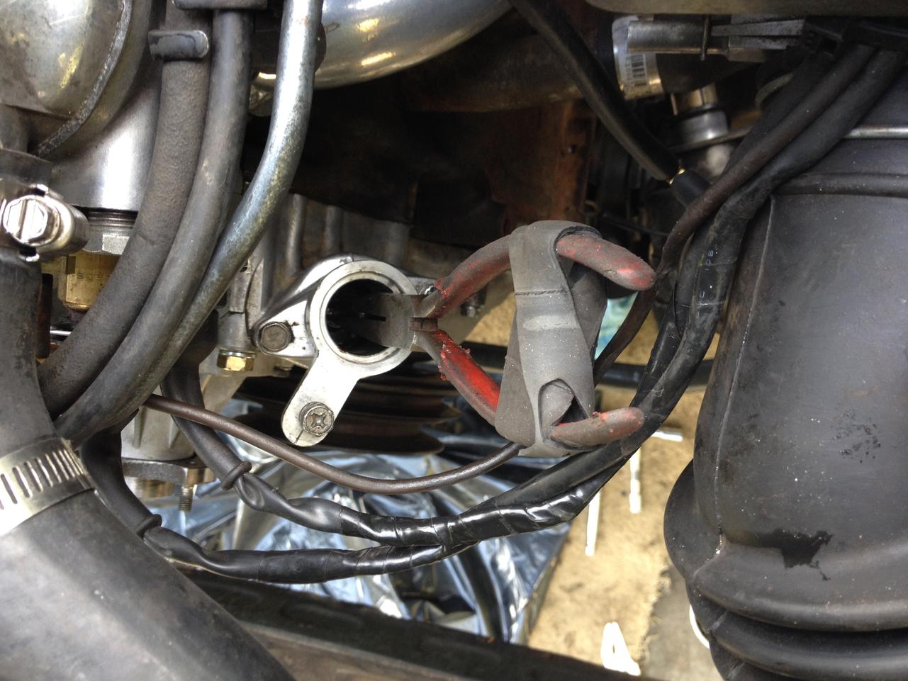

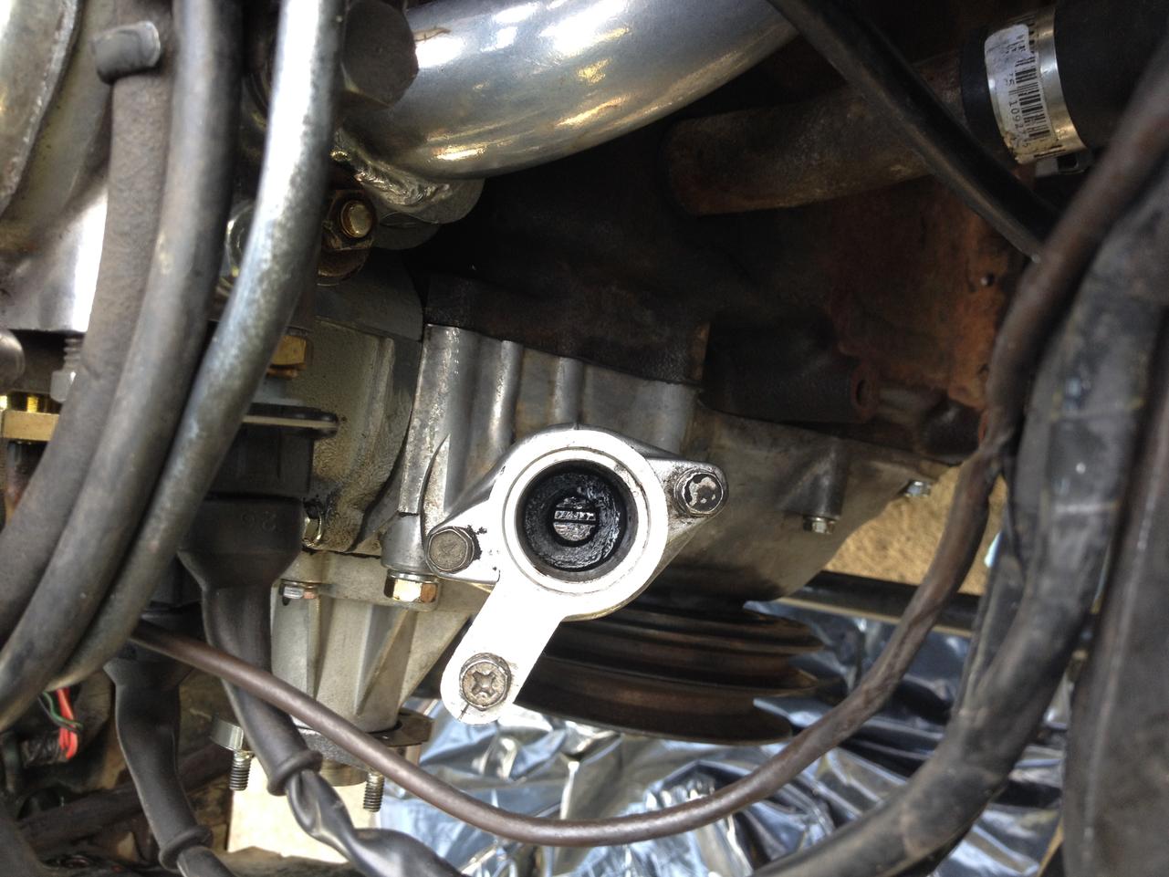

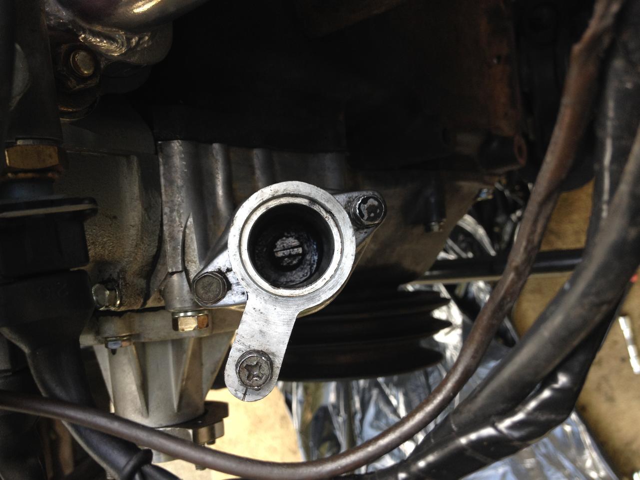

the biggie was getting the dizzy shaft timed - a bit of a PITA if you have to install the pump, crawl out from under the car, look in the dizzy adaptor to see how far off the paddle is, crawl back under, adjust and repeat. so i wadded up a paper towel in behind the shaft from below, and used a piece of the old rubber oil pan gasket bridged between a couple bolts in the oil pump mounting surface to act as a stretchy sling under the shaft. then from above, i used a pair of needle nose pliers to push the shaft down, stretching the rubber sling until it cleared the drive gear on the crank, then moved it a tooth and it sprung back up into position - voila! a simple way to move it one tooth at a time until it's in the right position. then i wrapped my pliers with a strip of rubber (from an old motorcycle inner tube i've cut up and keep on hand - very useful material) to make an improvised needlenose clamp, locked it onto the paddle up top to keep the shaft from falling down and was able to pull out the paper towel and mount the oil pump up underneath. of course i put the whole thing together with the paddle 180 degrees out the first time... but it was easy to re-do it.

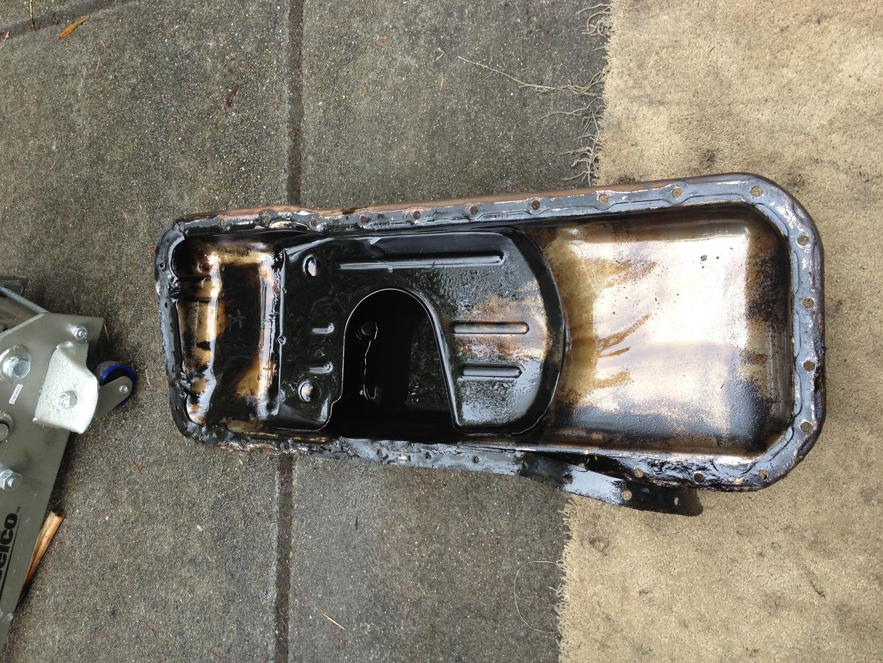

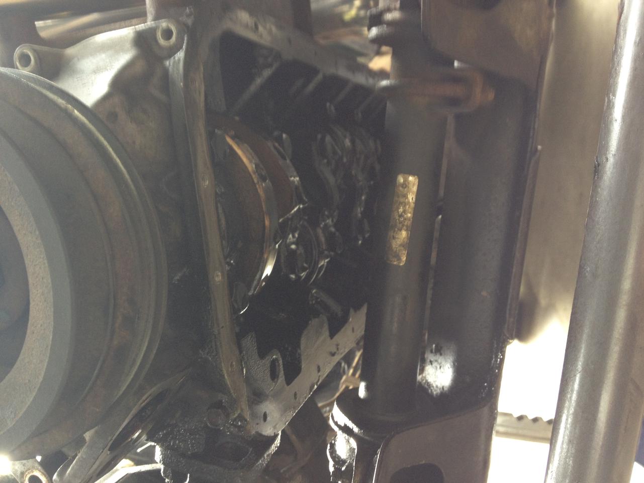

oil pan off
nothing in it... other than sludge

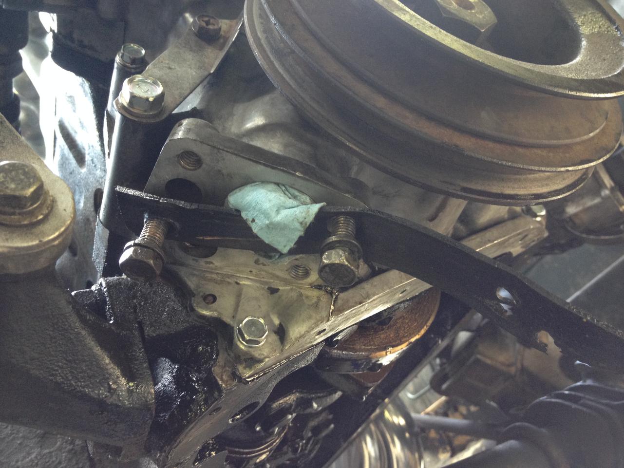

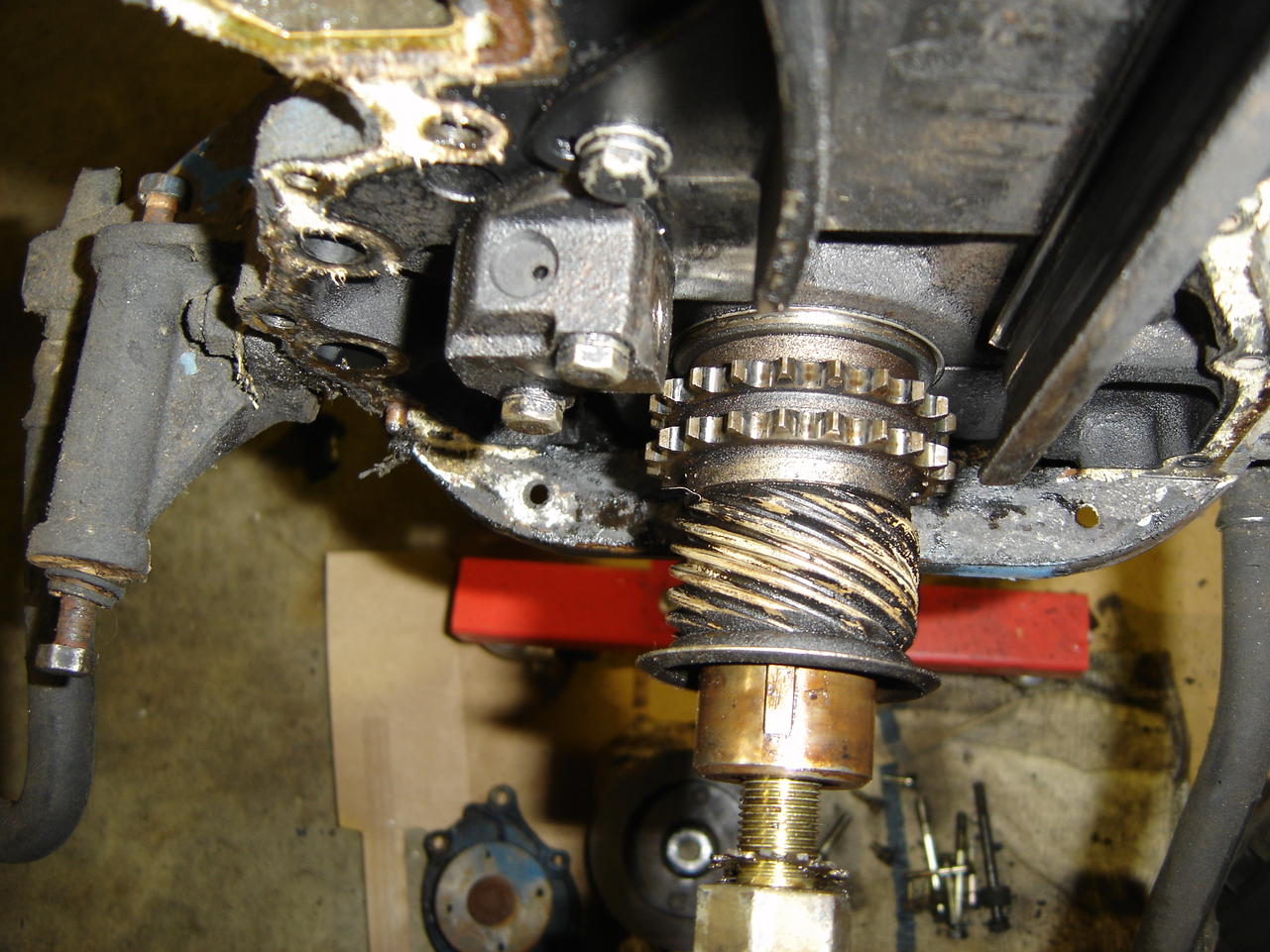

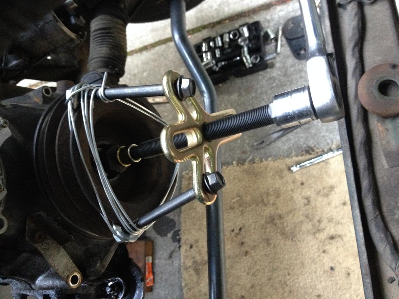

improvised puller setup (nuts, washers, bailing wire) did the trick

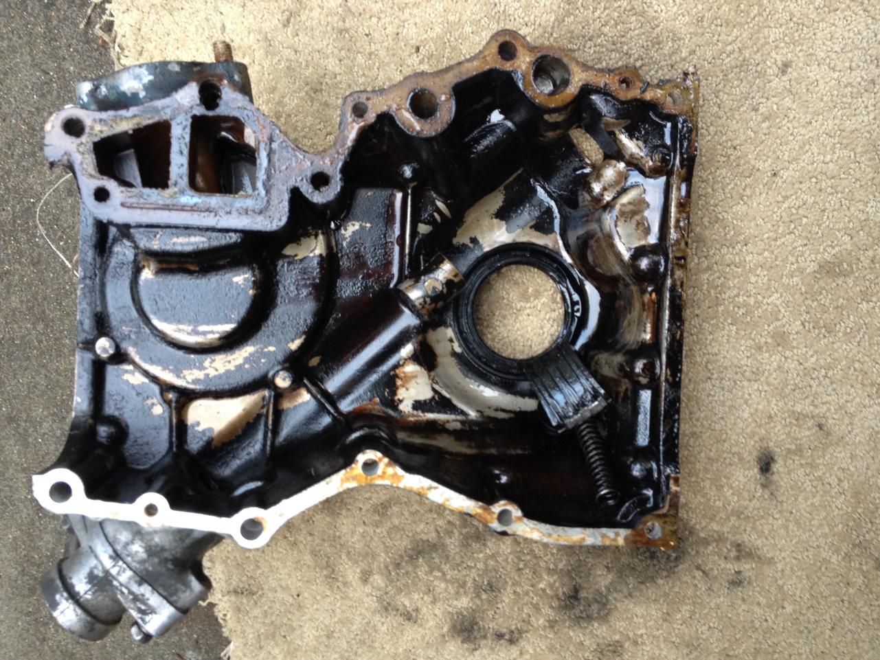

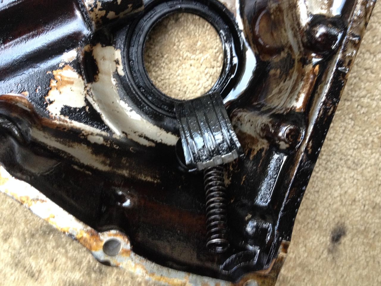

cover off - goodies inside
tensioner was worn anyway

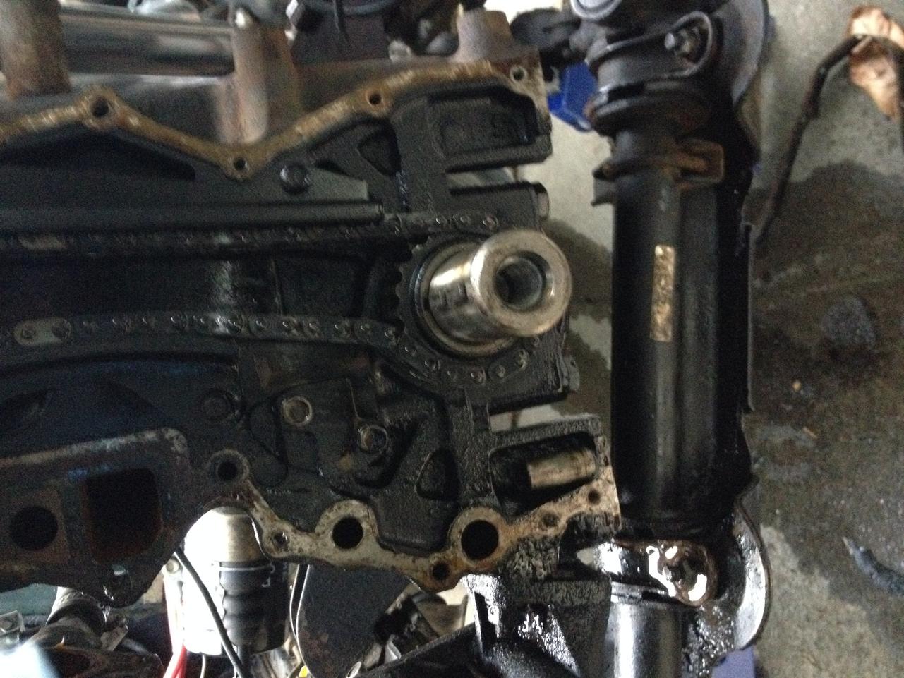

find waldo - can you see where the tensioner plunger was hiding?
pan all clean
new paint

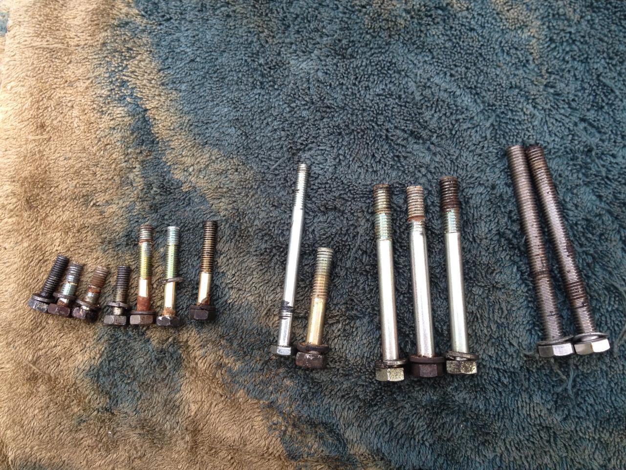

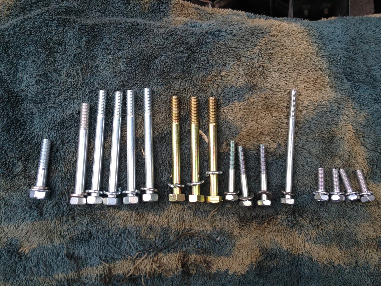

old bolts vs. new set

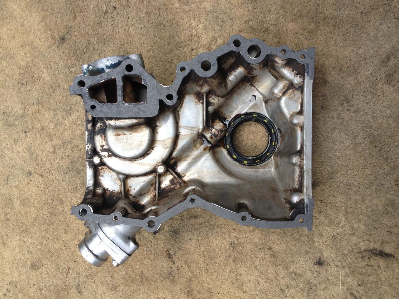

cover all cleaned up, new seal & gaskets
new parts installed
holding dizzy shaft in place
holding paddle from up top
paddle 180 degrees out - it's offset so it makes a difference...
refreshed pan in place

2 questions.....1) Did you make sure you were on TDC (compression stroke, not exhaust stroke) before installing distributor drive shaft? 2) How did you make sure that the bottom tang of the distributor drive shaft fit into the oil pump correctly? If it didn't engage properly, you'll have no oil pressure.
