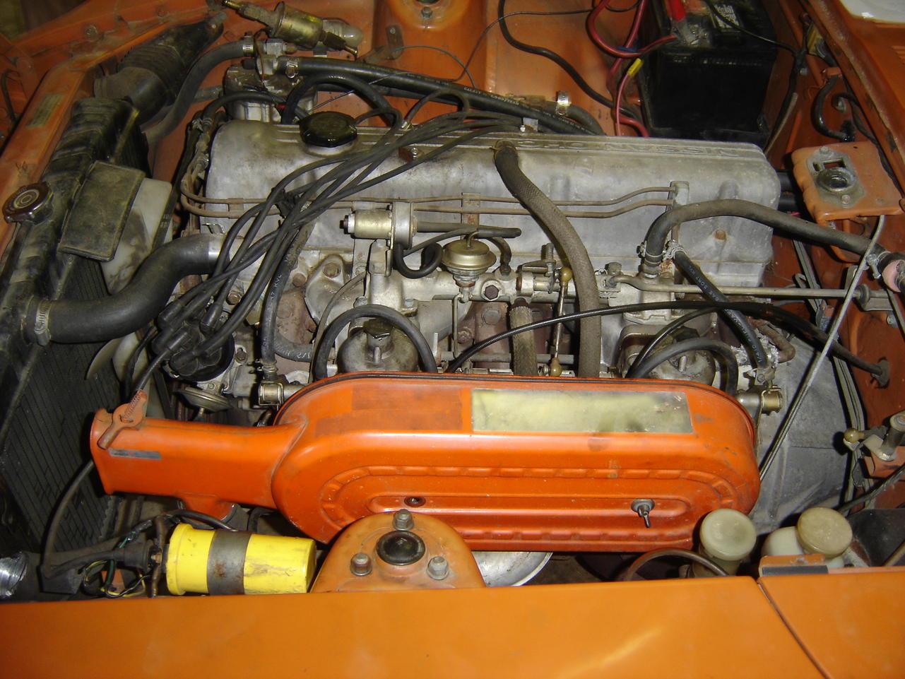

Use the upper middle adjustment on the throttle rod to raise or lower the rpms. When I first started fooling with mine I mistakenly adjusted the ones on each carb. Another thing I didn't know about the 240s were the pulley marks are different than my 280. The bottom one is TDC, then 5 degrees as it goes up. I'm sure your pulley is in better shape than mine but if it's kinda rusty/dirty sand it a little and put some kind of paint in the notches, White Out works good. http://www.classiczcars.com/forums/help-me/49908-distributor-question-issues.html. Post #4 & 5
It's the one by the top plastic marble to the left of the valve cover hose in this picture.
I think the suggested rpm when you balance the carbs is 650, that's with the linkage disconnected.

I beg to differ about idle adjustment. The top center idle adjust is used only during the high-RPM (3K or so) carb balance check after setting idle RPM and balance using the idle screws on the individual carbs and inter-acting linkage.
It does make it tougher to set your idle when that's all you want to do, as adjusting each carb's idle also affects balance. Whatever works for you though.
And I see 750 RPM @ 5 deg as the idle spec in the '72 FSM for USA and Canada spec cars.
