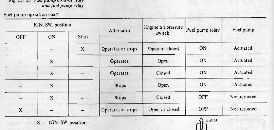

If I recall correctly, you get about 5 sec of fuel pump operation when you turn the key to "start." Thereafter, you don't get more fuel until the engine actually runs. For the '78, a running state is detected when you have EITHER alternator output OR oil pressure (or both). Your oil sender being unplugged would eliminate the oil pressure detection. That leaves the alternator, which wouldn't be putting out much while you're cranking. So I bet you have no fuel.
FastWoman described the pressure switch and alternator pump control. Those are both bypassed during starting though, powering the pump directly. On my 76 when the AFM contact stopped working, the engine would start, run for about three seconds, then die. It would do that over and over.
With a low battery the alternator powered relay may not be getting enough juice to keep the fuel pump operating. And a dry engine may not be generating pressure right away even with the switch intact.
Collecting all of the facts, if it were mine, I would get a good, charged battery in there, pull the small vacuum line that feeds the AC control bottle (the tiny nipple on top of the intake manifold), and squirt some starting fluid in to the manifold. Ideally, you would have a friend either running the can of fluid or the key, and just keep the engine running long enough to get things moving.
If that didn't work, I would probably short the fuel pump relay to keep the fuel pump on. Actually I would probably do that first, just to take the fuel pump control out of the picture. That's a little more involved though.
This leaving and coming back to the problem really kills the flow, just on the internet. Must be way worse trying to do it on the car.
i'm no electrical savant, but i'm pretty sure the oil pressure sensor works opposite to the previous posts... unless mine is somehow wonky. unplugged would be infinite resistance, right?
on my 78 pulling the oil pressure sender plug when the key is on and the engine is NOT running is a quick way to run the fuel pump. it's how i used to prime my fuel rail when dealing with hot start issues. just turn the key to "on", pull the plug on the oil pressure sender and the pump would run until it was plugged back in. at one point i was going to put a momentary disconnect push-button inside so i could run the pump without getting out of the car.
quite handy, actually...
That's a good catch. So take the plug off, clean it up so it's an open circuit, then leave the plug off and try to start the engine. Much easier than shorting the relay. You've uncomplicated things.
I've actually cut the FSM section out on that before but forgot about it.
