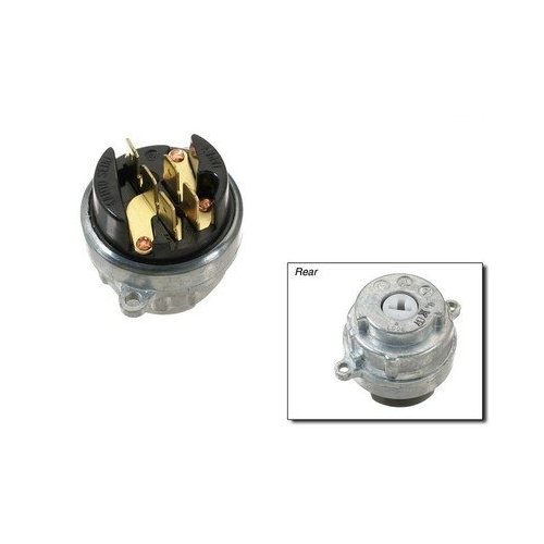

The interim trick to get out of trouble is to only turn the key ~ 90% of the way to full-stop when cranking.
The underlying problem is that the contact for the ignition in the ignition switch is not making (probably due to carbon or corrosion) however the contact for the starter in the ignition switch is making....thus you get the starter but not the spark. If you only turn enough so that both contacts are making and avoid the carbon patch, it will both crank and spark.
The fix is to change the ignition switch or to really douse it with contact cleaner.
Here is the required replacement part:
Edited by Blue
Well it looks like I spoke too soon, new ignition looks to have failed on me after trying it for the second time today, accessories are on but no cranking and I plugged the factory one back in to check and it started with that. I also had taken the module off the back of the factory ignition too have a look inside but bolted it back together after needing it again and now it works like normal.
I was keeping my mouth shut (fingers off the keyboard?) until I was fairly sure. I think the switch you bought is for a ZX. I'm not completely sure about the cross compatibility. I have one sitting around at home along with a Beck-Arnley S30 style switch (Amazon.com: Beck Arnley 201-1179 Key, Lock And Ignition Switch Assembly: Automotive). I haven't tested the style you put in your Z, but I know the Beck-Arnley part works fine since I have it in my 260Z.
Thats dissapointing if thats the case steve as I asked if it was plug and play for a 240z before I bought it, I have contacted the seller about a replacement just waiting to see who pays postage though.
I see the back of those modules look different to mine as well, they have two screws on the module whereas mine has one (71 240z) and the size of my module is a lot smaller on the back.
