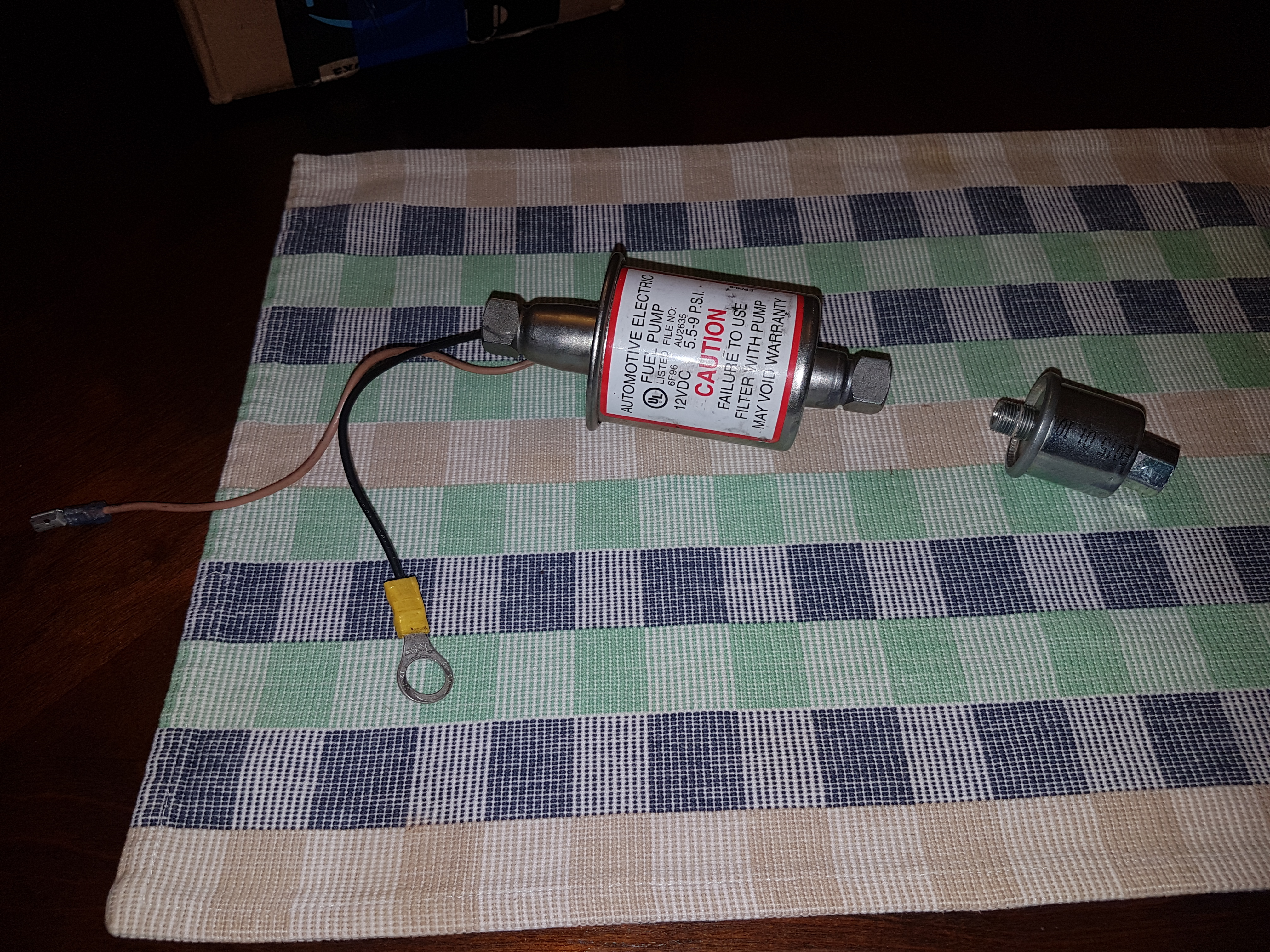

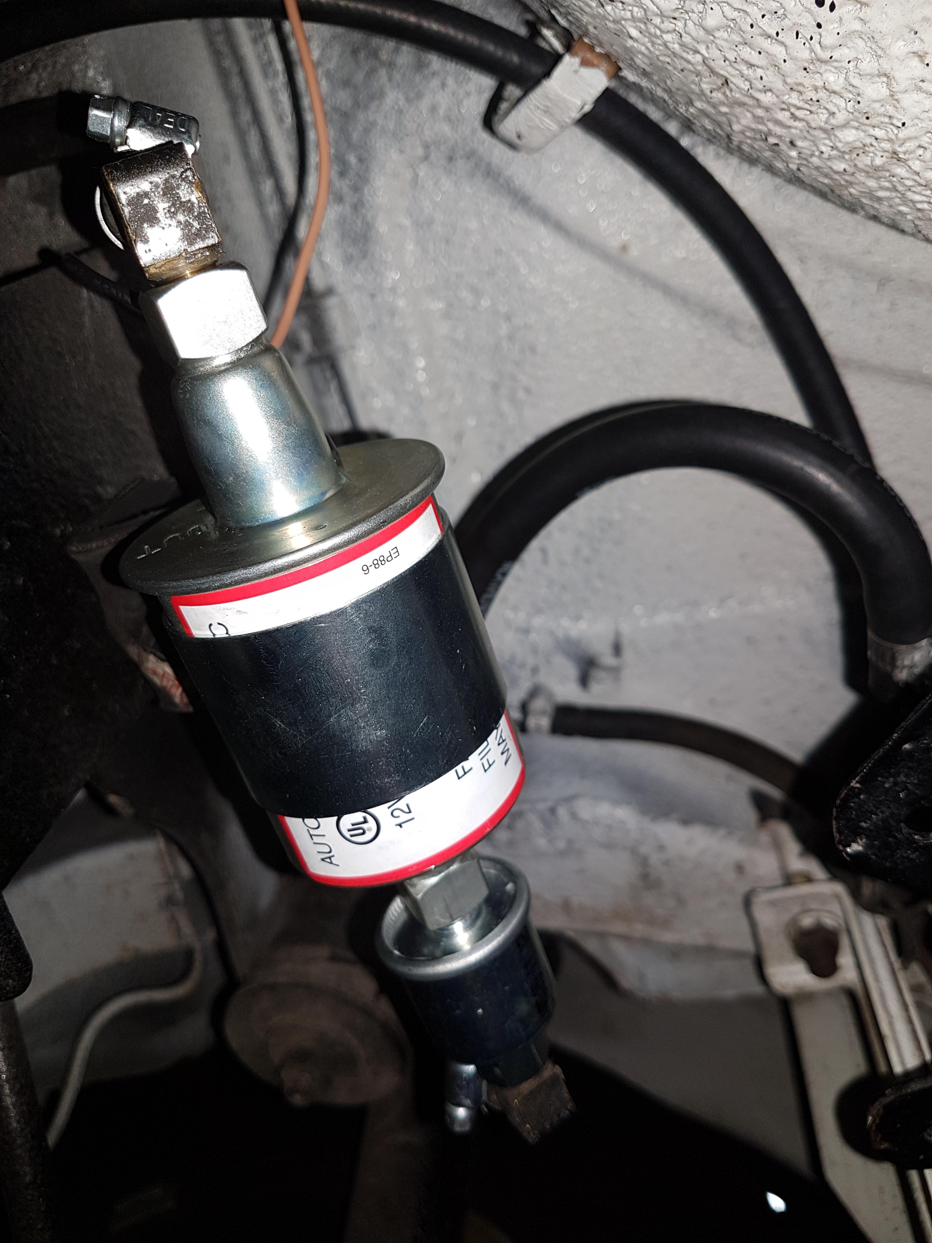

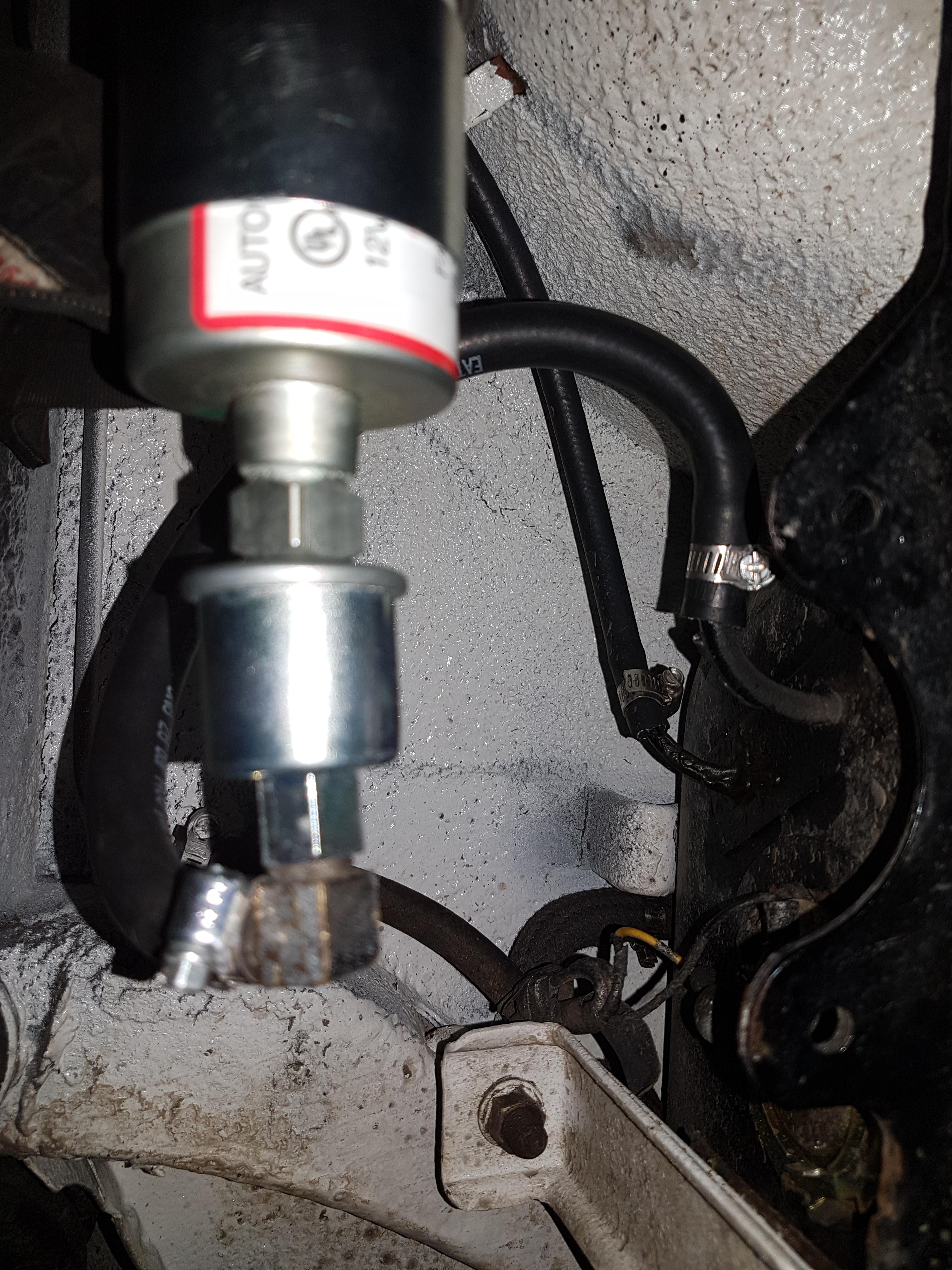

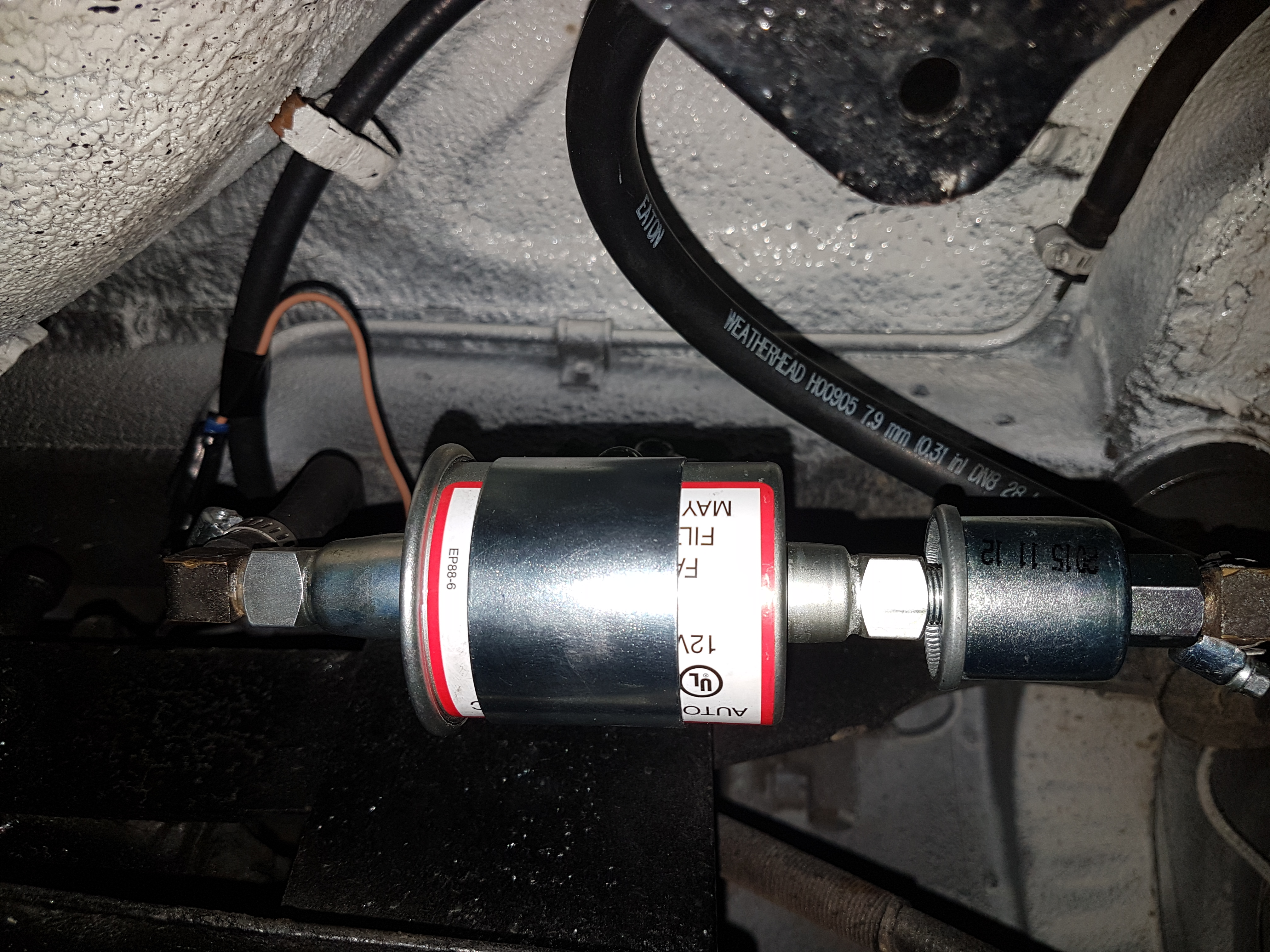

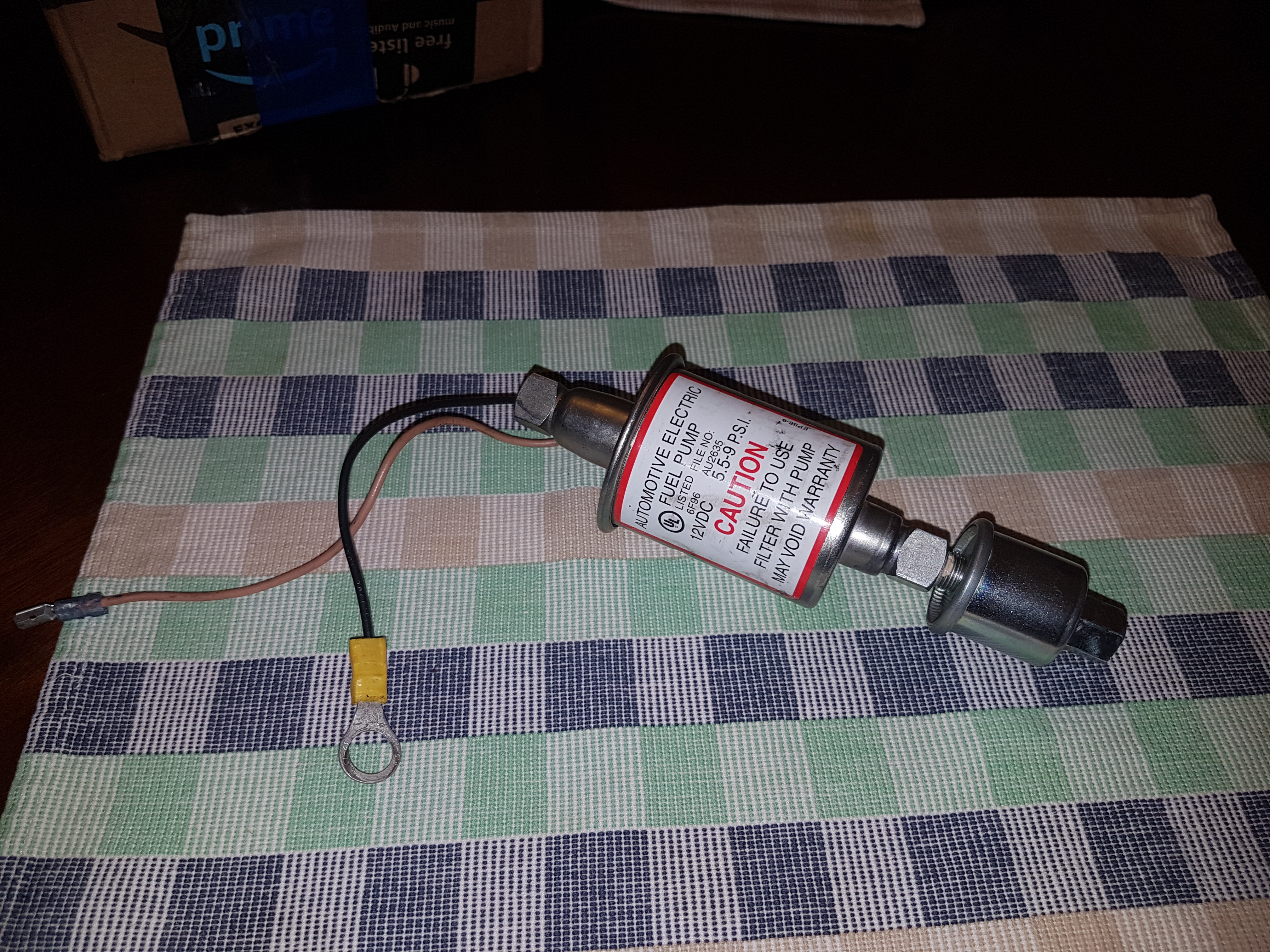

This is the same pump i have in my car. I was thinking of removing the small metal filter and adapting a fram G3 filter to protect it from the possible dirt on the fuel tank. What do you think?
