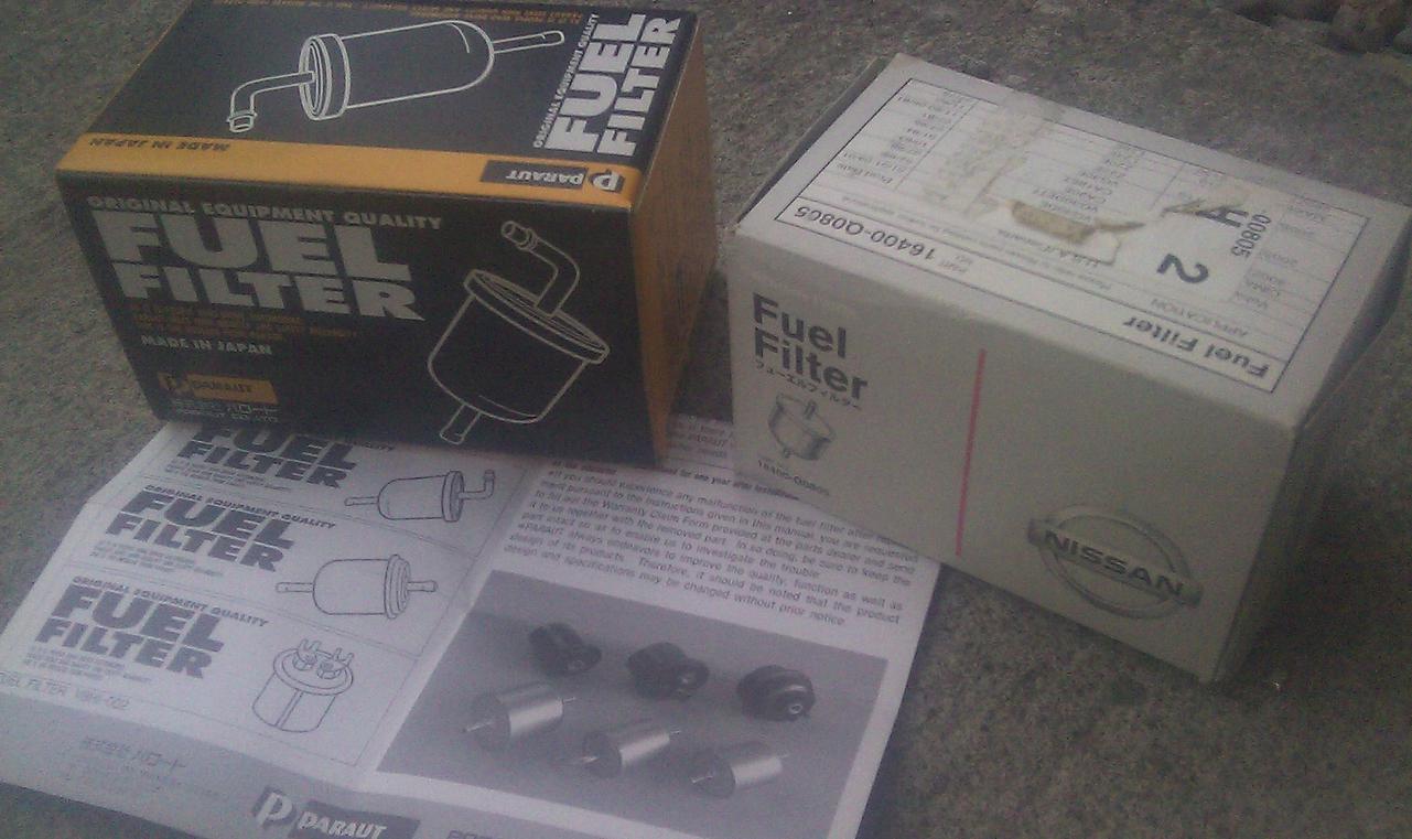

I have used both Nissan & Paraut filters. Very high quality, made in japan, and they appear to be the same filter.
I get the Paraut's from Autopartswarehouse.com, about $16 currently.
Just replaced the filter a month ago, didn't keep it or I would cut it open.

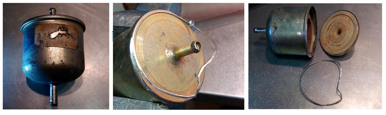

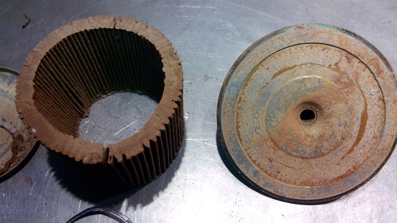

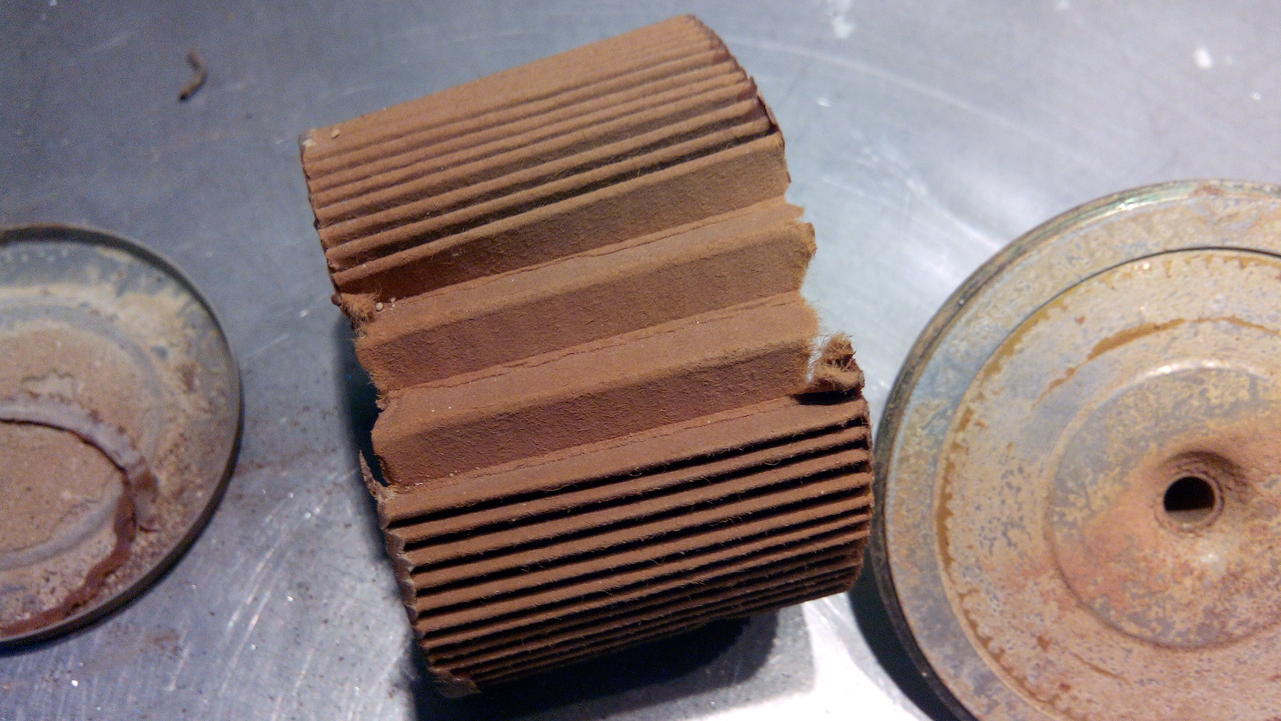

I found the old filter. It had a "Nissan" sticker, but its no longer readable. More alarming was the rattle it had when you shook it. Something was loose inside. I can't remeber it rattling like that when I removed it, but then I was more concerned with the water I had in the fuel.
Looks like the element had let go from the metal sections. Certainly wasn't filtering well like that. The filter is two years old.
Here are the photos of the filter and the contents.
