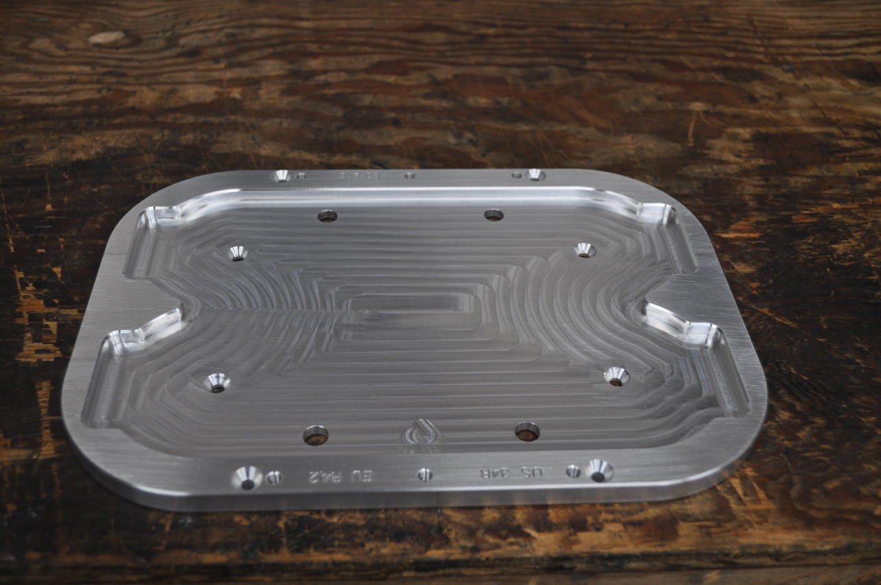

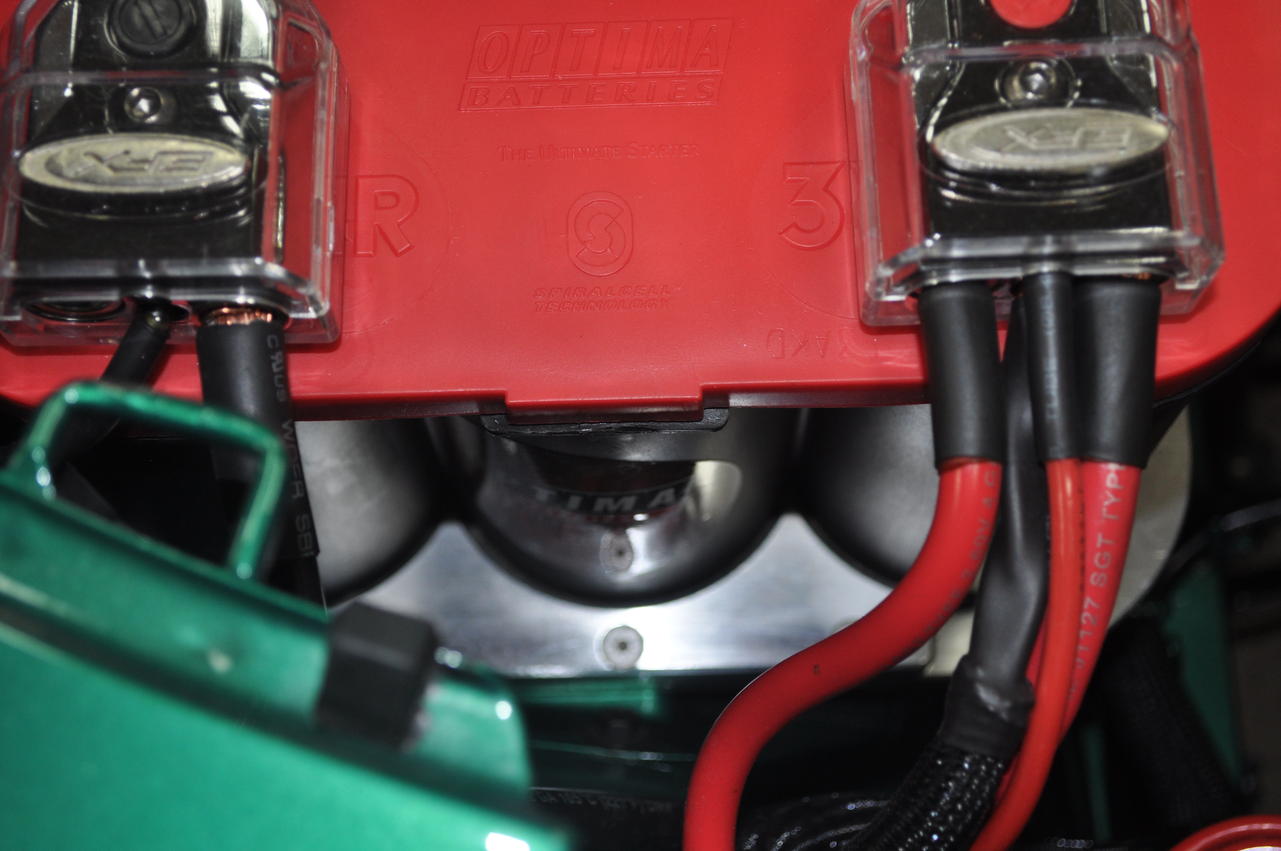

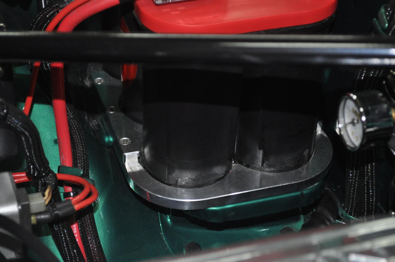

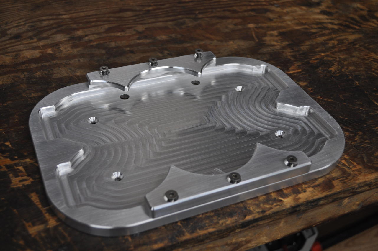

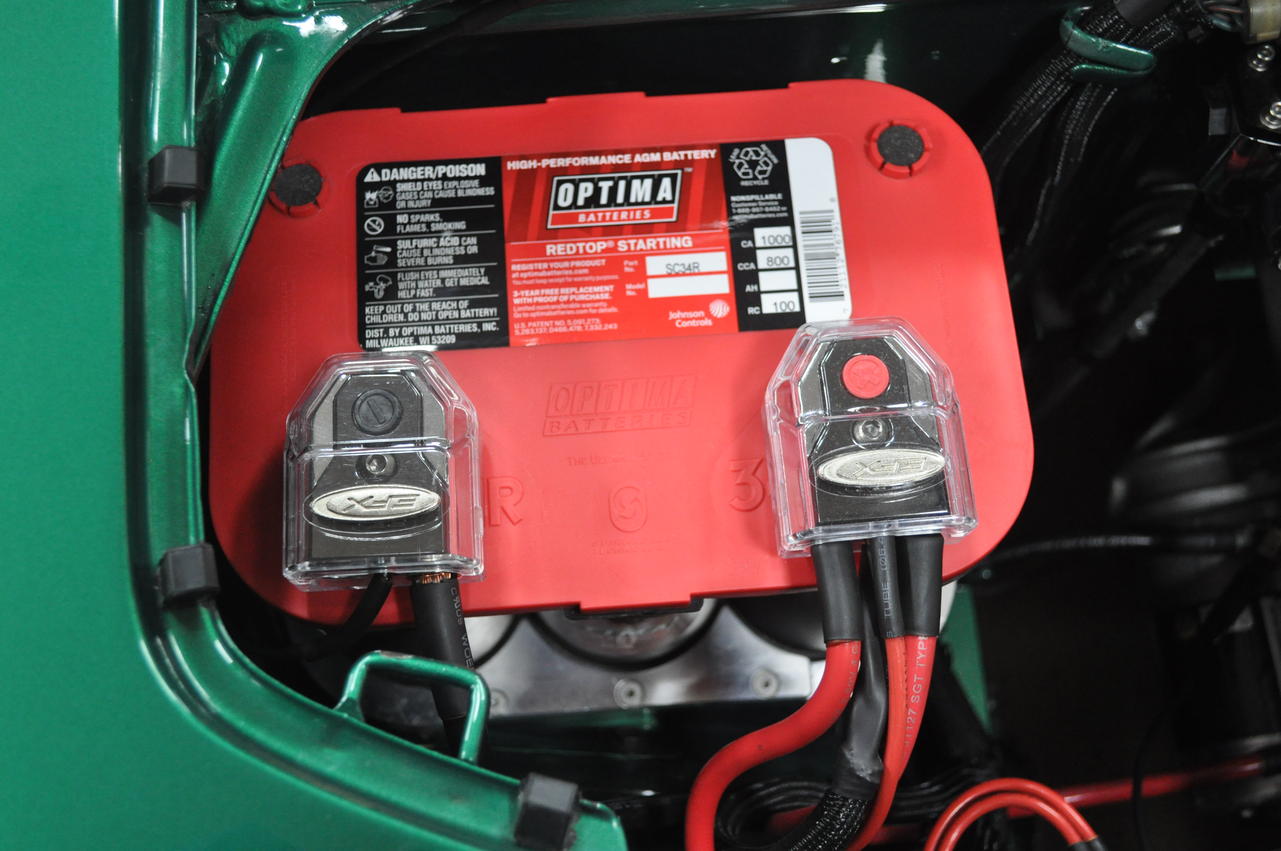

Instead of fabricating the bracket that Jeff G designed, I ended up going with a machined billet hold down plate that was specifically made for the Optimas. You can get these from numerous sources as well as eBay. I simply bolted the new Optima plate to the original battery plate that was welded into the Z. I had the back hold down bracket already installed, then slipped the battery in, then installed the front hold down bracket. It was a little tricky getting the bolts tightened and it was a relatively tight fit, but in the end it worked out great.
Here's a few pictures.
Mike.
