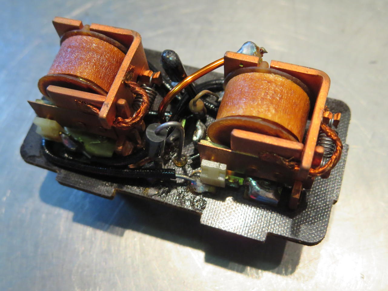

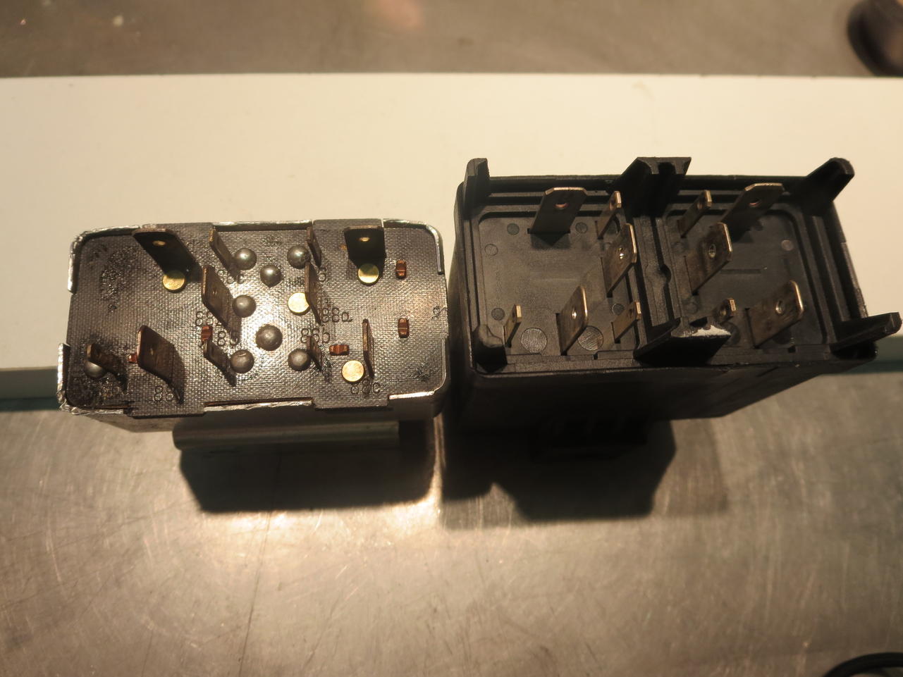

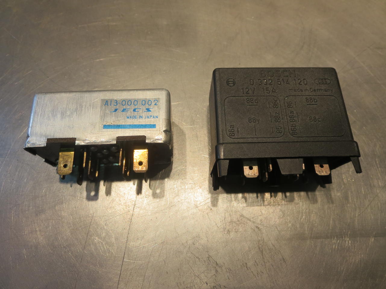

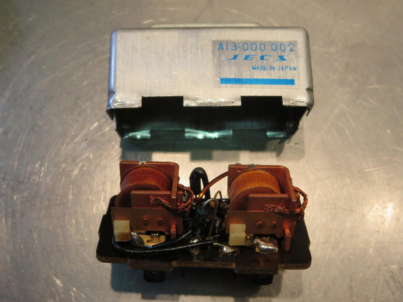

I found some old photos of the JECS when I had it apart. I have been using the Bosch version for two years and no issues.
I changed them because I suspected the relay, but it turned out to be a loose terminal plug in the AFM cable.
