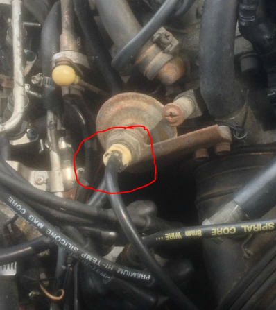

Here's some pictures of the engine if that helps
http://i.imgur.com/bqR4i7q.jpg
http://i.imgur.com/5SejnLO.jpg
http://i.imgur.com/WYkjXYu.jpg
Thanks in advance, this has been driving me crazy

it looks like there's been some work in the hose dept... i'd check the FSM for proper vacuum routing. it looks a little off to me - for one thing, i see a vacuum line going to the top of the throttle linkage dashpot, pretty sure that's just supposed to be open to the air, and that leads me to believe the vacuum line should be routed elsewhere.

What do you mean by the vacuum line going to the throttle linkage dashpot?.
I circled it for him. That little Sorry game piece shouldn't have a hose attached. The other end of that hose either needs vacuum or supplies it to somewhere.
what he said - and don't feel bad, i only know about this because i did it too...

Will I unhooked that line. It's connected to a t-coupling. One hose goes to the alternater the other to the throttle body. There's no vacuum coming from it so I'm assuming the end that was hooked up to the "sorry piece" needs to be hooked up to a vacuum source. I cannot find where it would go though.

http://i.imgur.com/42jf9YC.jpg
The vacuum comes from the throttle body. It's called ported vacuum and only sees vacuum when the throttle is off-idle. Throttle closed, there's no vacuum.

Great that you're digging in to doing your own work, but you should take notes when you take things apart and/or use the diagrams in the FSM when you put them back together. Based on the hoses to the dashpot and the alternator. there may be other things connected not-quite-right. That could be part of your problem. Off the bat, I'd say that your vacuum advance hose to the distributor does not have a vacuum source. Just a guess. Every hose and wire has a specific purpose and needs to be properly attached.
