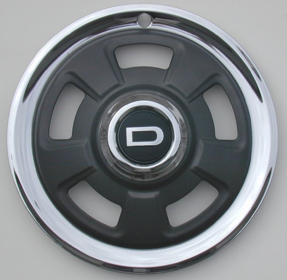

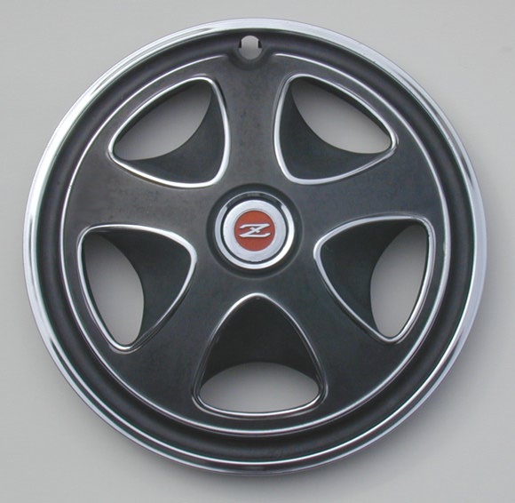

Aside from bolt pattern and wheel size, what the OP needs is the diameter of the part of the wheel that the hubcap clips into. I can measure this later today, although I have 1973 wheels which are 4x114.3mm, 14x5" (yours are probably 4.5" wide) and I have the orange-centered, "Z" hubcaps. Do you have the hubcaps with the large chrome D in the center? Here are a couple pics:
70-71 style:
72-75 style:

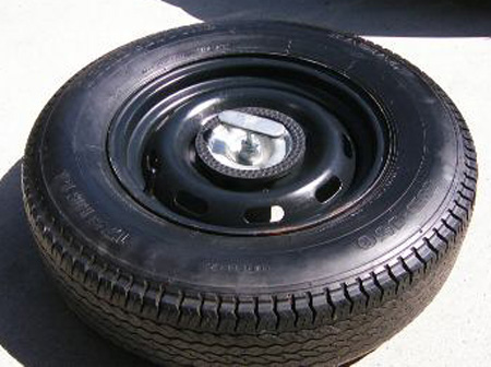

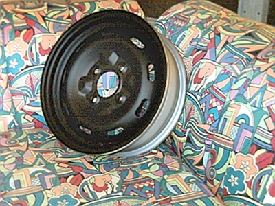

Osteopath,
Try the search function on the site and you may find more information. An original steel wheel for your car is part number 40300-E4400 which is a 5-J x 14 size. 40300-E4600 is a 5-1/2 J x 14 optional wheel originally offered. They look like the pictures I have attached - black exterior / silver interior. Originally, the tire offered was a 175 SR-14 tubeless radial or a 175 HR-14. I'm currently not aware that this size is manufactured anymore, however 185 and 195 sizes are available and they fit fine. Wheels were encoded with a date of manufacture. If you are particularly nit-picky, you would want a wheel set date stamped prior to your month and year of manufacture, but once the hubcap is on, no one will be able to discern. I seriously doubt that Nissan has these wheels available so your search is probably going to include eBay and junk yards. Look out for rust. I had my sets refurbished several years ago for about $75 / wheel.
Edited by 26th-Z
^I believe the 5J wheels became available in 1972. The OP's 1971 car would have been built with 4-½ J x 14. Although if your very early cars have 5" wide wheels, I could be convinced I'm wrong! My info comes from Arne and he's pretty good with wheel/tire topics. That being said, I don't think the OP is overly concerned about originality, he just wants the OE hubcaps to fit the car.
Yep, I agree. The 4-1/2" wheel is 40300-E4100. My US parts book shows just the 5" and 5-1/2" and my Japanese parts book lists the 4-1/2" wheel for the L20 series cars. It shows the 5" wheel for the L24 series and the 5-1/2" wheel for the PZ series. In terms of fit for the wheel cover, I have never heard of a successful fit for anything other than the stock steel wheel.
