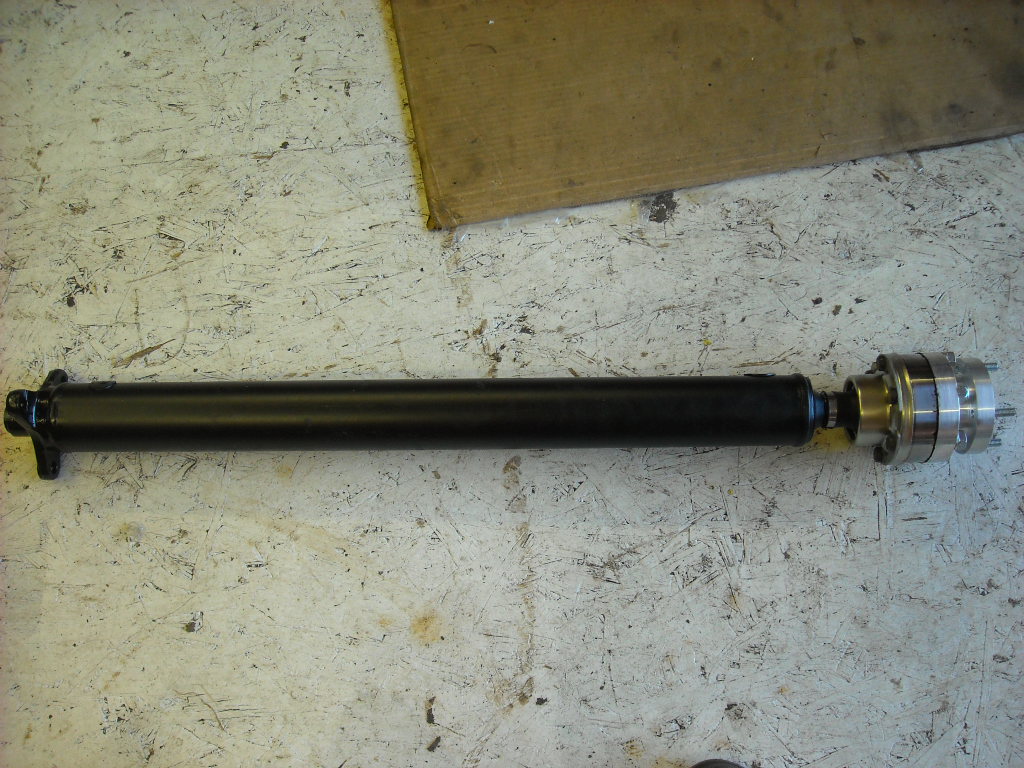

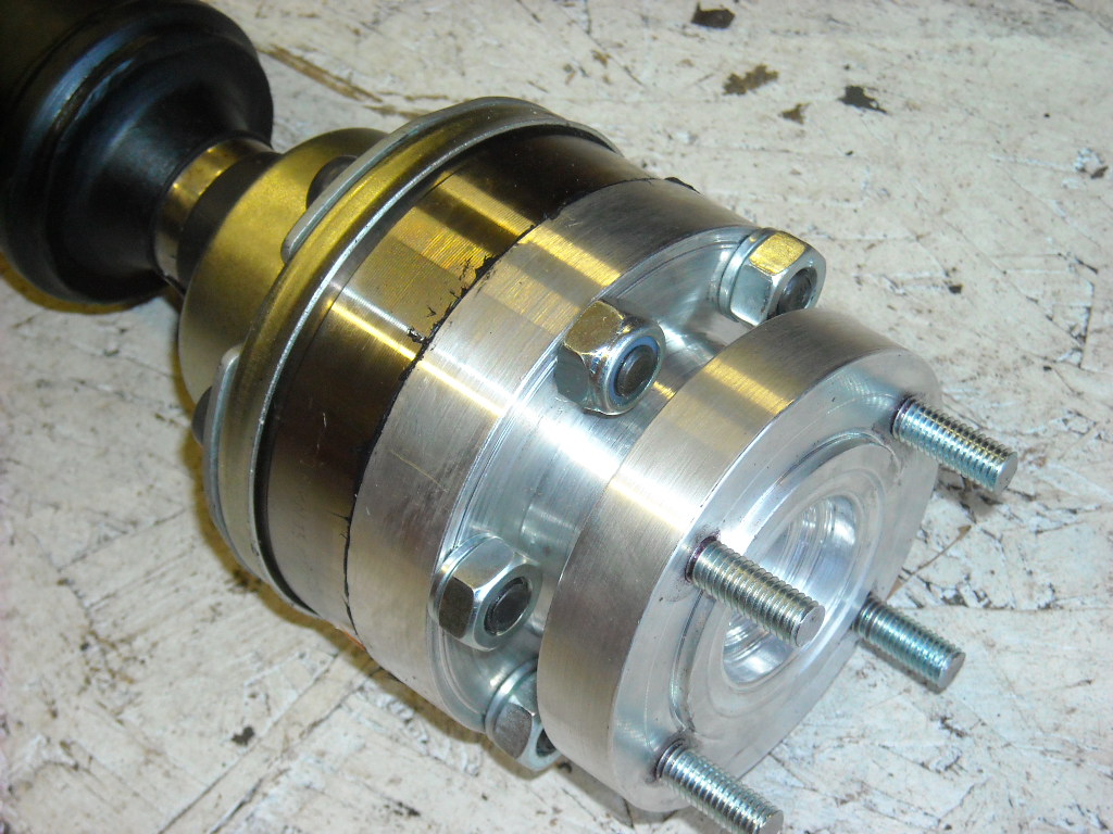

I have been working on this adapter for a couple weeks now and just finished it today, it will mate the bmw CV joint to the input shaft of the Nissan R200 diff.DSCN0663.JPGDSCN0665.JPGDSCN0669.JPGDSCN0670.JPG Also, the drain tube pouring water down between the fender and the body is something I have been meaning to fix for a while, no more rusting fenders.

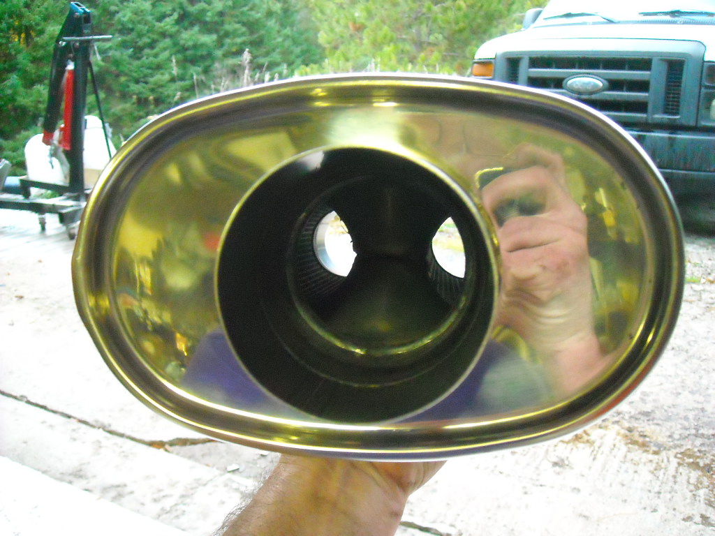

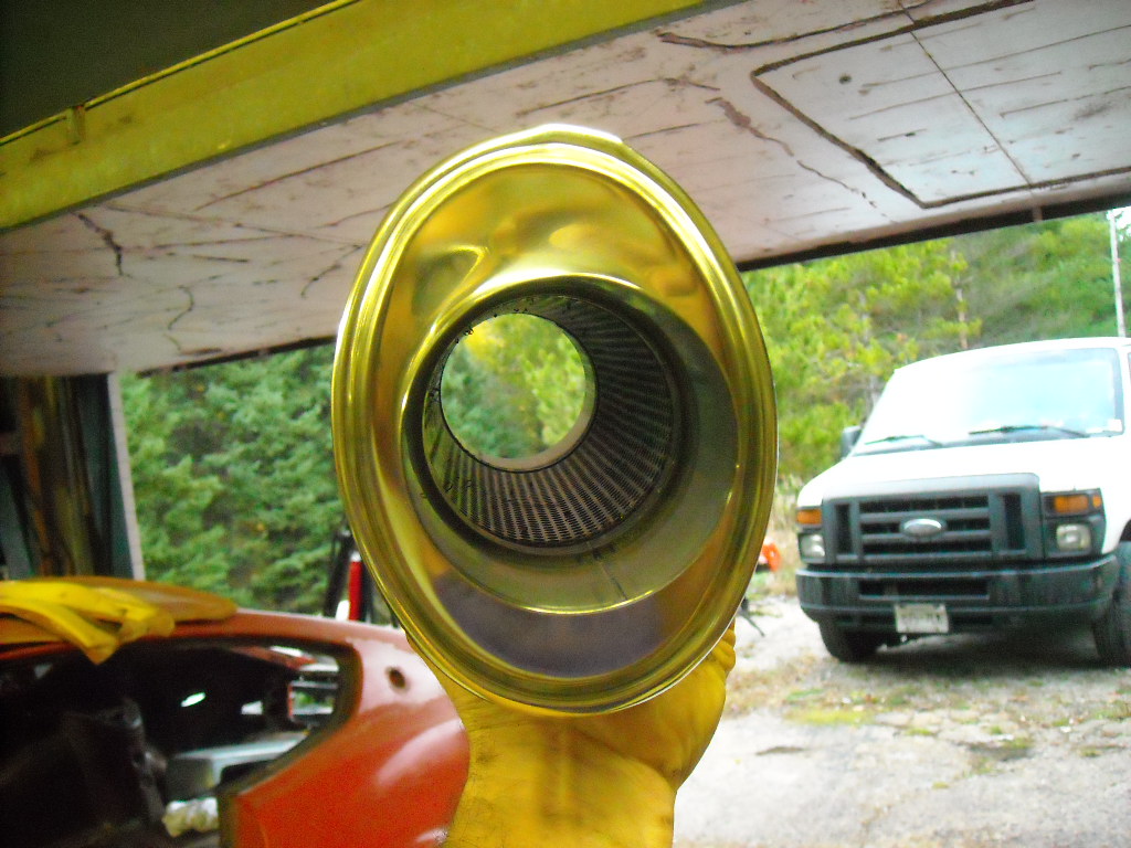

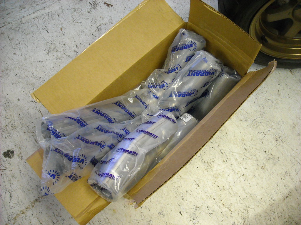

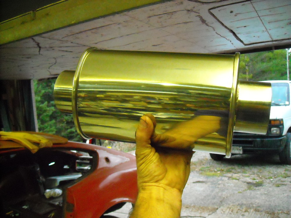

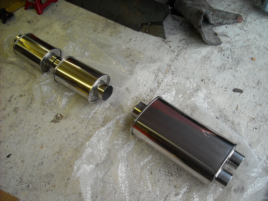

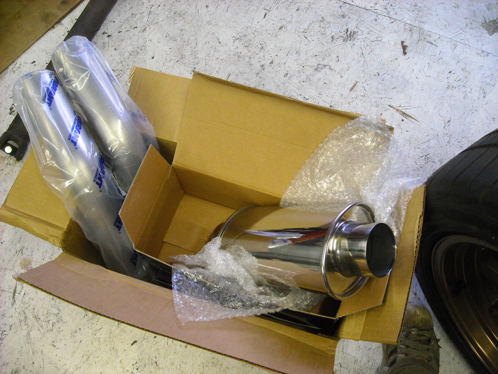

The Summit Racing elf came early this year, I love that little guy! The resonators will be welded together and sit under the drive shaft, all the pipes are pre-bent mandrel 3" T304 SS.

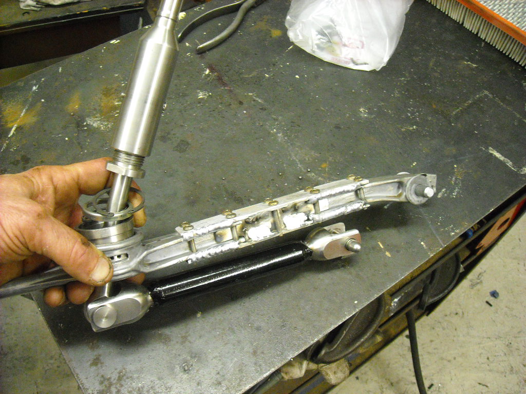

I'm hoping this will be quiet enough but also be able breathe, I'll try make the exhaust tips look like the old twice pipes.  Also finished the extensions on the shifter linkage.  All the pretty parts of the shifter linkage are UUC stuff, very well made and engineered.
CO, thanks, the adapter is aluminum.
The exhaust set up looks a little similar to what I run, albeit with two thicker resonators vs my single thin 18" one.  My muffler is a perforated core one too, 3" in/2x2.5 out.  With the windows up, it's actually reasonably quiet inside the car, although I do have new weather stripping and lots of sound deadener.  It is very loud outside the car.  I suspect the two thicker resonators will help a little more to keep things a little quieter than mine.  I do get pretty much no drone on the highway though, which is nice.

CV shaft joiner looks awesome!!!!

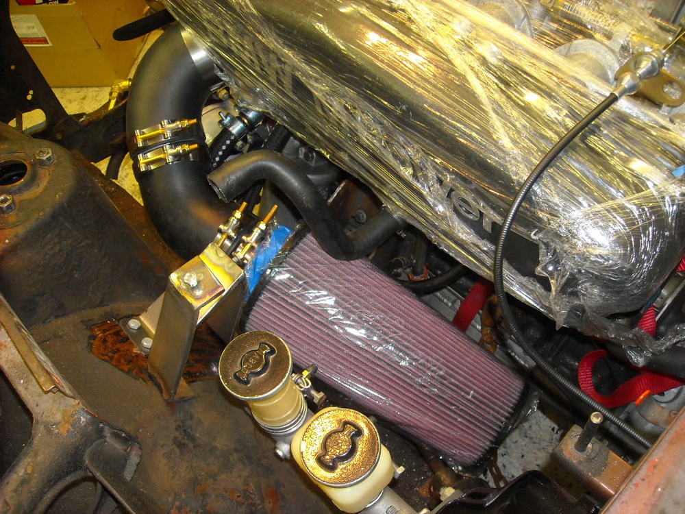

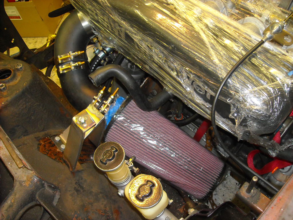

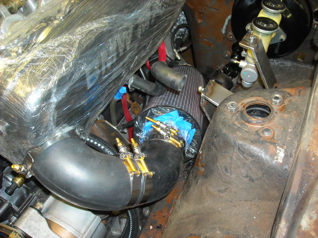

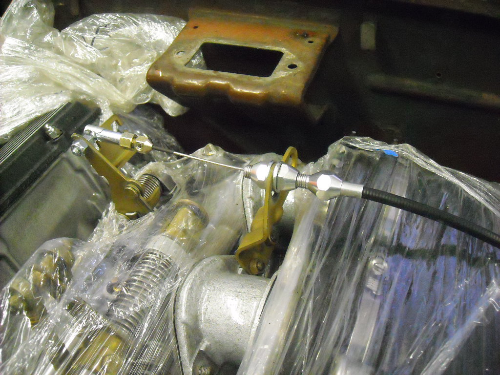

Well I have finally finish installing the drive line, engine mounts, transmission mount, drive shaft and diff are all in and I think, are perfectly a lined. As best as I can measure it I think I'm within half a degree in both axis. So hopefully the drive line will be vibration free :unsure:   Also got the oil cooler plumbed in, the accelerator linkage installed and air filter sorta finished. As much as I hate K&N filters I bought one anyway, after spending lots of money and time trying build or adapt a paper filter airbox that just didn't work.
The K&N filter will get me on the road until I can figure something else out.
have you looked at 944 S2 panel filters from K&N?
great for making air boxes! you'll just have to sandwich them between a flange and use a latch or two like the battery box you made.
http://www.promaxmotorsport.co.uk/images/thumbs/0000536.jpg
