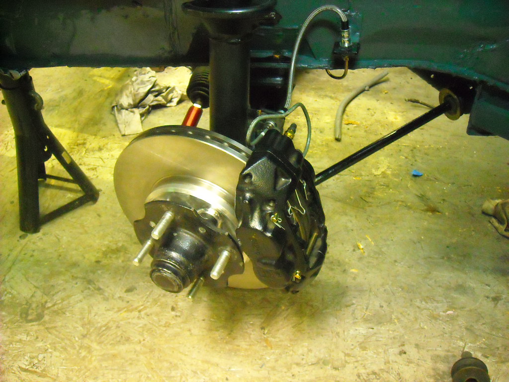

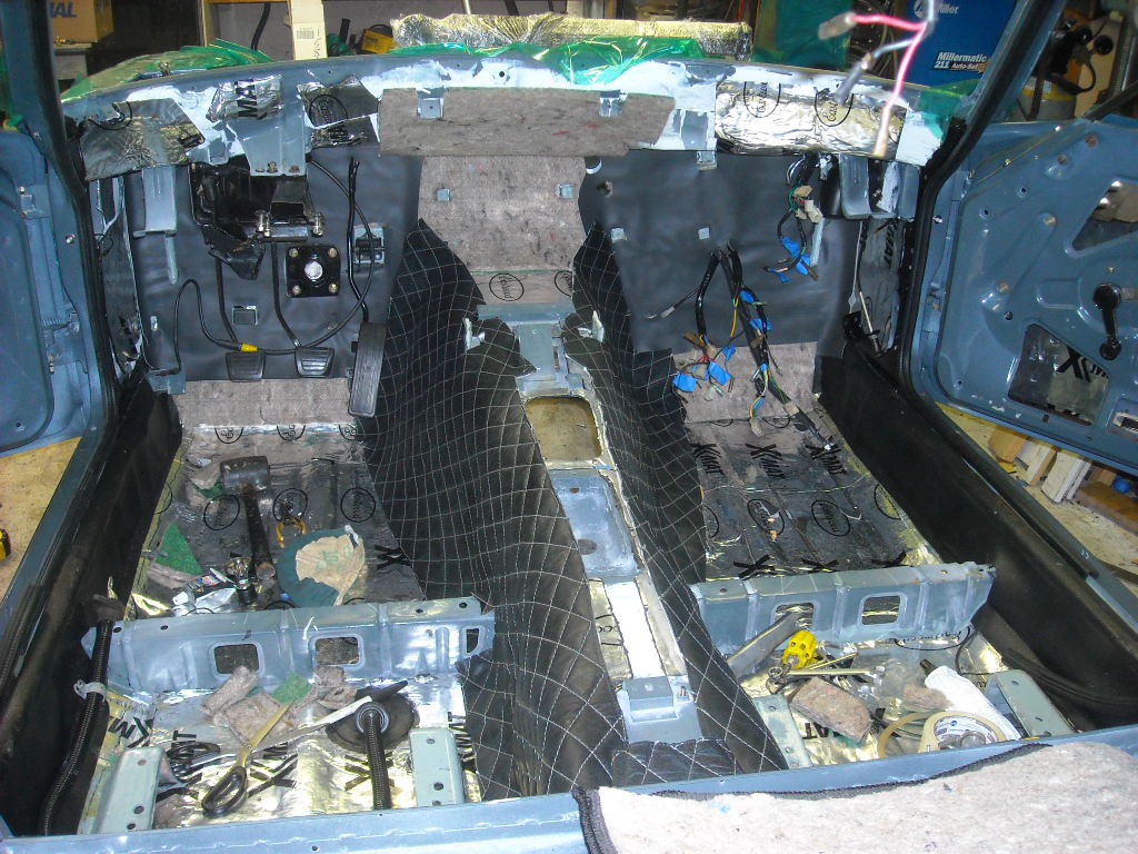

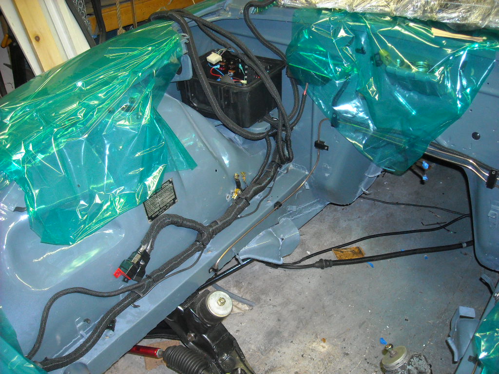

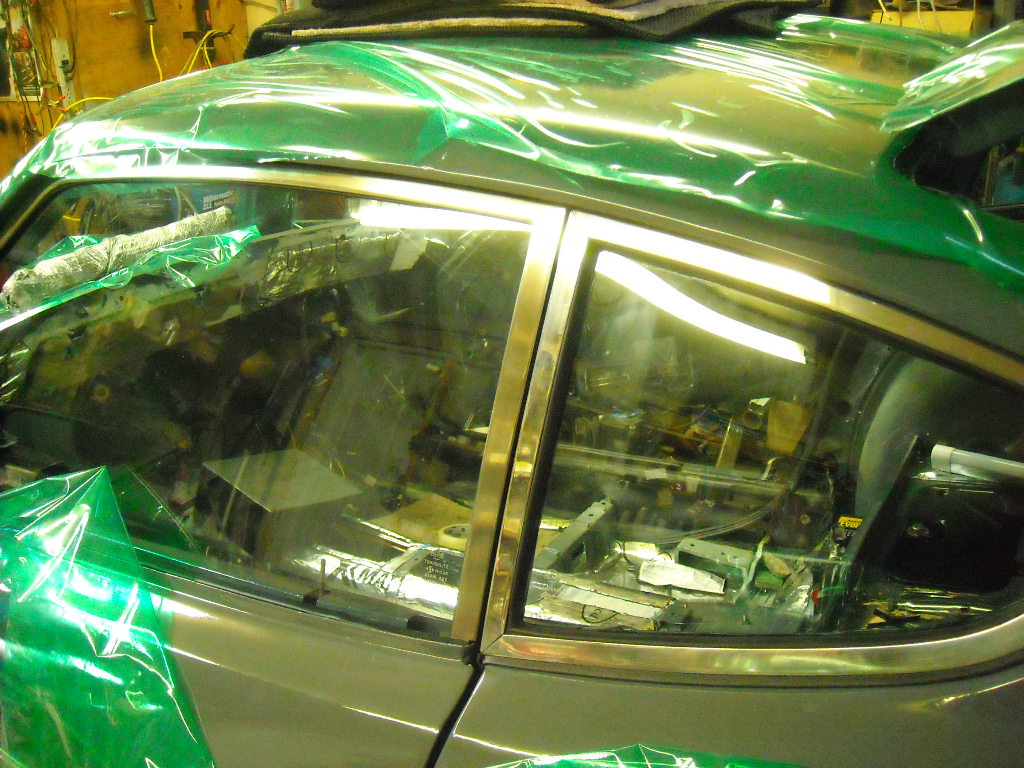

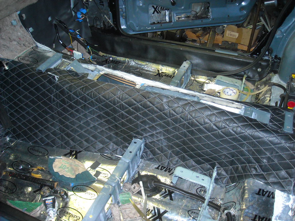

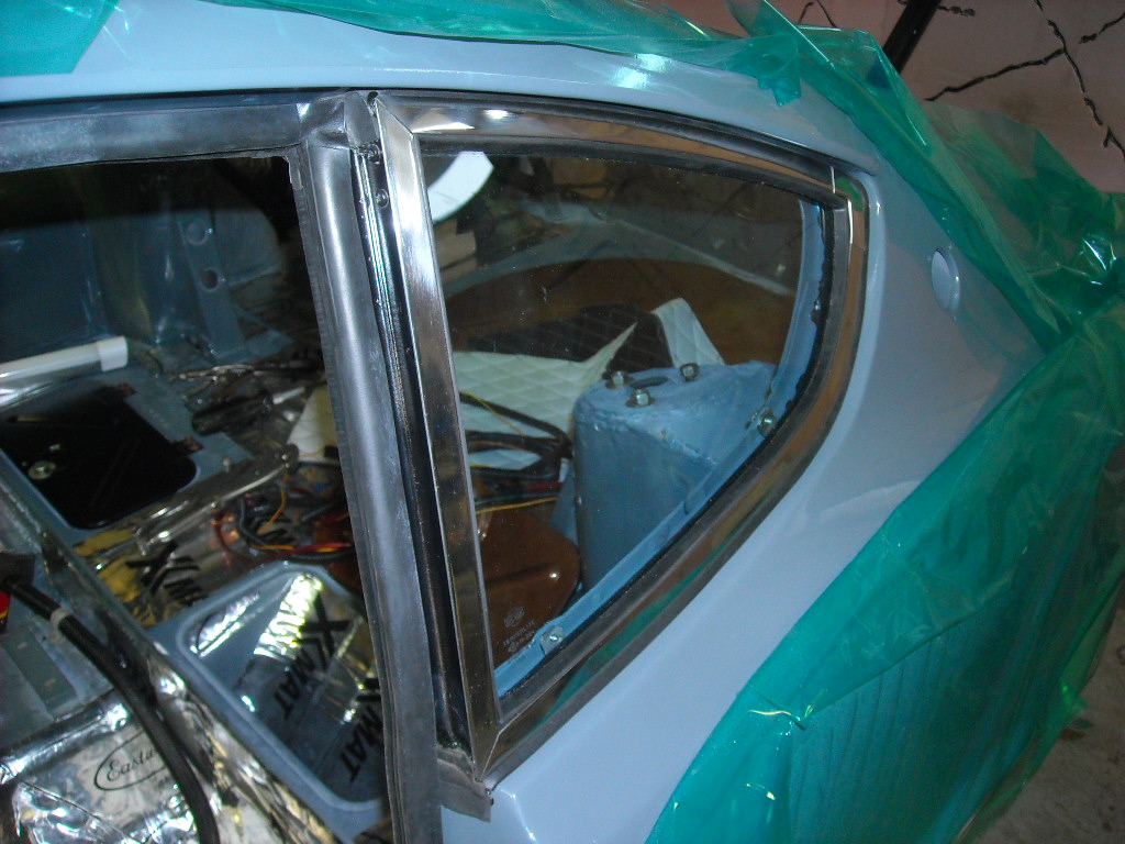

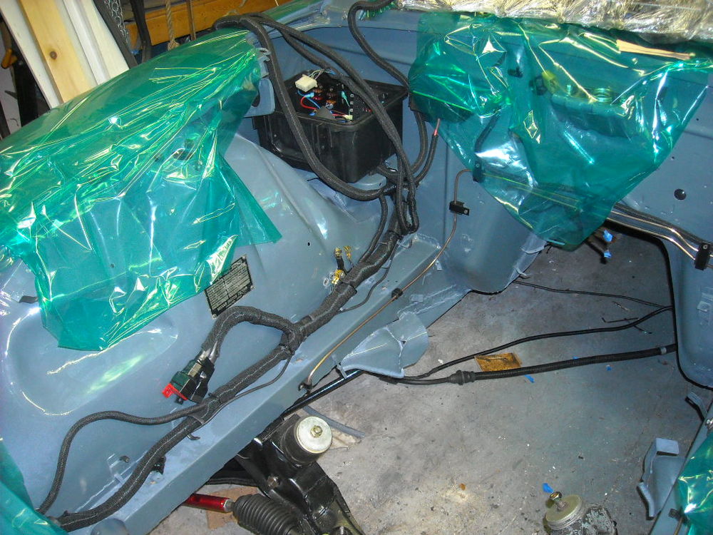

Made some good progress today, finished installing the front suspension so the car can come off the jack stands now and back on to wheels, got the engine bay wiring harness in, door glass and quarter windows in and started playing around with the leather trans tunnel cover, also almost finished the firewall insulation. Starting to get more comfortable with contact cement and the tack off times.

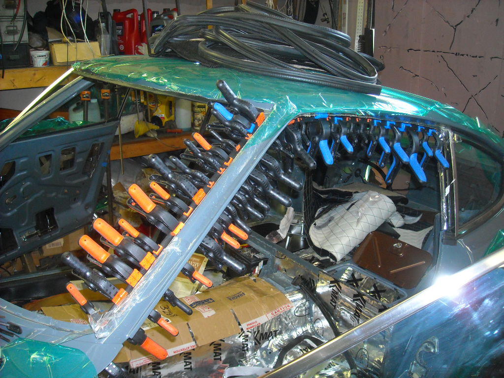

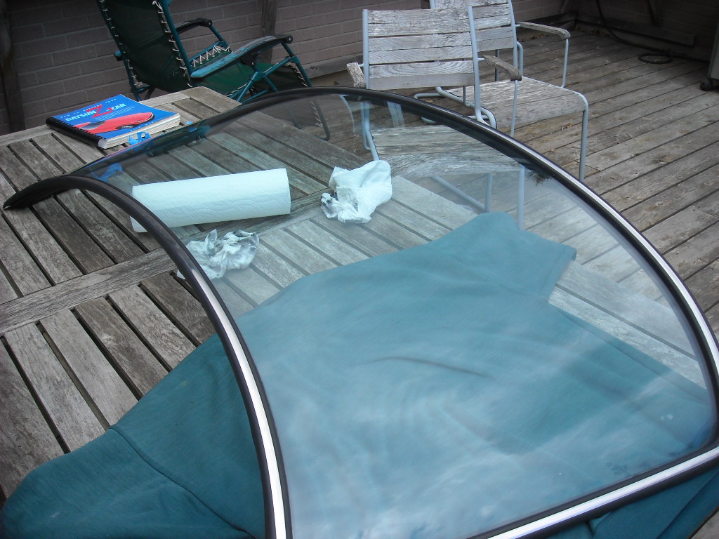

Re your leather gloss issue for the door panel material, why not just try a coat of paste wax (or, if it makes you feel better, clear shoe polish)?
Alternatively, check to see whether SEM (or a competitor) offers a satin finish clear for use with vinyl and leather.  Suggest you have a look at 'Parasol' (Toronto).  They will custom-mix and ship to your door.  I had very good results with their products.
Your right John, the door doesn't really need to be much darker, I'll bet just some more shine will give it a darker appearance. Can't say I like the idea of black shoe polish right next to where my wife will sit with some favorite white top that will be ruined and I'll never hear the end of it.

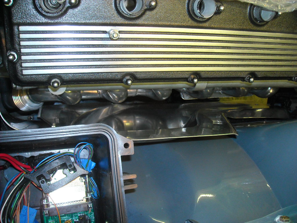

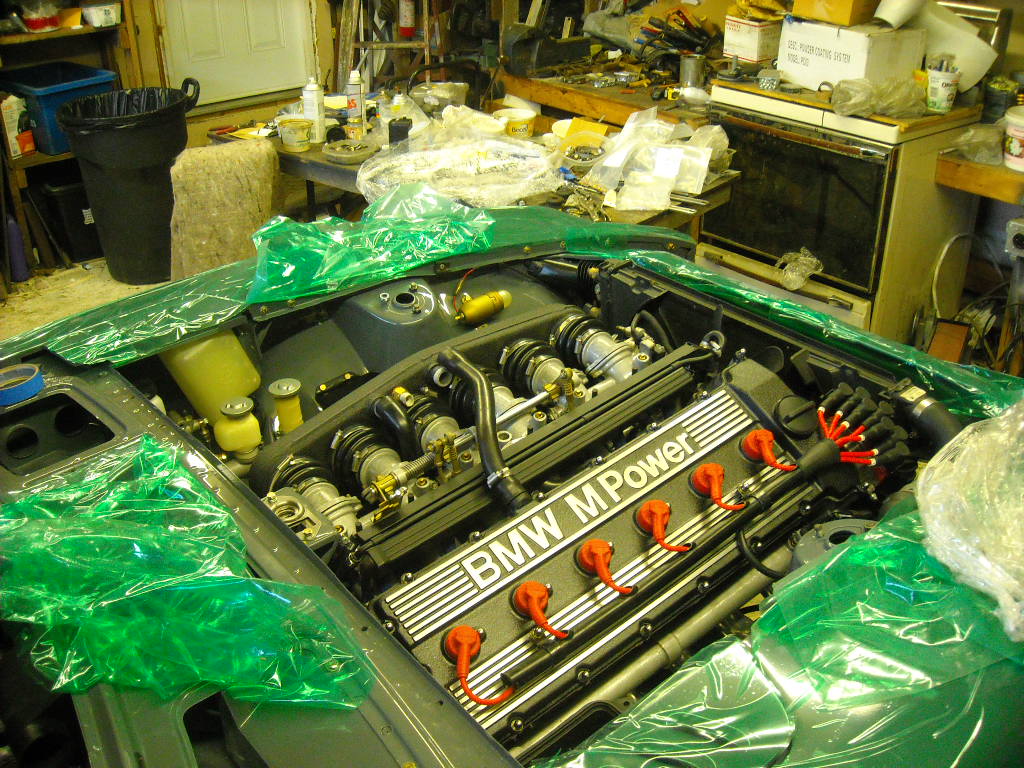

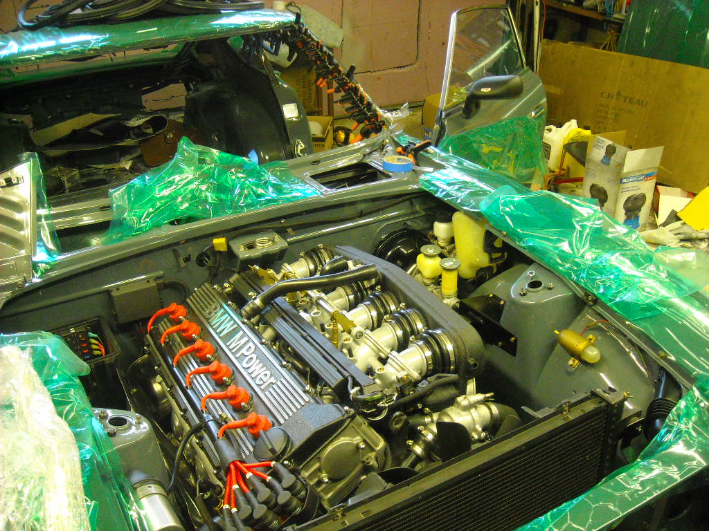

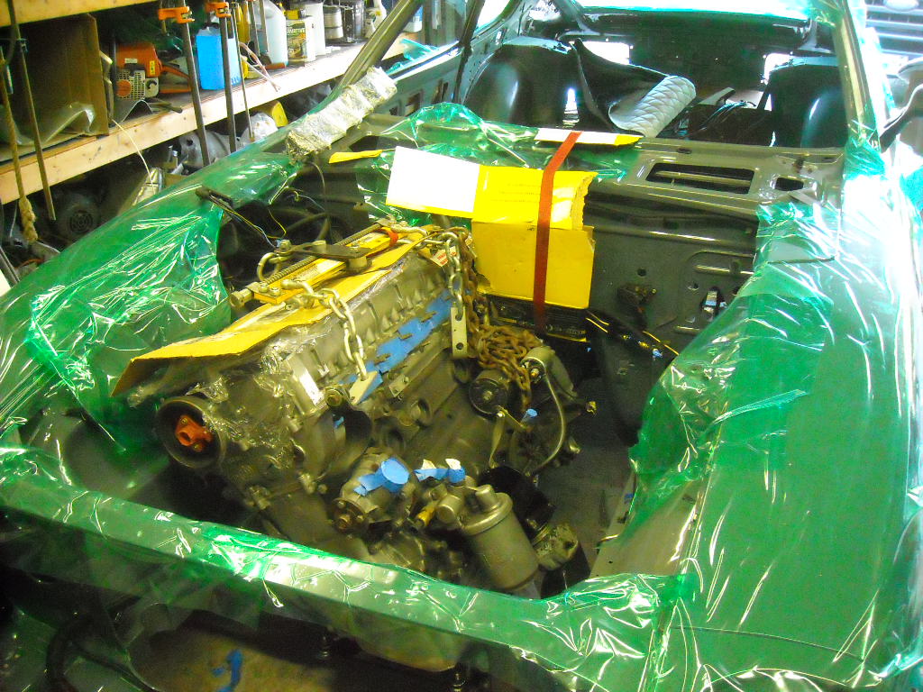

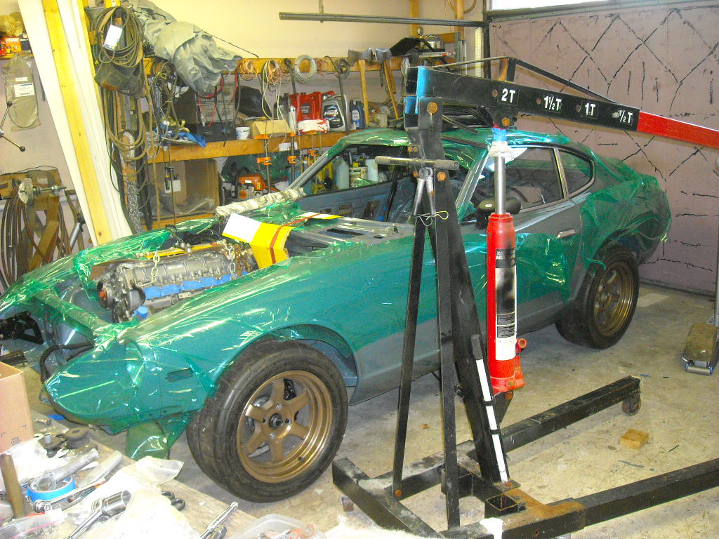

Got home early today so I thought I would get everything prepped for installing the engine later on this week but as it turned out I had just enough time to get it in, not a minute too late, I'm getting too old to be dropping engines in by myself. I'm running out jam.

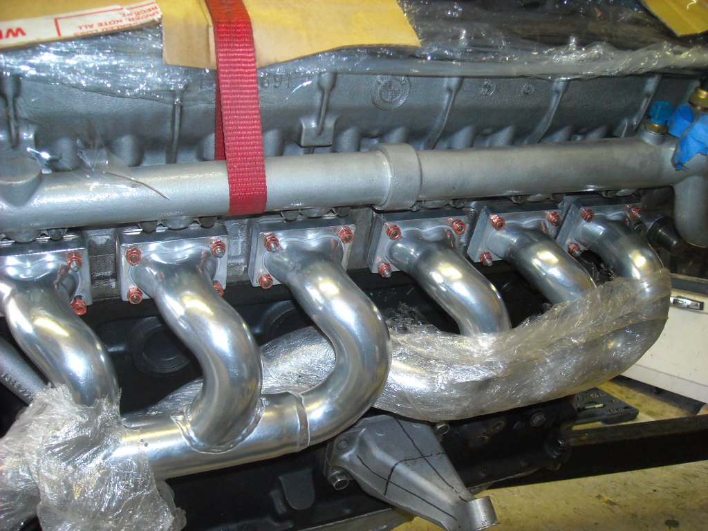

Thought I would take a pic of all this new hardware cause I aint going to see it again once it's in the engine bay,

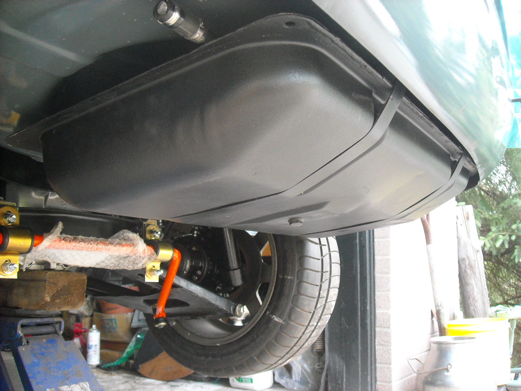

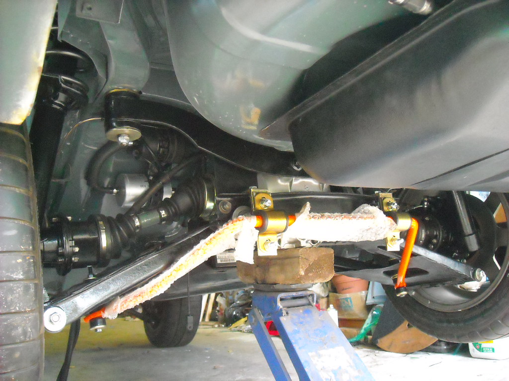

DSCN1472.JPGrear end almost finished, just have to fit the exhaust system now,

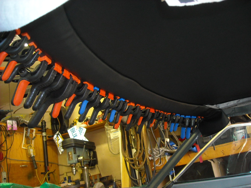

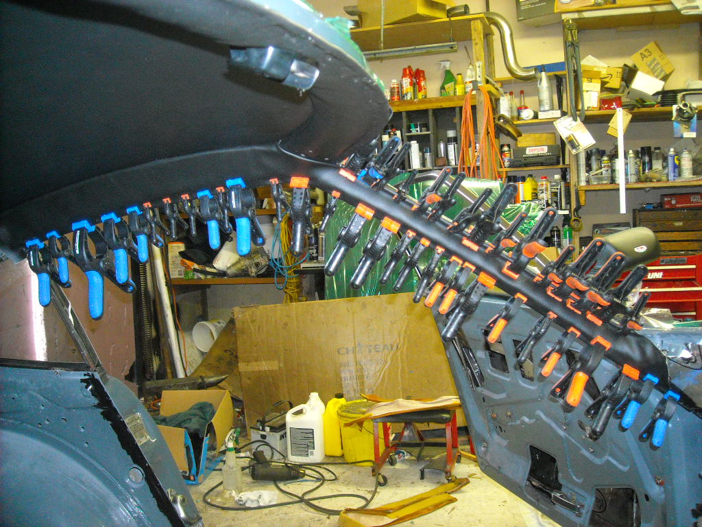

I got the header vinyl in today and just by chance noticed that my wife had  dozens of these clamps a couple days ago so the timing was great.

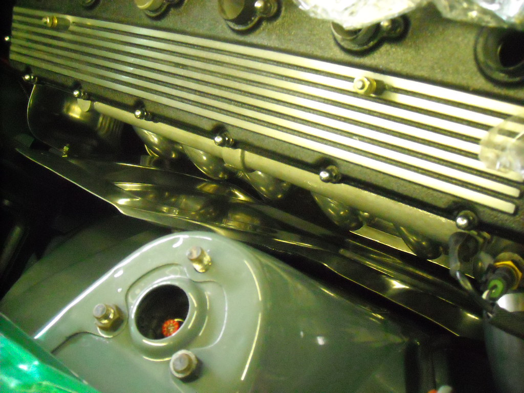

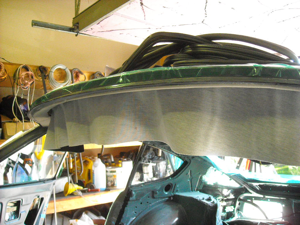

DSCN1483.JPGDSCN1486.JPG also windshield rubber and ss trim installed,

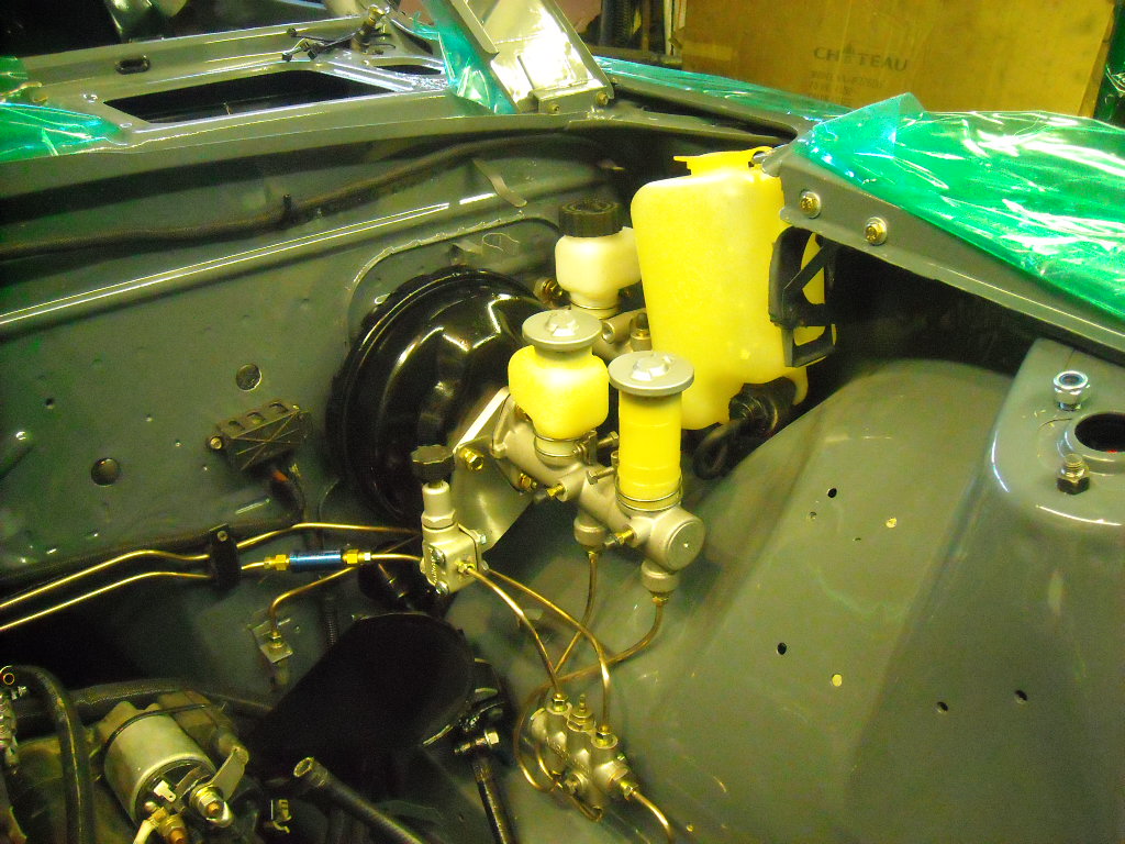

DSCN1488.JPGbrake and clutch masters are in and ready for fluid,

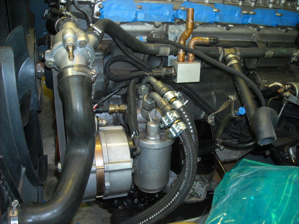

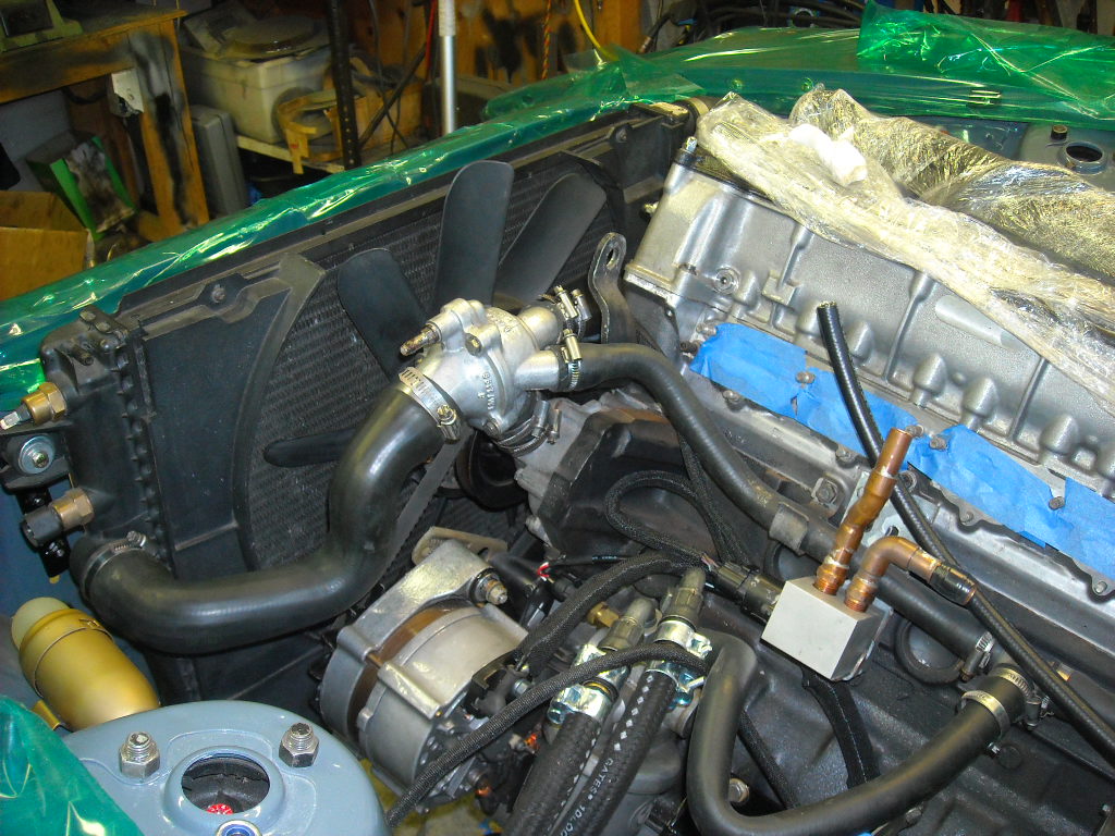

DSCN1492.JPGRadiator, fan, alternator, oil cooler and a bunch of little stuff,
