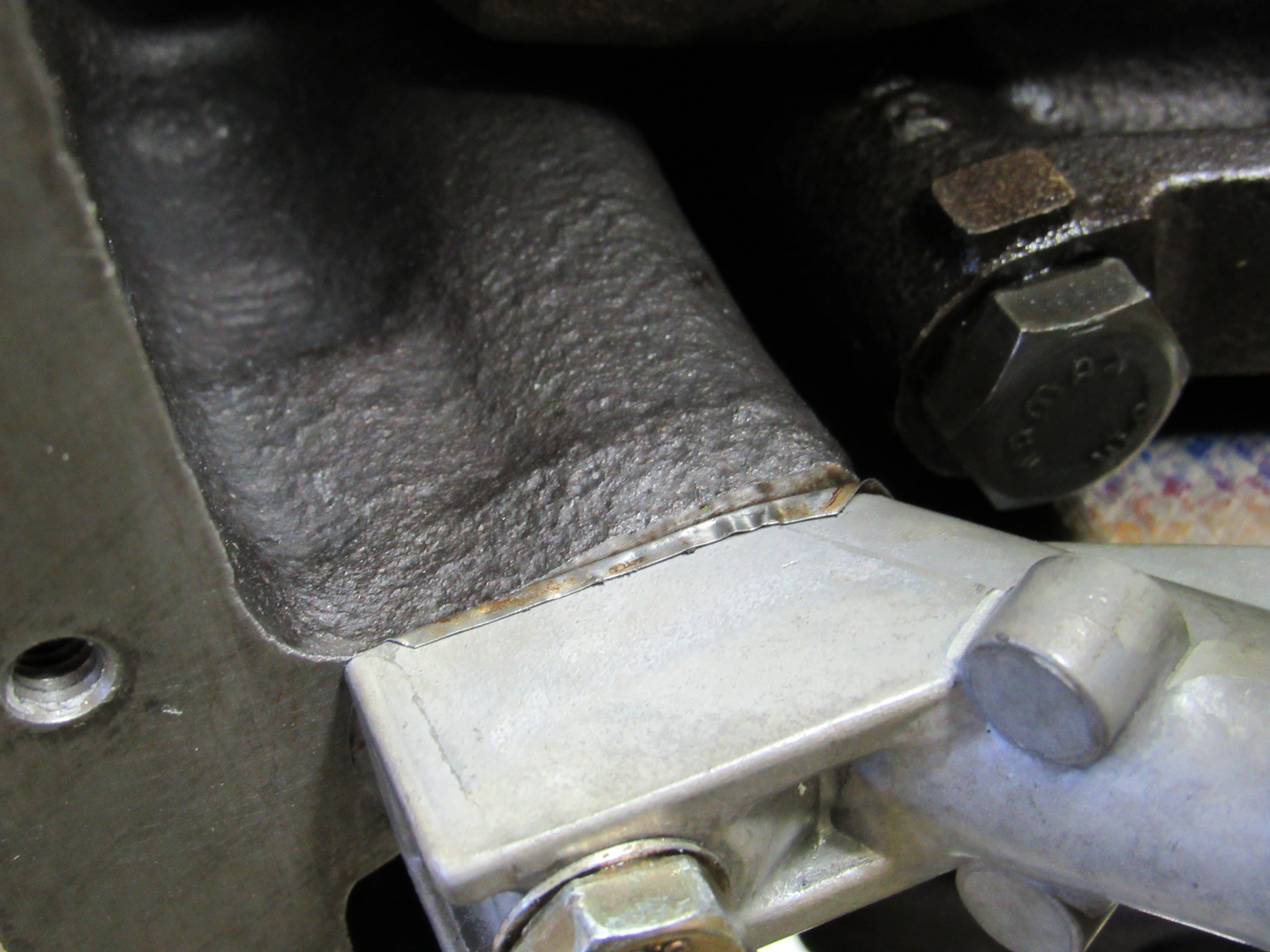

grannyknot Posted September 21, 2017 Author Share #589 Posted September 21, 2017 (edited) Sorry, that 2nd picture is confusing because I hadn't threaded that side yet, the curved end side has 2 in" of threads, the bushing end has 5/8" of threads, is screwed into the coupling nut then welded. The curved side is male, the bushing side female. Edited September 21, 2017 by grannyknot Link to comment https://www.classiczcars.com/topic/50240-thinking-about-installing-an-bmw-m6-engine-in-my-z/?page=50#findComment-530706 Share on other sites More sharing options...

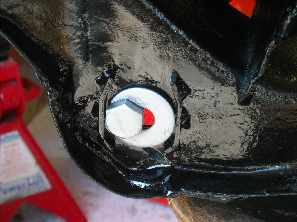

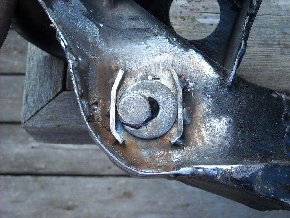

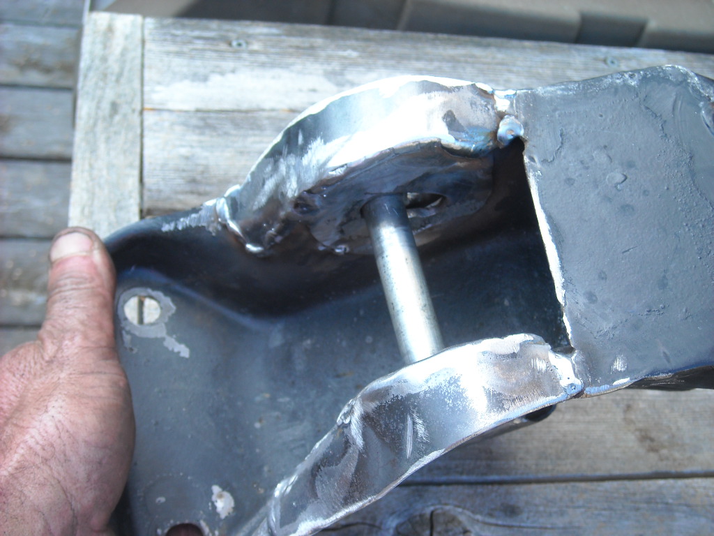

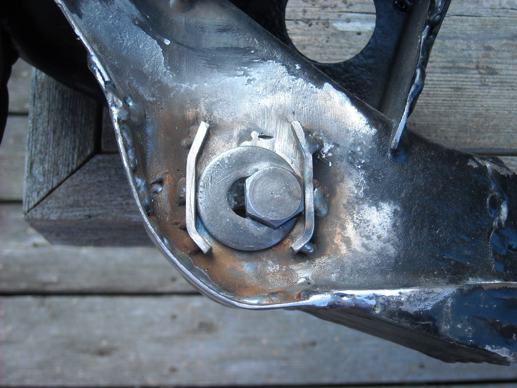

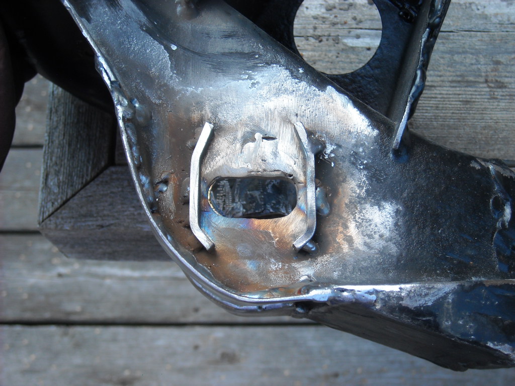

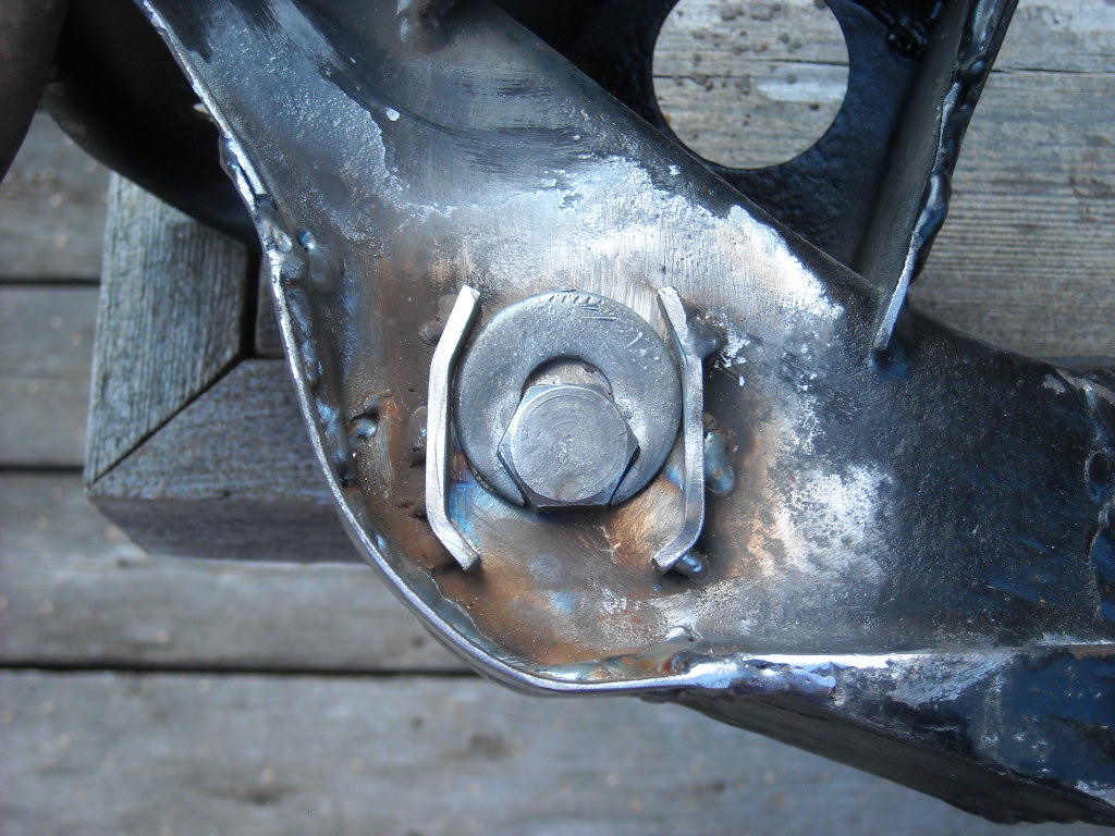

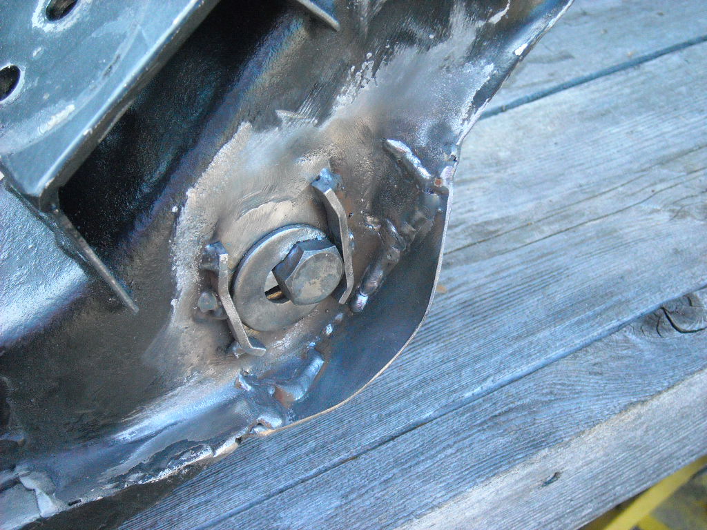

grannyknot Posted September 23, 2017 Author Share #593 Posted September 23, 2017 (edited) I decided not to make the LCA adjustable for camber but the crossmember instead, there isn't a lot of room to slot on the XM so had to flatten the existing metal and add extra support. Changing camber is done by loosening the LCA pivot bolt nut and adjusting. This is the stock positionLots of camber, not sure what this new position will work out to in degrees but I'm sure it will be plenty. Edited September 24, 2017 by grannyknot Link to comment https://www.classiczcars.com/topic/50240-thinking-about-installing-an-bmw-m6-engine-in-my-z/?page=50#findComment-530888 Share on other sites More sharing options...
240260280 Posted September 24, 2017 Share #594 Posted September 24, 2017 WOW that is ingenious! Just like on modern cars but better implemented. Link to comment https://www.classiczcars.com/topic/50240-thinking-about-installing-an-bmw-m6-engine-in-my-z/?page=50#findComment-530891 Share on other sites More sharing options...
grannyknot Posted September 24, 2017 Author Share #595 Posted September 24, 2017 Thank you, but not from my brain, I only steal ideas Link to comment https://www.classiczcars.com/topic/50240-thinking-about-installing-an-bmw-m6-engine-in-my-z/?page=50#findComment-530910 Share on other sites More sharing options...

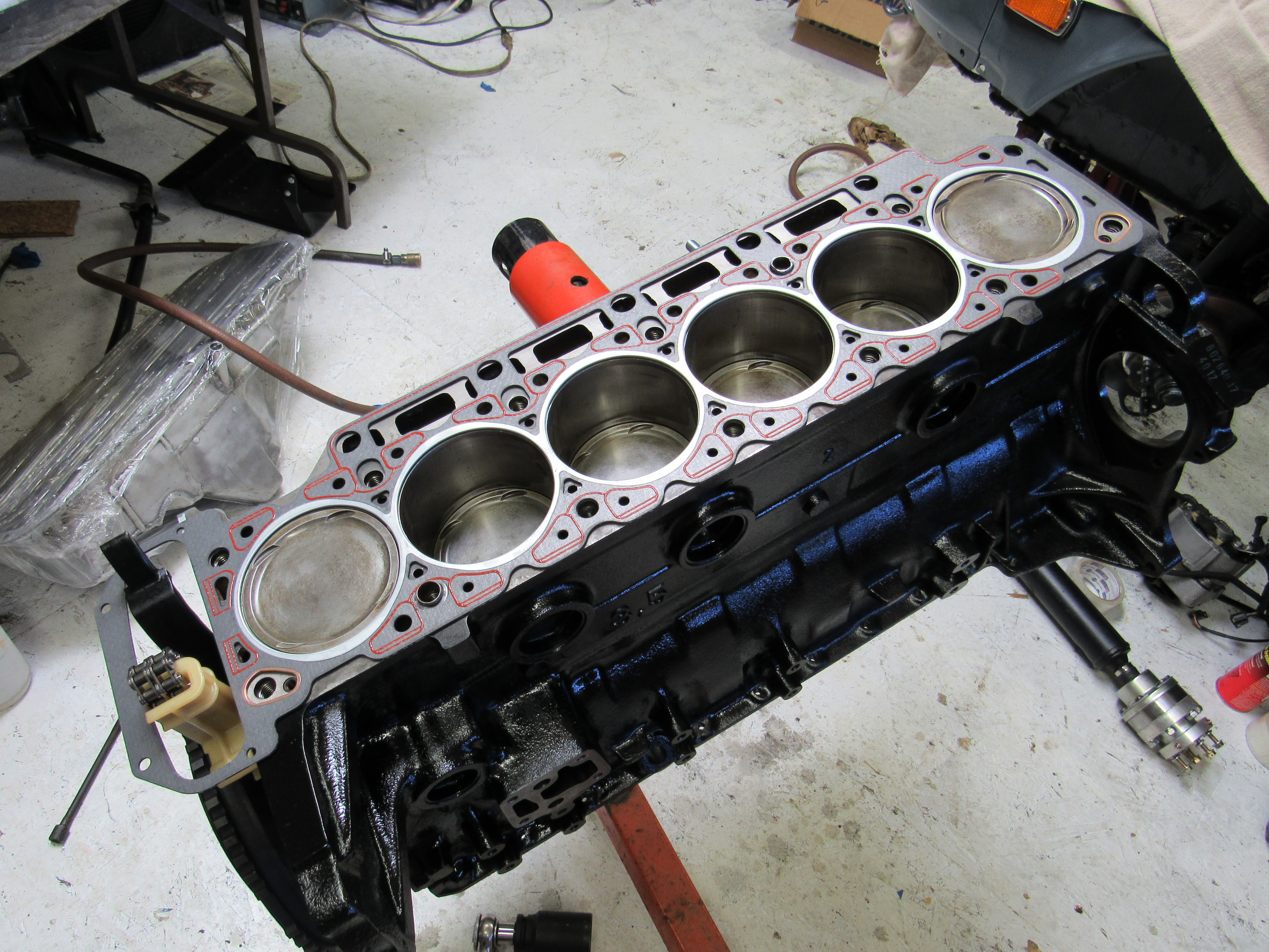

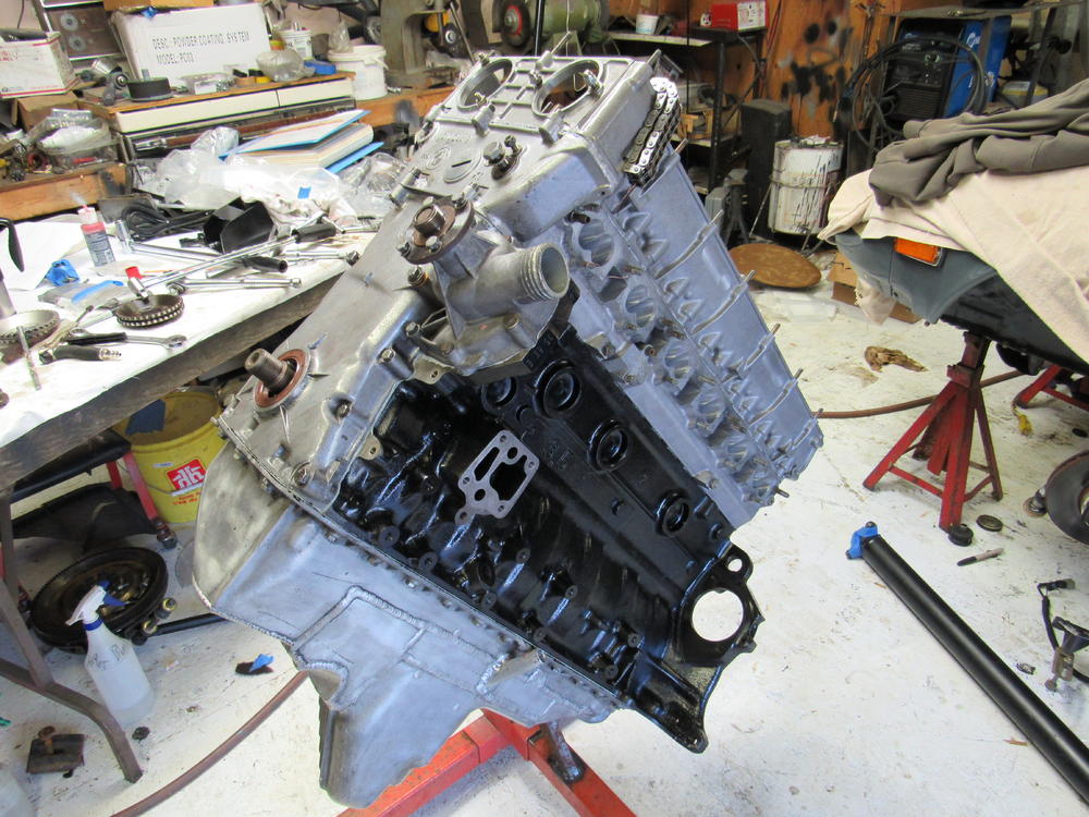

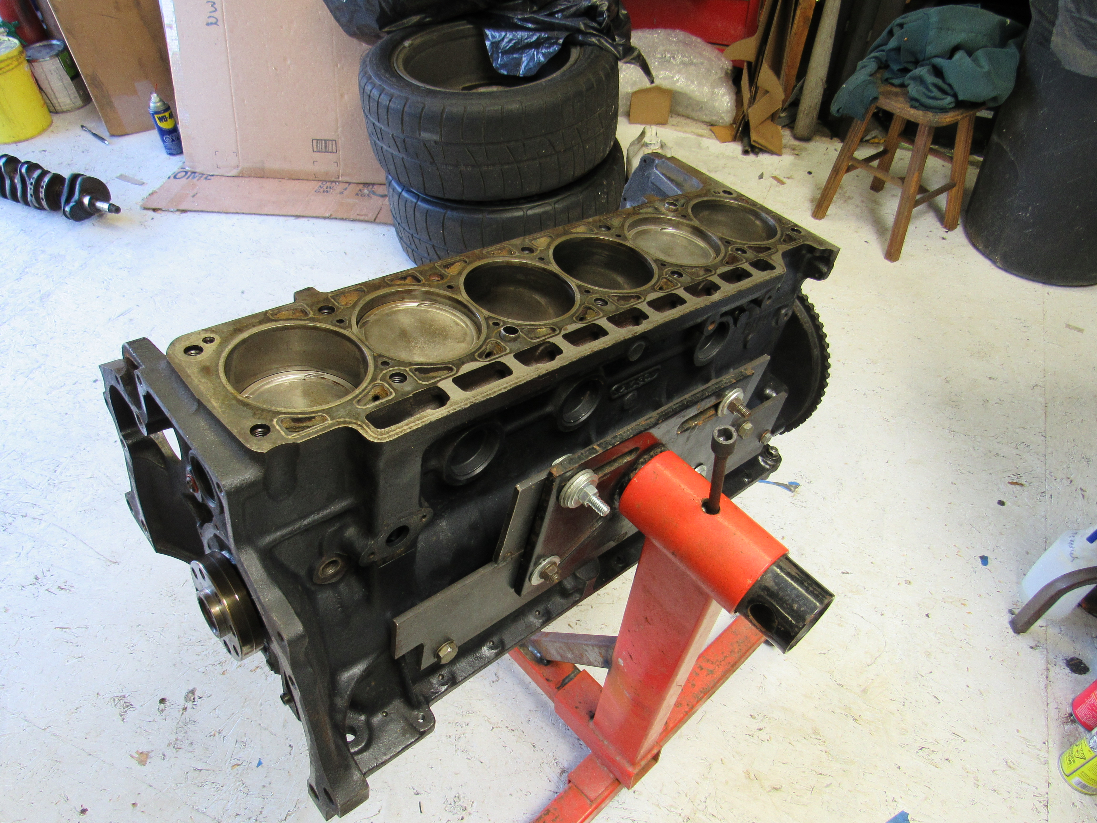

grannyknot Posted October 17, 2017 Author Share #596 Posted October 17, 2017 I have the engine back!!! So a good used crankshaft (10,000miles) new bushings for the conrods and main bearings and new oil control rings. The 3 front oily cylinders were because of the oil control rings, they were buggered up. I'll post up some pics soon but I just got it back today. 1 Link to comment https://www.classiczcars.com/topic/50240-thinking-about-installing-an-bmw-m6-engine-in-my-z/?page=50#findComment-532647 Share on other sites More sharing options...
zKars Posted October 17, 2017 Share #597 Posted October 17, 2017 I love your LCA adjustment solution. Just don't forget the crush sleeve that just fits snug on that bolt on the inside of the K-member so it has something to lock on. Link to comment https://www.classiczcars.com/topic/50240-thinking-about-installing-an-bmw-m6-engine-in-my-z/?page=50#findComment-532649 Share on other sites More sharing options...
Captain Obvious Posted October 18, 2017 Share #598 Posted October 18, 2017 Glad you found something with the front three cylinders too. Always good to have closure!! Link to comment https://www.classiczcars.com/topic/50240-thinking-about-installing-an-bmw-m6-engine-in-my-z/?page=50#findComment-532656 Share on other sites More sharing options...

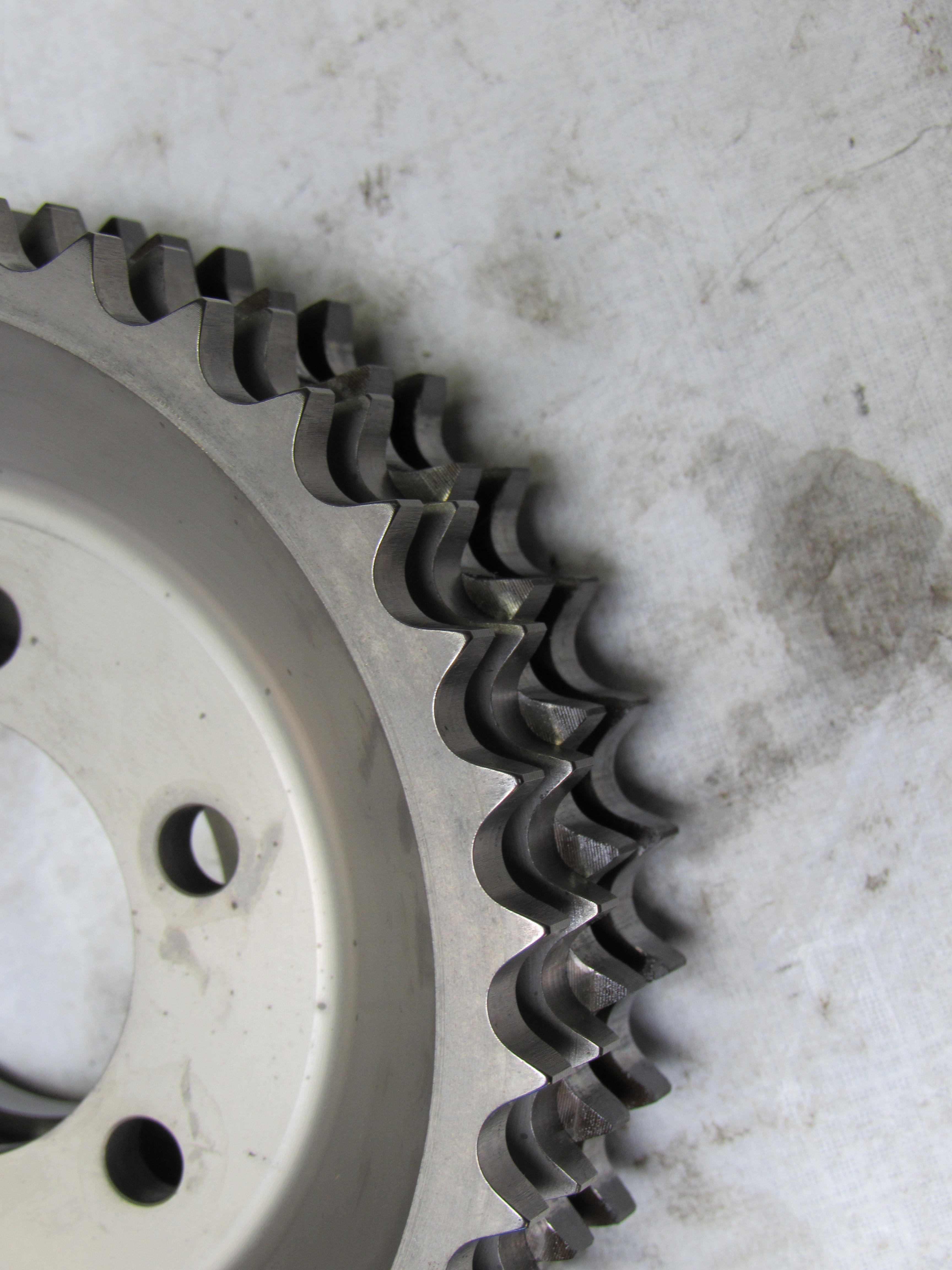

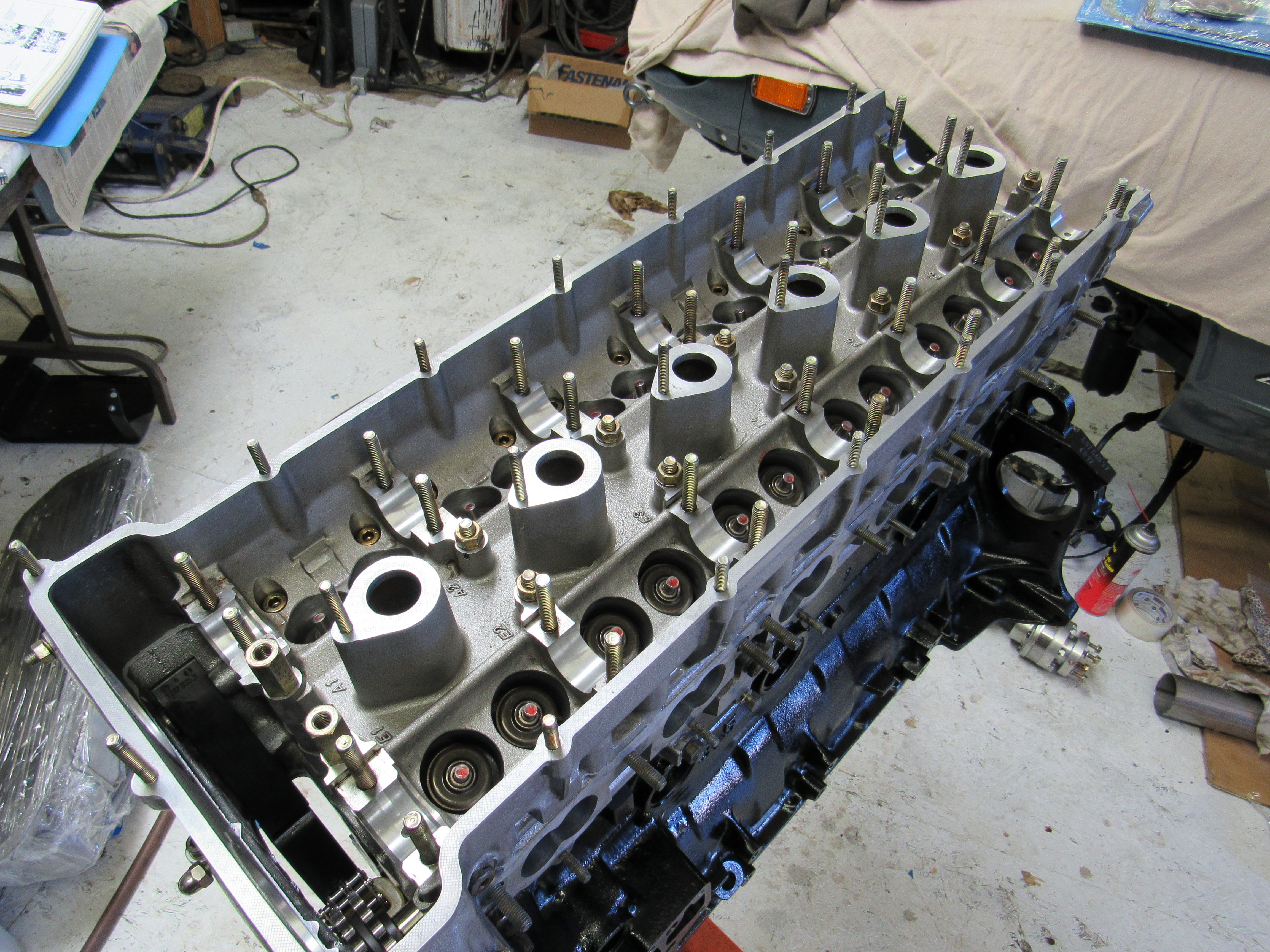

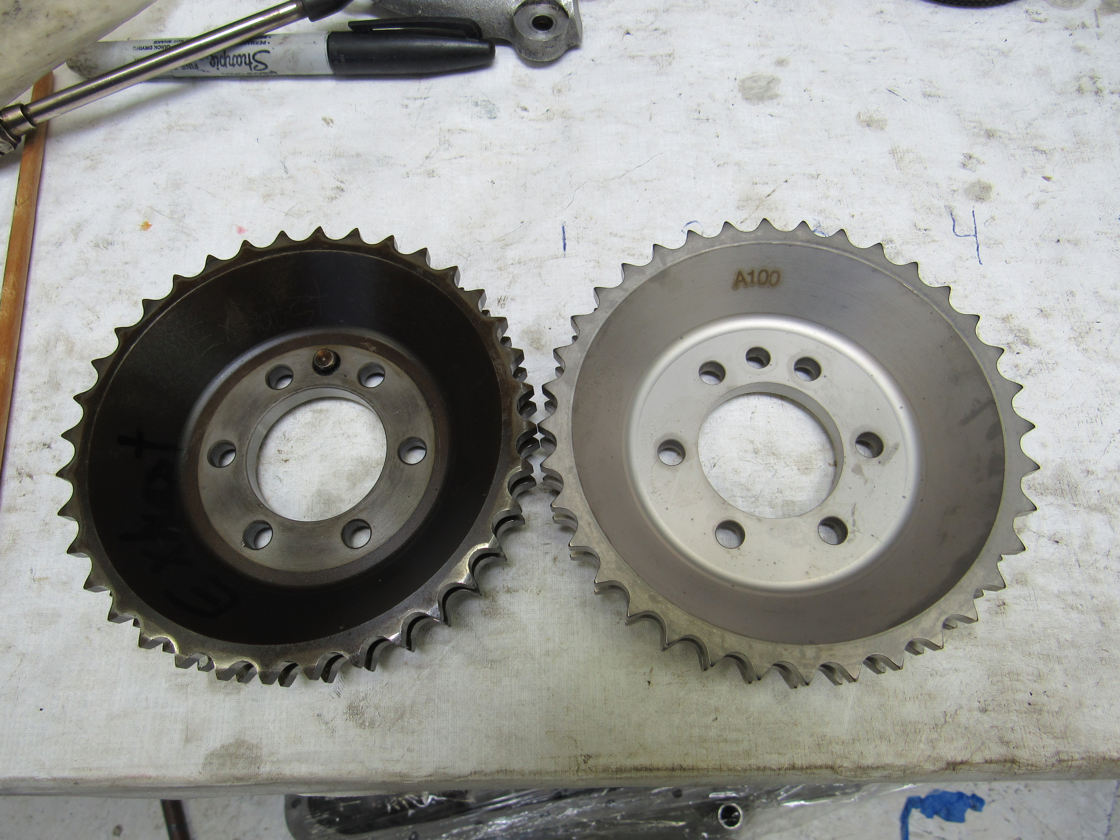

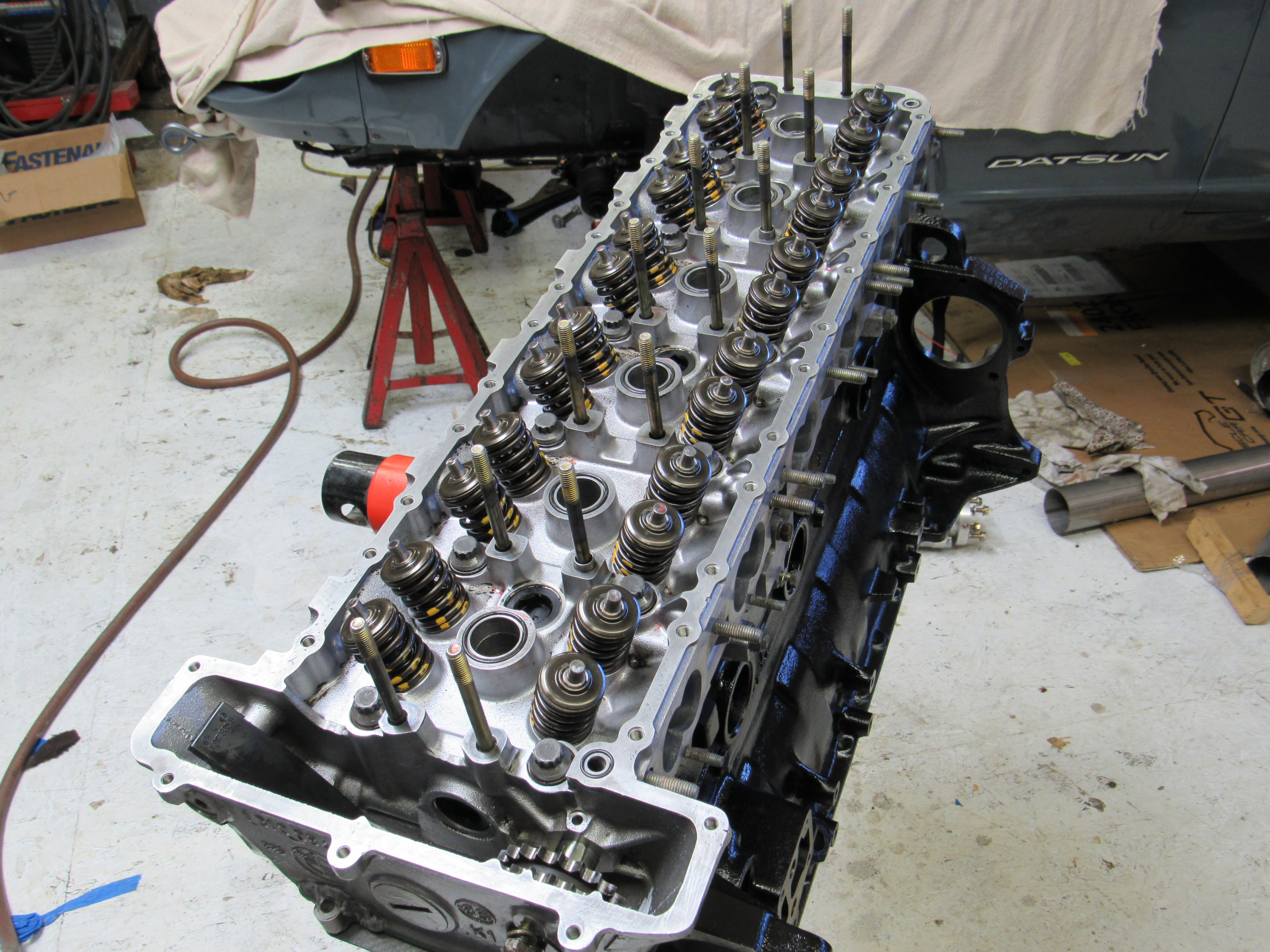

grannyknot Posted October 20, 2017 Author Share #600 Posted October 20, 2017 Got all of the threads chased and a new coat of paint on the block, a lot of reassembly done today, will start on the cams tomorrow. This is the exhaust EVO cam gear from the E30 M3, almost identical to the stock exhaust cam gear on my engine but it retards the opening and closing of the valves which is suppose to gain me another 22lbs of torque at 3000 rpm, I have been meaning to install one of these for years. Here is the offending, evil oil pump shim firmly bent into position. 2 Link to comment https://www.classiczcars.com/topic/50240-thinking-about-installing-an-bmw-m6-engine-in-my-z/?page=50#findComment-532845 Share on other sites More sharing options...
