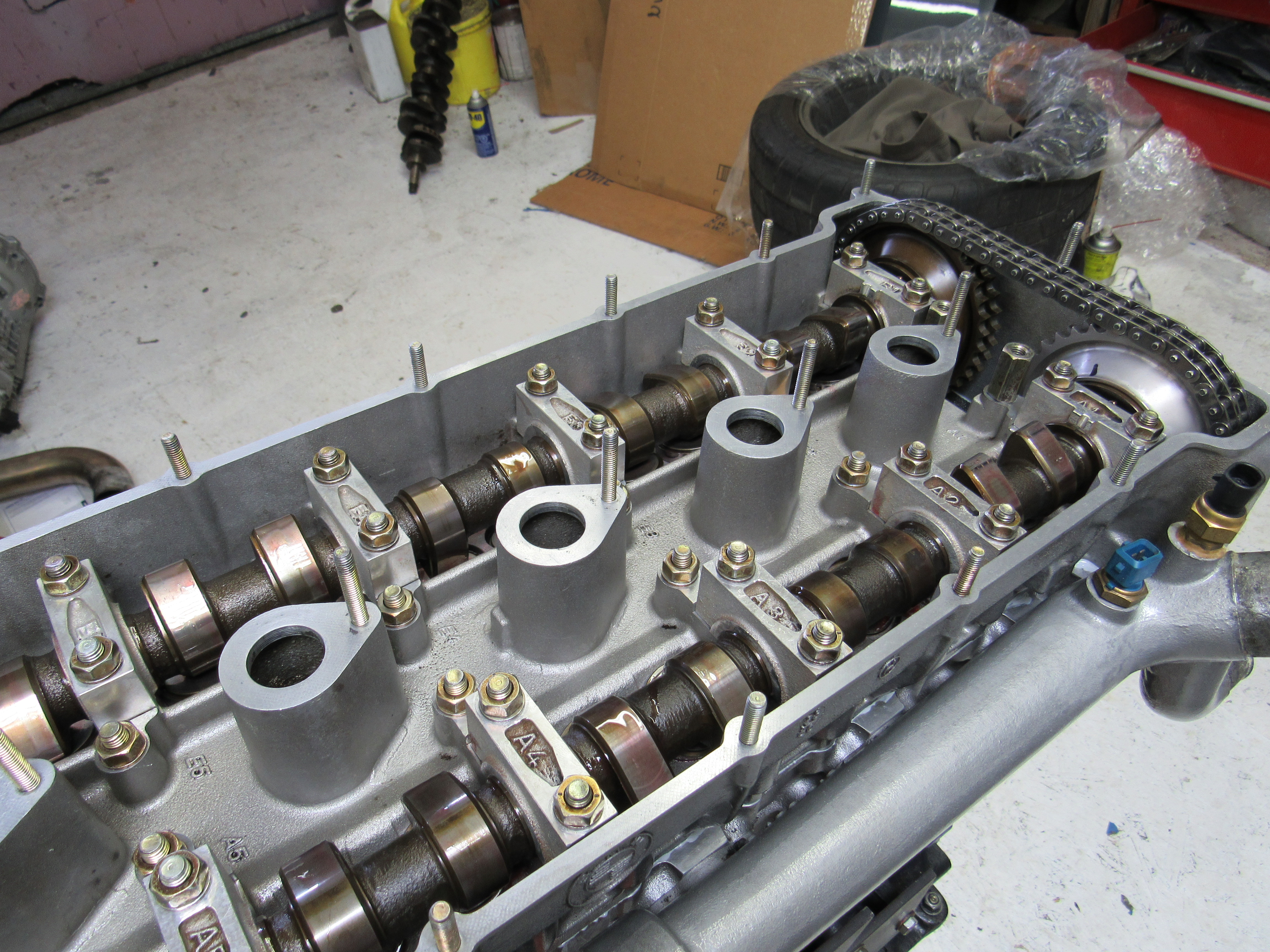

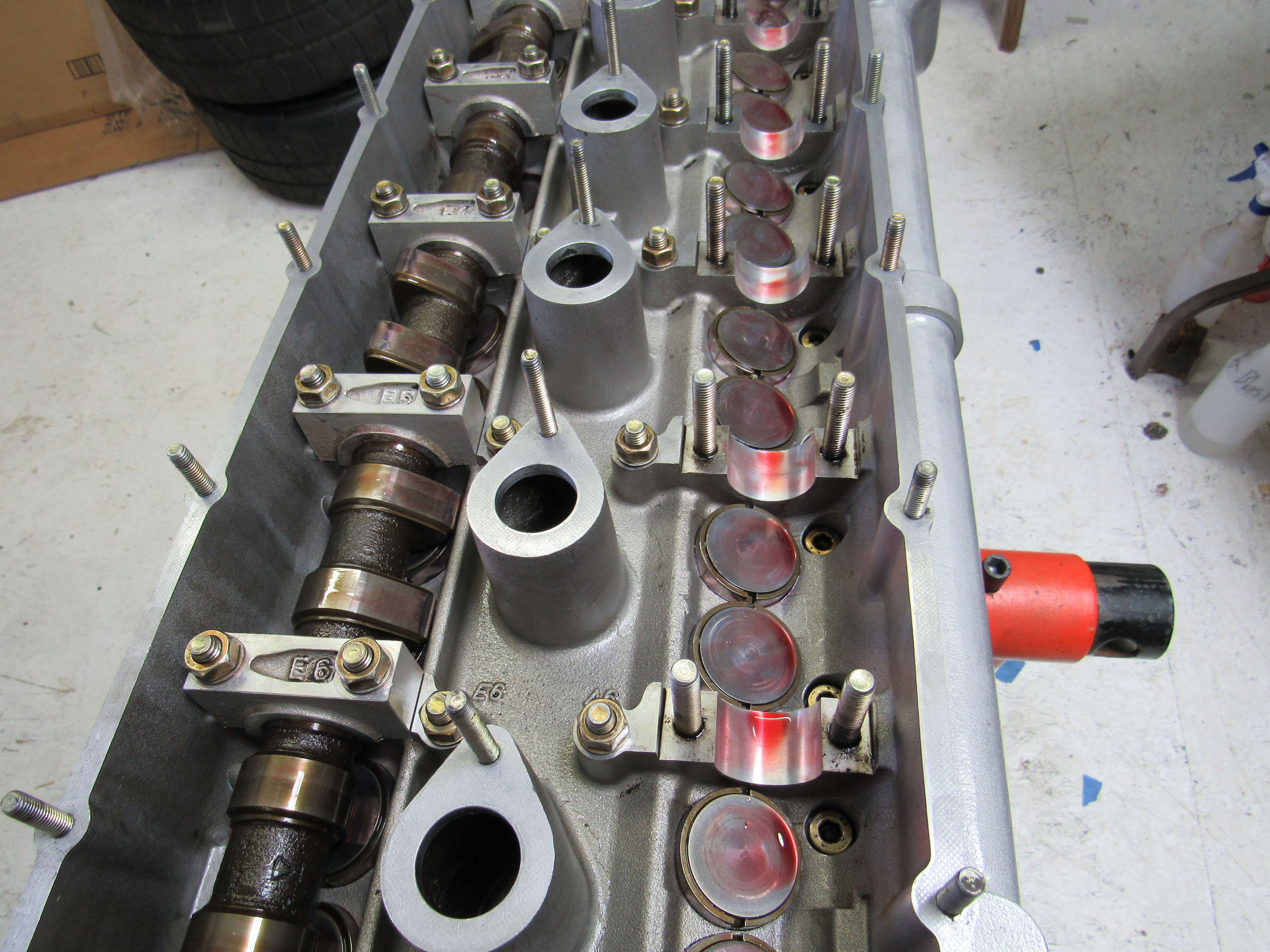

grannyknot Posted October 21, 2017 Author Share #602 Posted October 21, 2017 8 hours ago, Captain Obvious said: Beautiful. Let's not go through that again!! Amen brother. Installed the cams and timing set today, just have to get the flywheel, clutch and transmission on and I can start dropping it back in the car, with any luck I can get it on the road before they start laying down salt. 1 Link to comment https://www.classiczcars.com/topic/50240-thinking-about-installing-an-bmw-m6-engine-in-my-z/?page=51#findComment-532915 Share on other sites More sharing options...

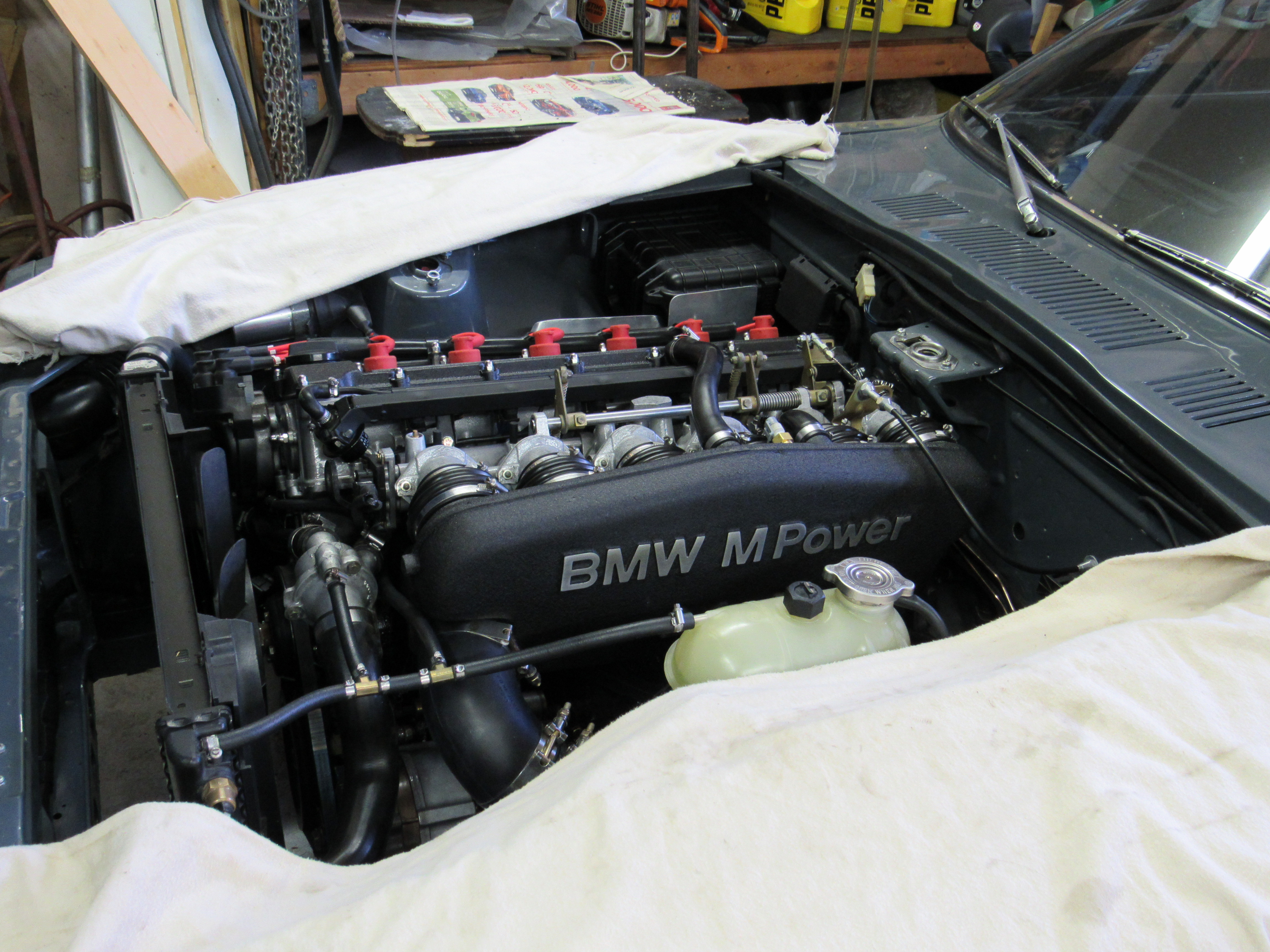

grannyknot Posted October 23, 2017 Author Share #604 Posted October 23, 2017 Got the engine buttoned up and back where it belongs, 3-4 days away. 1 Link to comment https://www.classiczcars.com/topic/50240-thinking-about-installing-an-bmw-m6-engine-in-my-z/?page=51#findComment-533078 Share on other sites More sharing options...

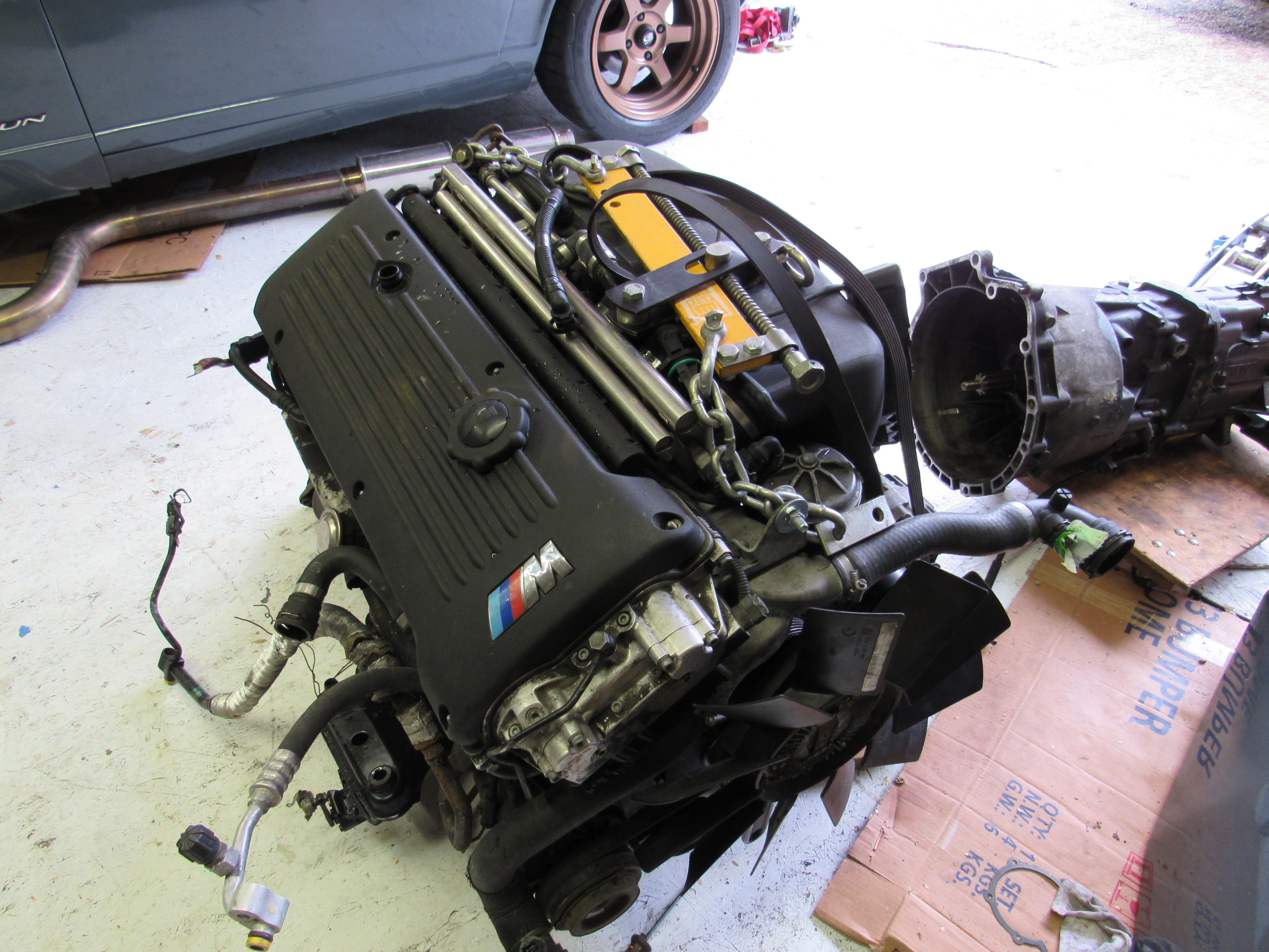

grannyknot Posted November 3, 2017 Author Share #607 Posted November 3, 2017 On 10/23/2017 at 6:31 PM, grannyknot said: 3-4 days away. Yeah, right. Everything that could suck away my spare time happened since my last post, but she's done, on the road again! Took it for a spin today and everything feels good, I guess I'll have to observe some kind of a break in period. I got such a smoking deal on this new toy I couldn't pass it up, not sure what I'm going to do with it just yet, but I'm sure it will end up in a Z at some point. This is an S54 M engine 2001 - 2006, the last of the big straight sixes from bmw before they started slapping turbos on everything. 3.2L, cast iron block, aluminum head, DOHC, 24 valve, variable valve timing, 10.5:1 compression, 8000 rpm red line, without the cats 343hp without any tweaks. Best of all it is 3.5" shorter than the S38 engine and has a rear mounted sump so installation would be a breeze compared to the S38. It came with a 6 speed manual trans, engine wiring harness and ECU. Something to play with this winter 2 Link to comment https://www.classiczcars.com/topic/50240-thinking-about-installing-an-bmw-m6-engine-in-my-z/?page=51#findComment-534072 Share on other sites More sharing options...

Namerow Posted November 4, 2017 Share #611 Posted November 4, 2017 13 hours ago, grannyknot said: 3.2L, cast iron block, aluminum head, DOHC, 24 valve, variable valve timing, 10.5:1 compression, 8000 rpm red line, without the cats 343hp without any tweaks. Best of all it is 3.5" shorter than the S38 engine and has a rear mounted sump so installation would be a breeze compared to the S38. It came with a 6 speed manual trans, engine wiring harness and ECU. Would that fit in a P1800? Link to comment https://www.classiczcars.com/topic/50240-thinking-about-installing-an-bmw-m6-engine-in-my-z/?page=51#findComment-534105 Share on other sites More sharing options...
