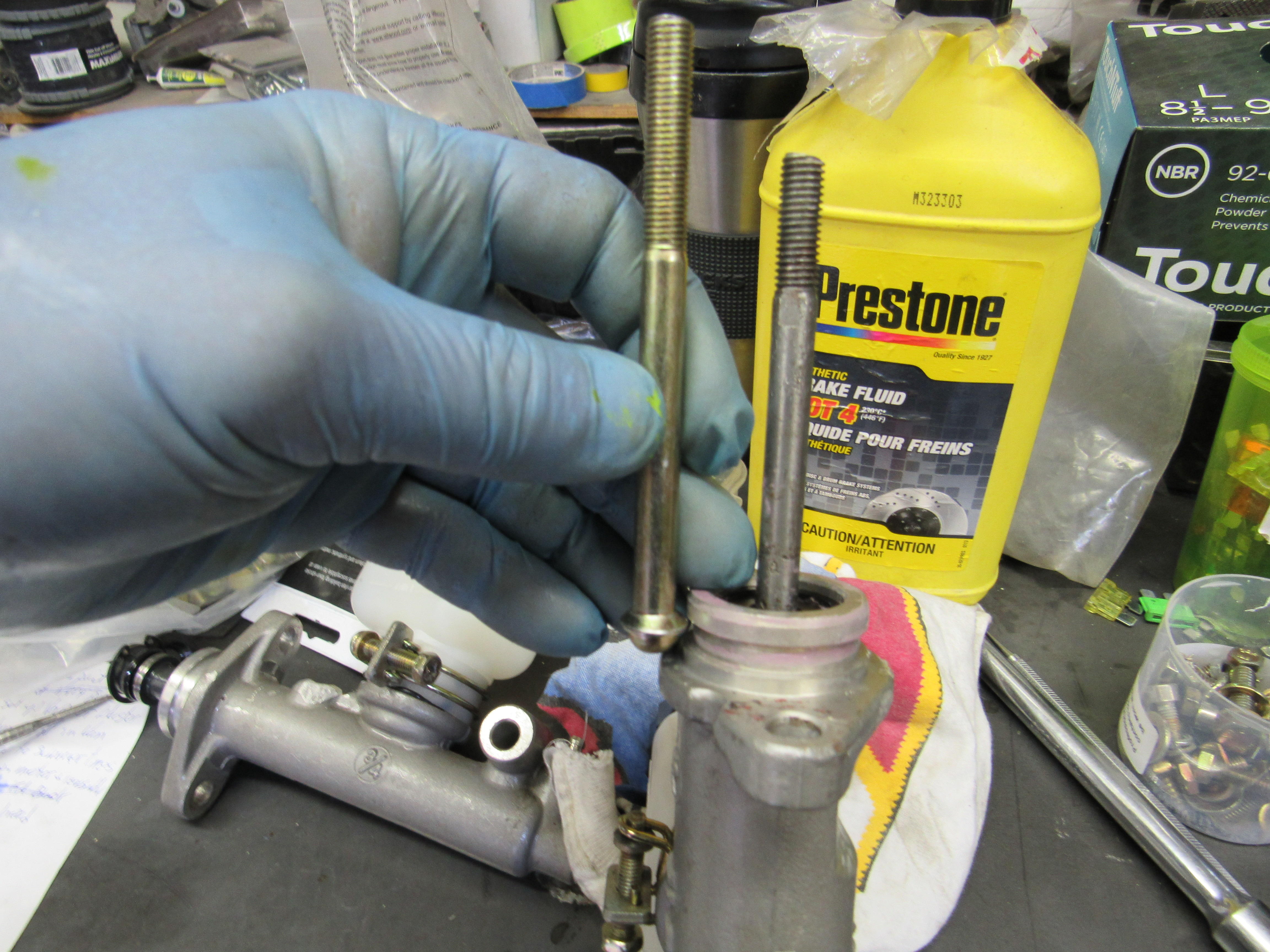

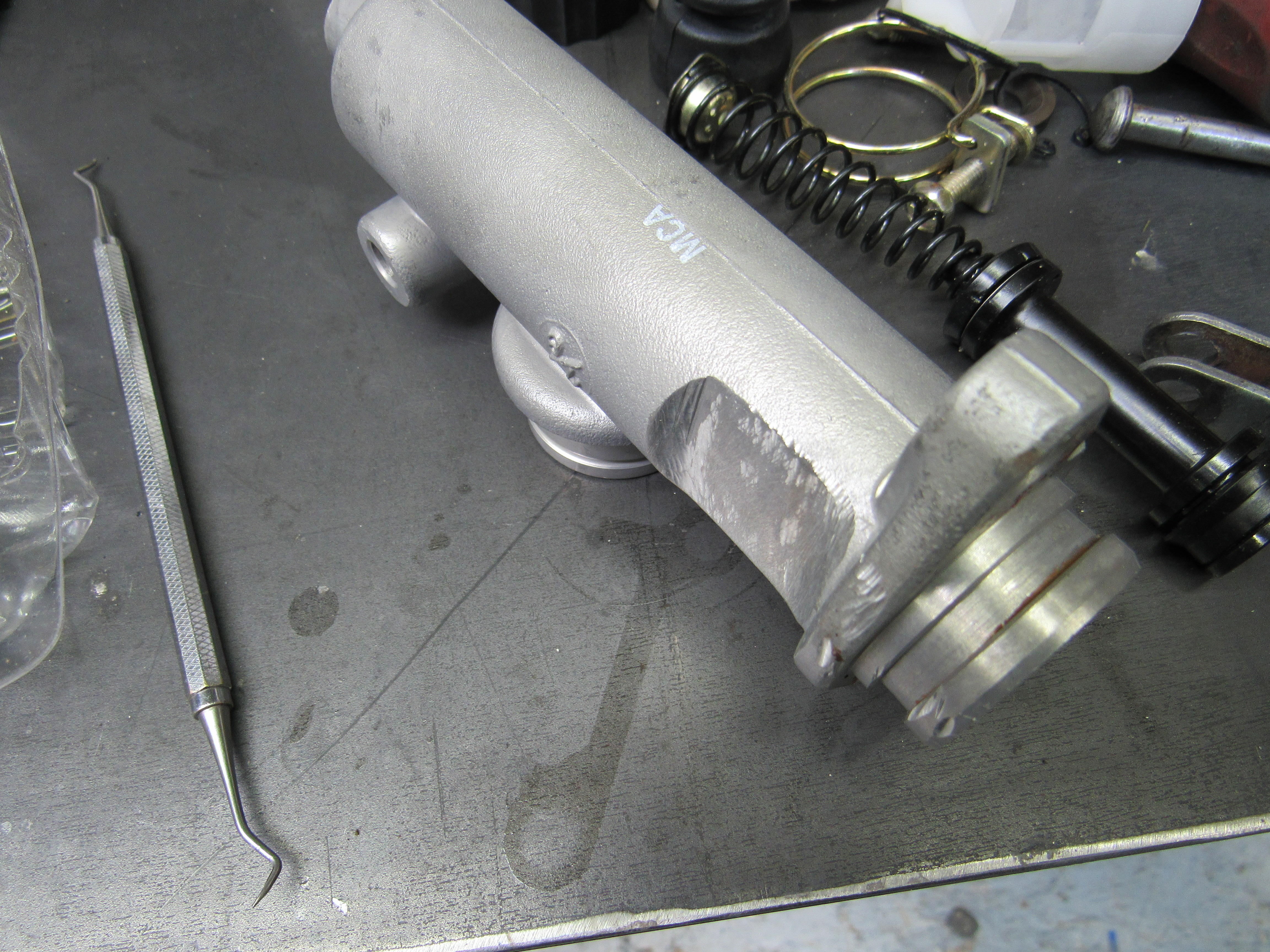

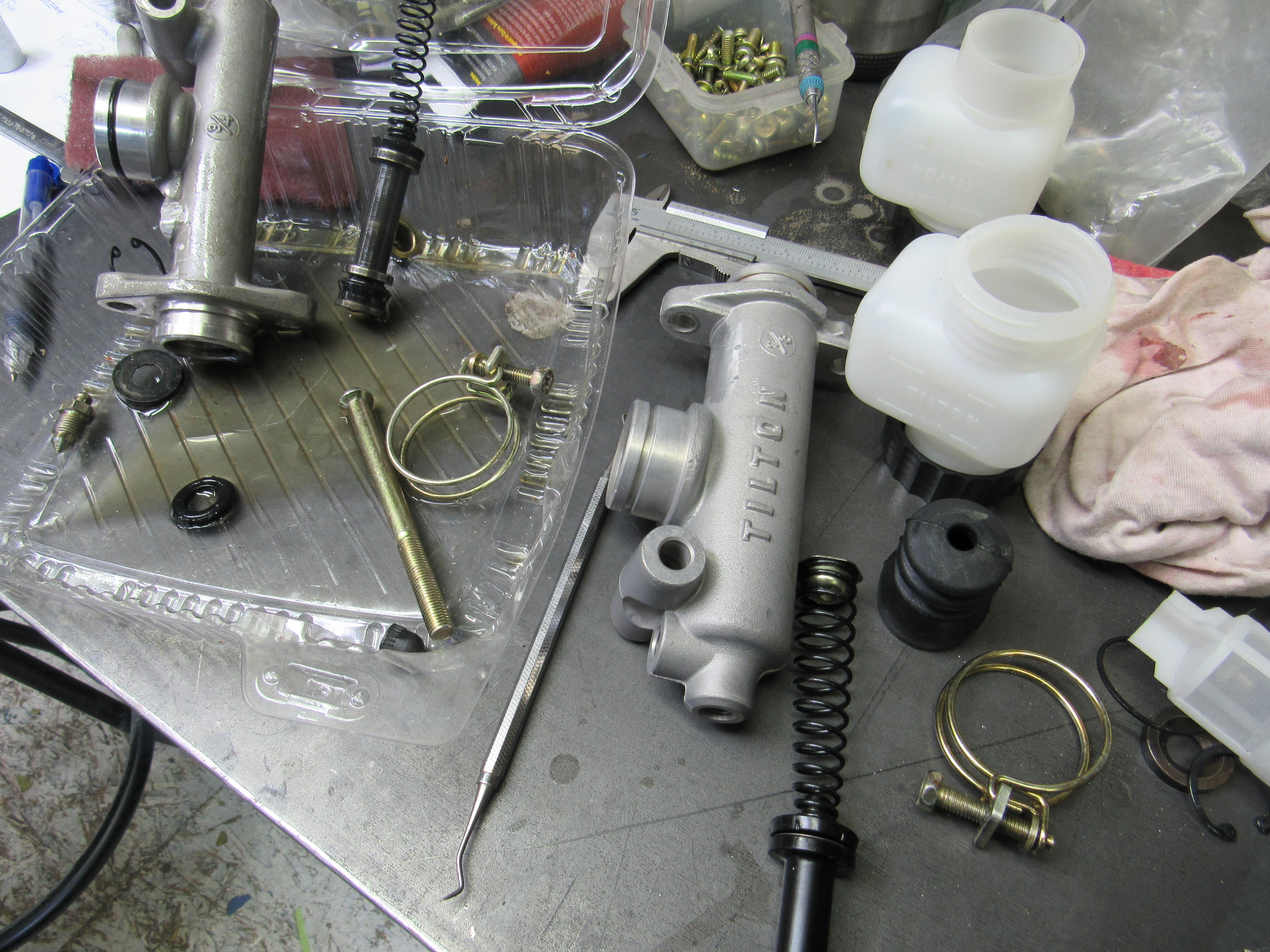

Well this clutch problem has me stumped, I removed the Nissan 3/4" and installed a new 7/8" clutch MC, bled almost a litre of fluid through the system from both ends so I know there is no air in the lines. The slave is used but I took it apart and it is working fine, but the clutch pedal goes to the floor with no more resistance that the return spring and it still won't go into gear when the engine is running.  I hate to even think it but I may have to drop the transmission:cry:

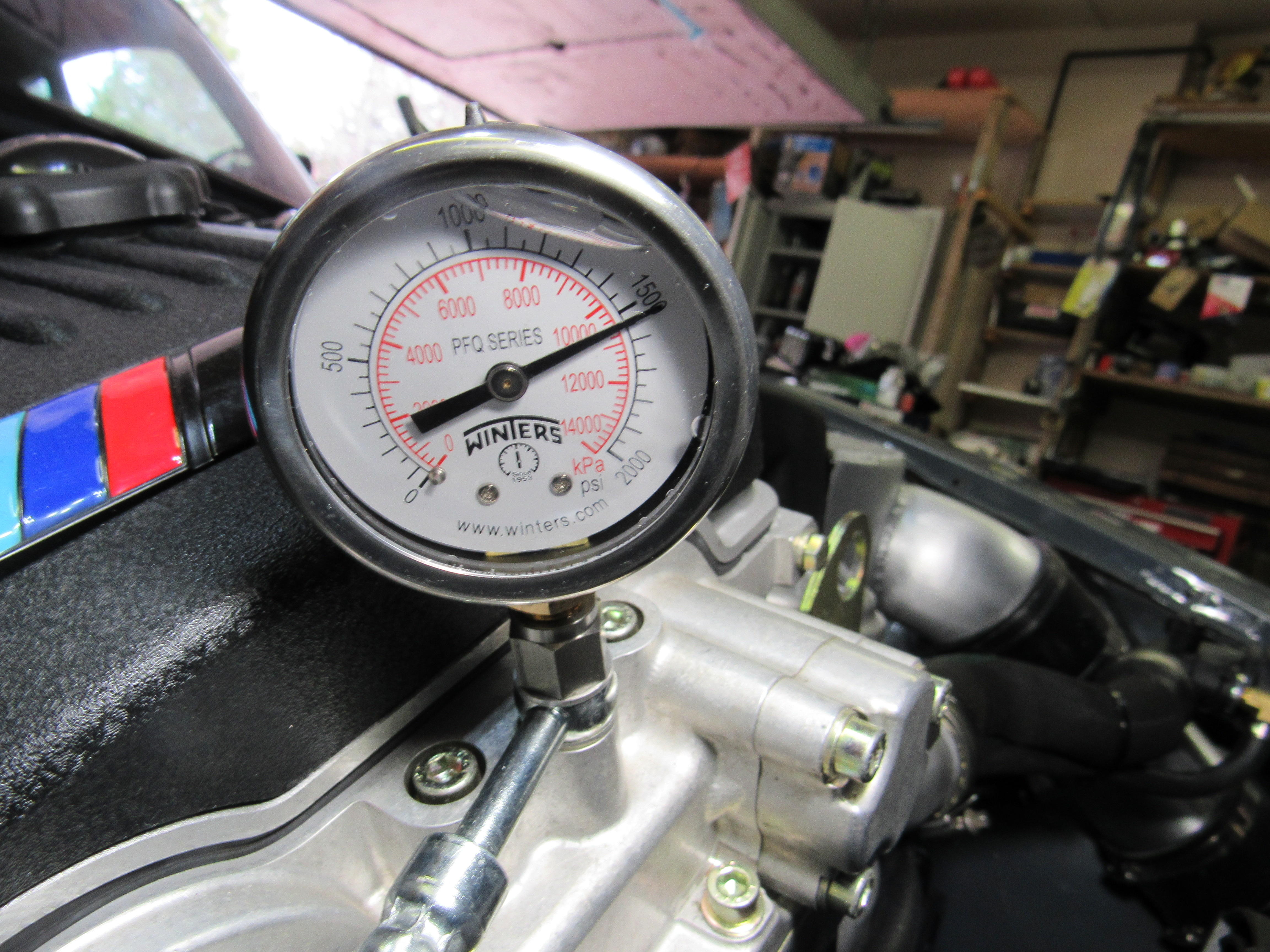

At least the variable valve timing oil pressure is right where it should be.

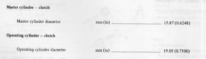

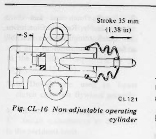

I'm learning a lot about Nissan clutches.  I had assumed that the cylinders would be the same diameter but apparently they're not. ( Edit - they just put it in a different spot, it's there.)  Says 35 mm...

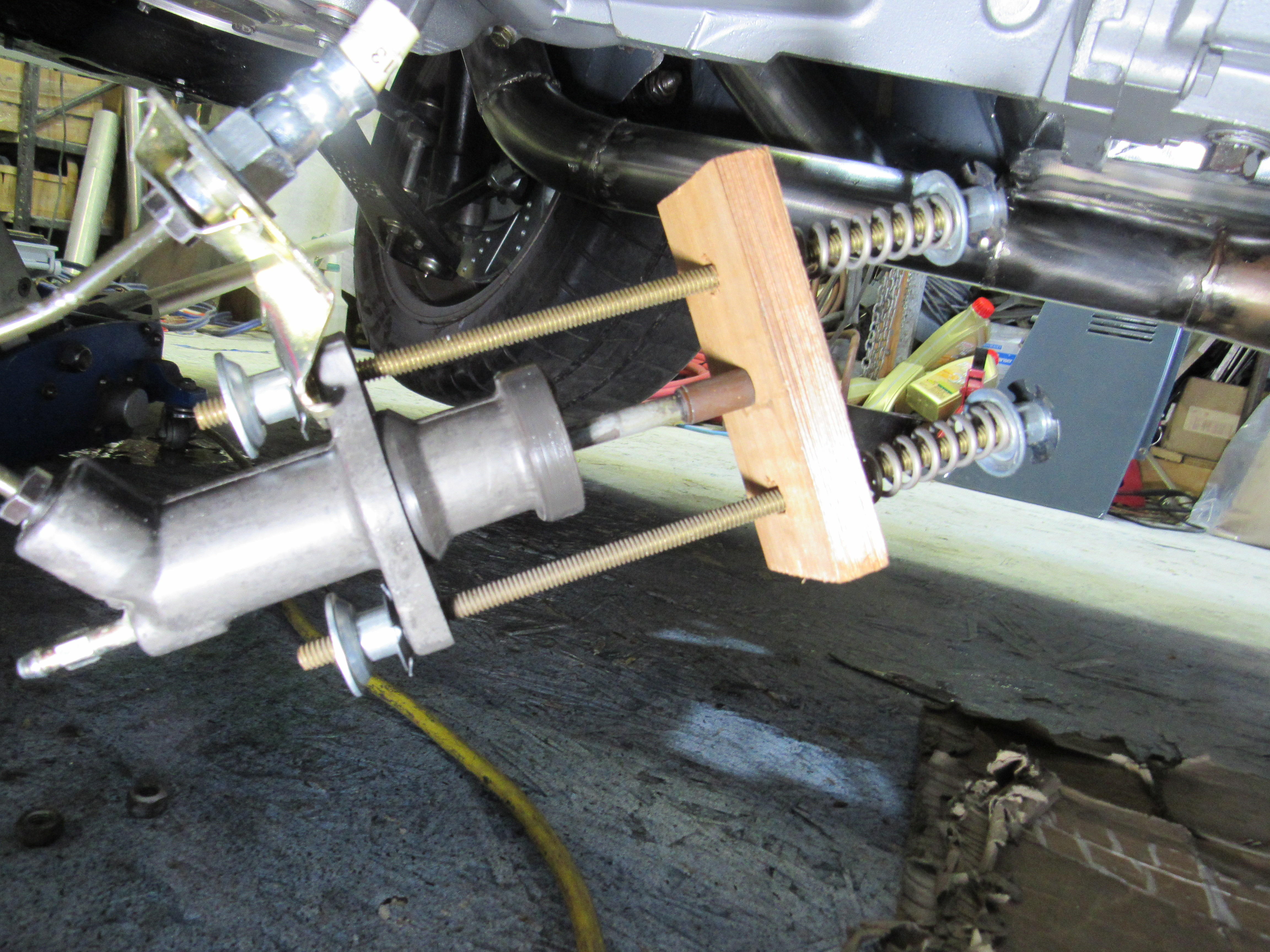

It occurred to me this morning that I had installed the Nissan adjustable push rod instead of the Tilton rod, so pulled that and exchanged them, filled and bled it all again and with a little contraption I made measured the max travel of the  bmw slave, 16mm, I set it to that and started the car and it still won't go into gear. Chas I took your advice and started the car 6th gear a couple of times but it didn't help.

16 mm is only half the stroke that Nissan shows.  That bigger master might be worth a shot.
Any way to rig up a mechanical way to push the fork?  I don't know what BMW uses to move their pressure plate, is it a typical clutch fork?  Moving the fork would tell you if it's a hydraulics problem or a mechanical problem.
