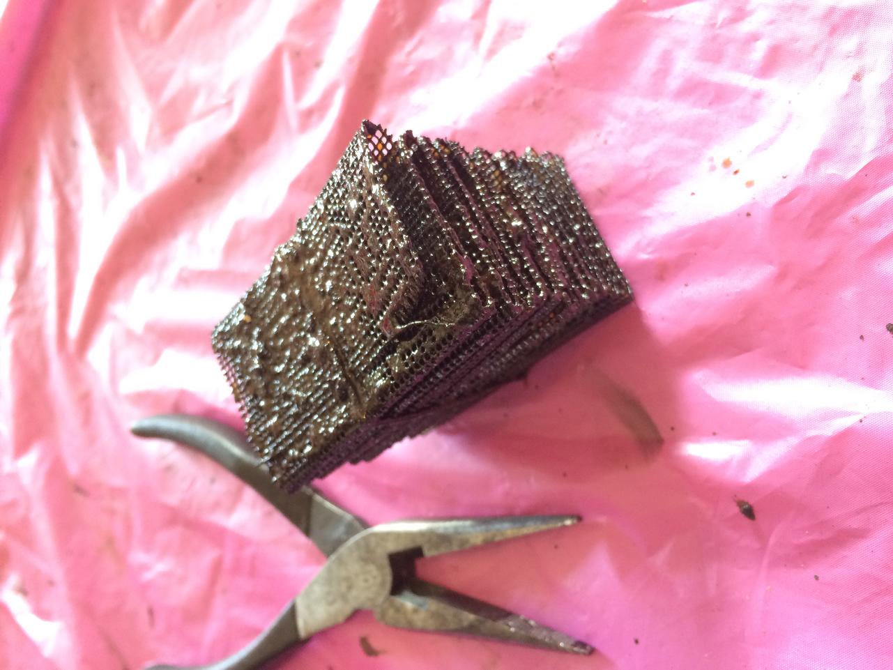

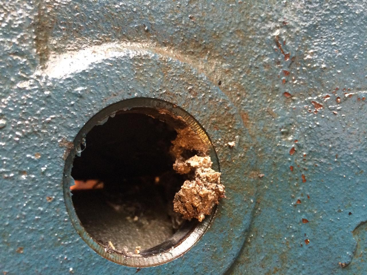

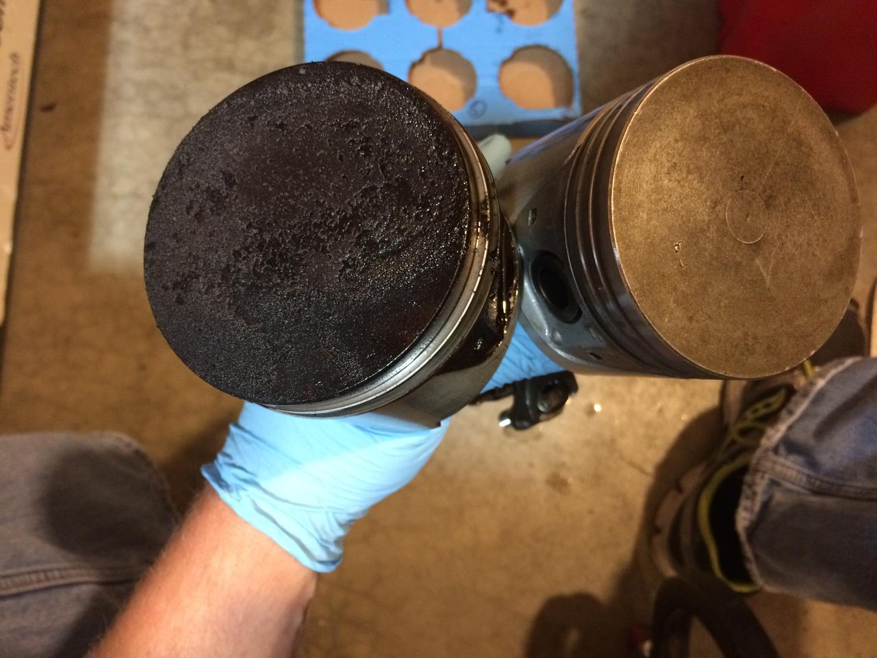

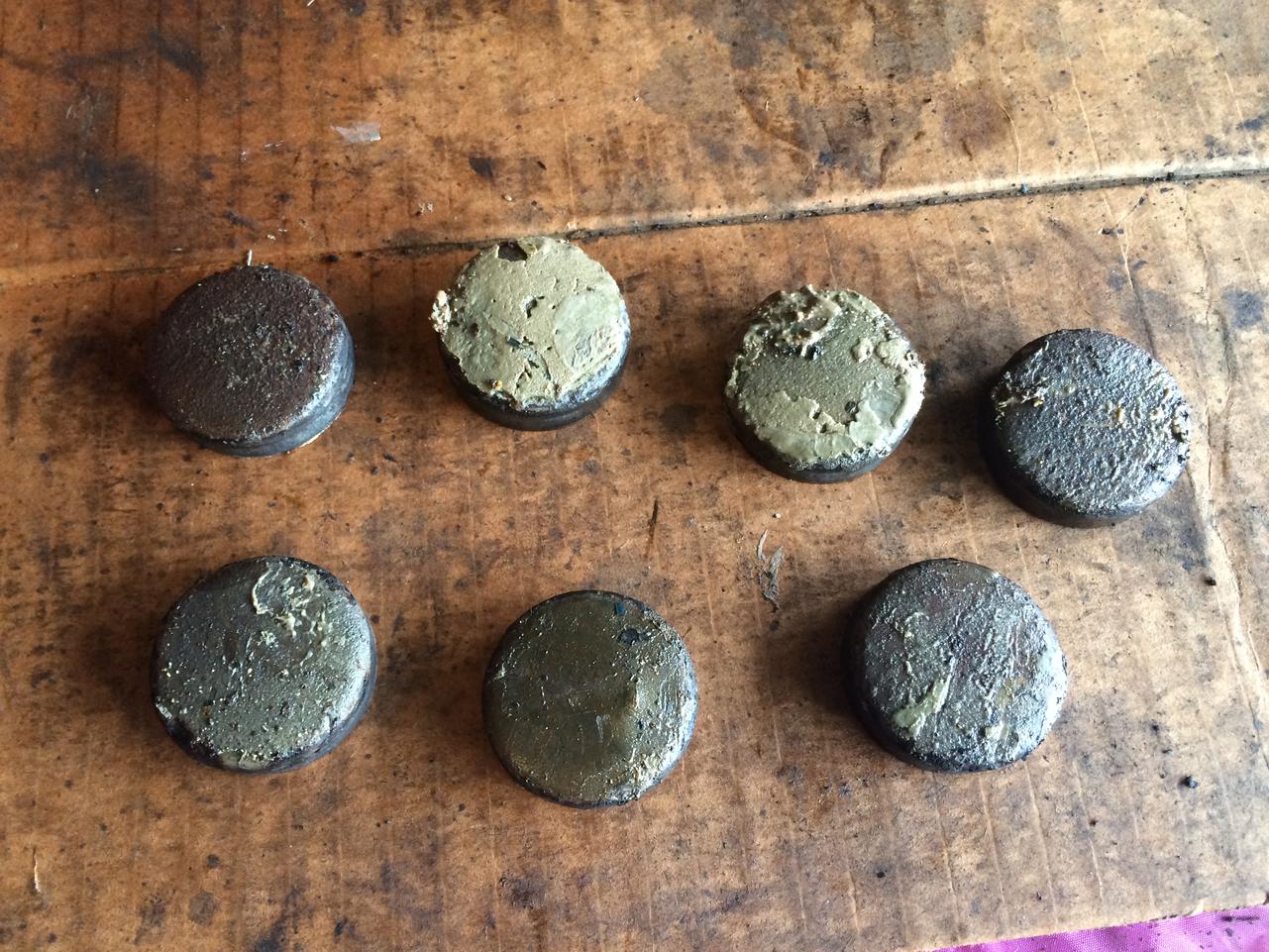

Also, you never know what you're going to find once you crack open the engine. Look at some of the grim and sludge that I found in my 1972 240z (one owner car w/ 104k miles)...bigger mess = more time & more $$
Dave's 1972 Datsun 240z: Engine Rebuild: Part 2: Engine Tear Down
