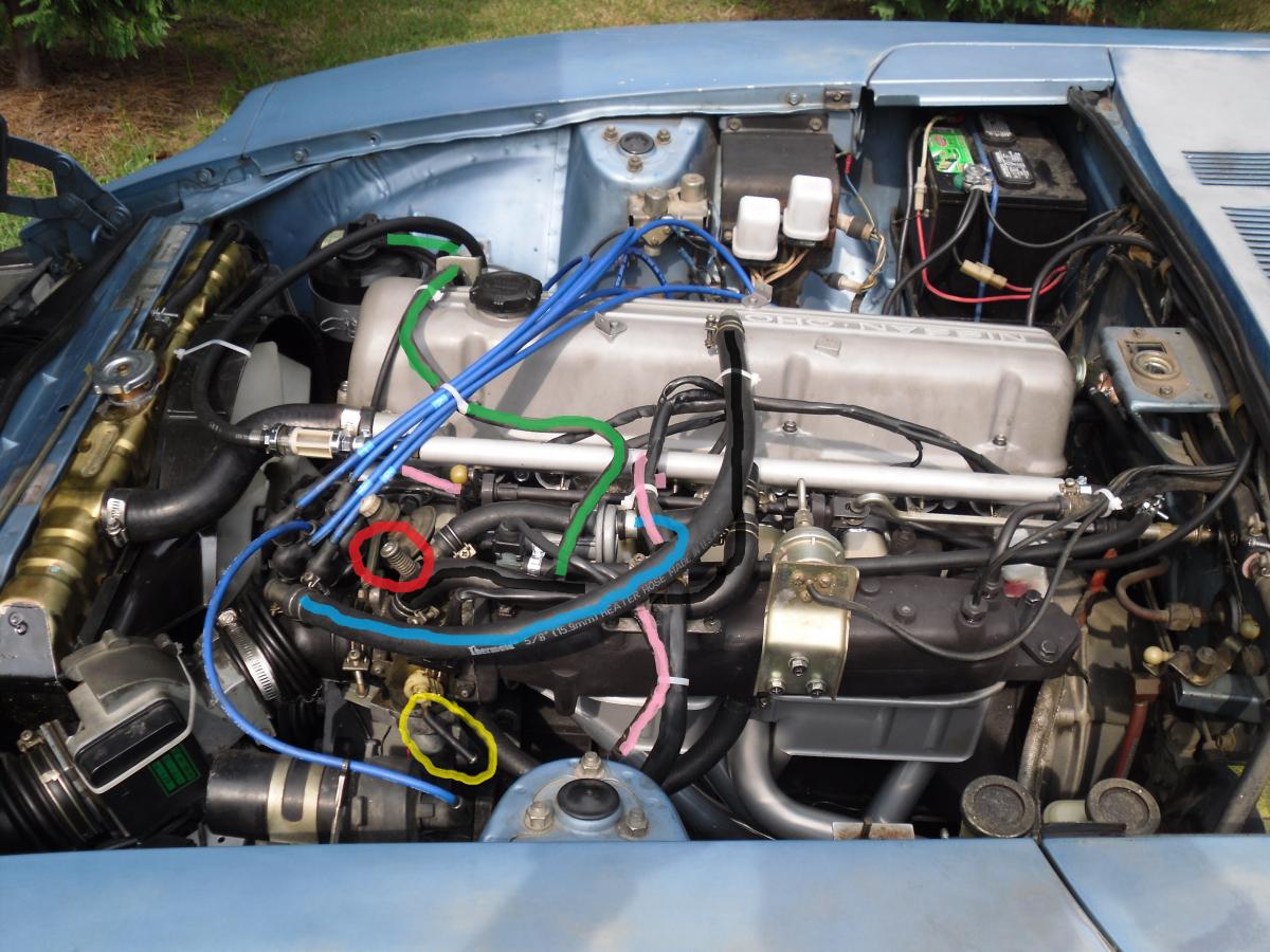

Seems like when I deleted mine there was a small hose going to the BPT valve? then from there
to the side of the throttle body, driver's side.  I had to plug that at the throttle body.
Yellow circle in the attachment.

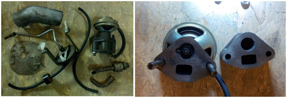

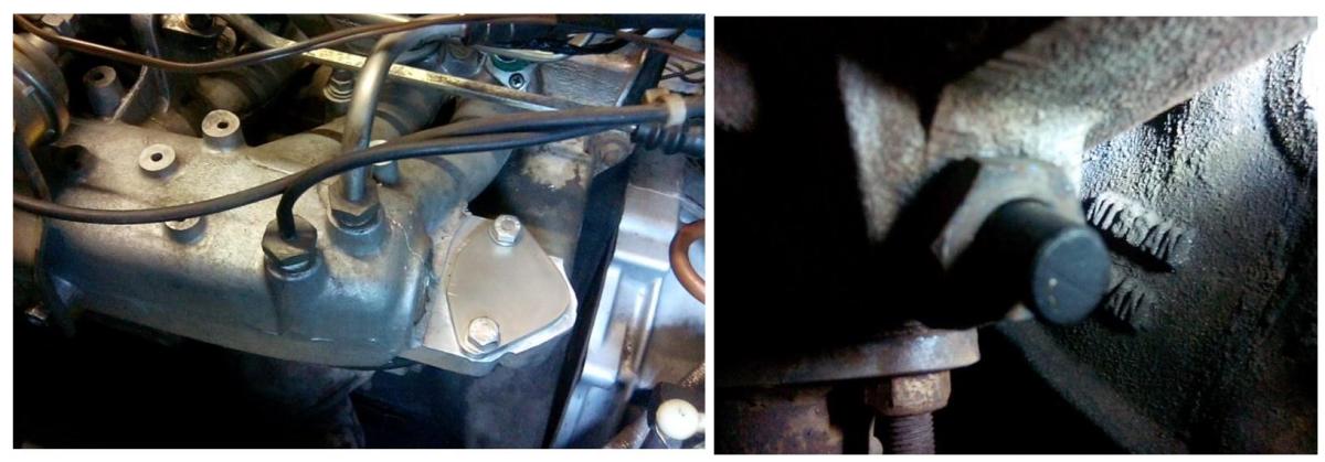

i originally made a plate out of some 1/4" aluminum and just bolted it on & plugged the odd tubes going to it - then wound up completely restoring the manifold so while i was at it i cut off the extension and plugged it all up permanently.
the exhaust gas recirculation system essentially allows unburnt fuel in the exhaust to pass from the exhaust manifold back into the intake for improved emissions. the egr valve is vacuum controlled, and when working correctly the recirculation occurs in a controlled manner that should not affect performance one way or the other. removal of the system, while allowing a little more unburnt fuel to pass out the tailpipe, doesn't add performance - it just cleans up the manifold area and eliminates a couple more potential vacuum and exhaust leak areas (my main reason for removal).
As Patcon said, you can easily make a new pipe. The end that goes into the exhaust manifold has a compression bead to seal it. The other end, as shown in your photo, has a flare. Both easy to deal with. Replacing the pipe is likely easier than eleminating the EGR system, but elemination of the EGR is fine if you do not need to have periodic inspections.
