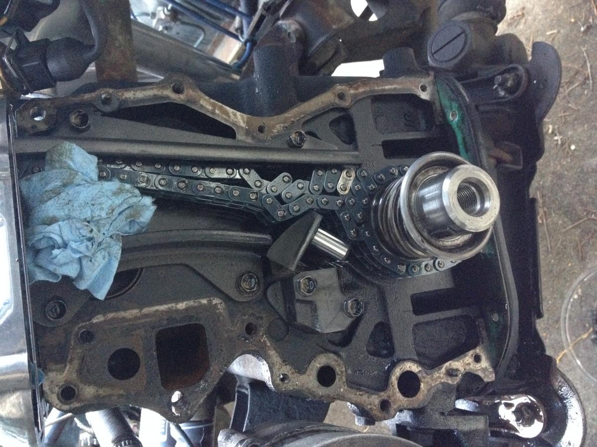

At least you caught it before you went for a drive. Didn't you get some number of miles on the car last time before you realized the tensioner was out of place? This way, at least you'll know that you've got everything into correct position before you button it up.
yes, last time the cam tensioner had fallen all the way out of it's cylinder and was sideways when i got the chain on, and when i turned started her up the nose of the tensioner sheared off the shaft and the parts fell into the bottom of the timing cover. i believe the only reason this was able to occur is because the timing chain was worn enough to have slack that would allow the tensioner to be where it was and still get the cam gear on. i have a new chain now so there's no extra slack and the cam gear isn't even close to getting on without the tensioner in place.

front cover off, straightened out the jacked up spring on the tensioner & re-installed, lined up the dots/bright links to time the cam, front cover & harmonic balancer back on, re-installed the head (again).
it got dark and cold, so i called it quits for the night. tomorrow i will re-install the oil pump and dizzy, radiator & fan, alternator, exhaust & intake manifolds, re-fill the cooling system and if there's time i'll do a cold lash adjustment and a final top end lube. then maybe she'll fire up, eh?
the chain tensioner did the nasty - again

 Kameari has a solution to avoid the little click, but their product is a little pricey.  A handy person could probably copy the concept to modify the stock parts.

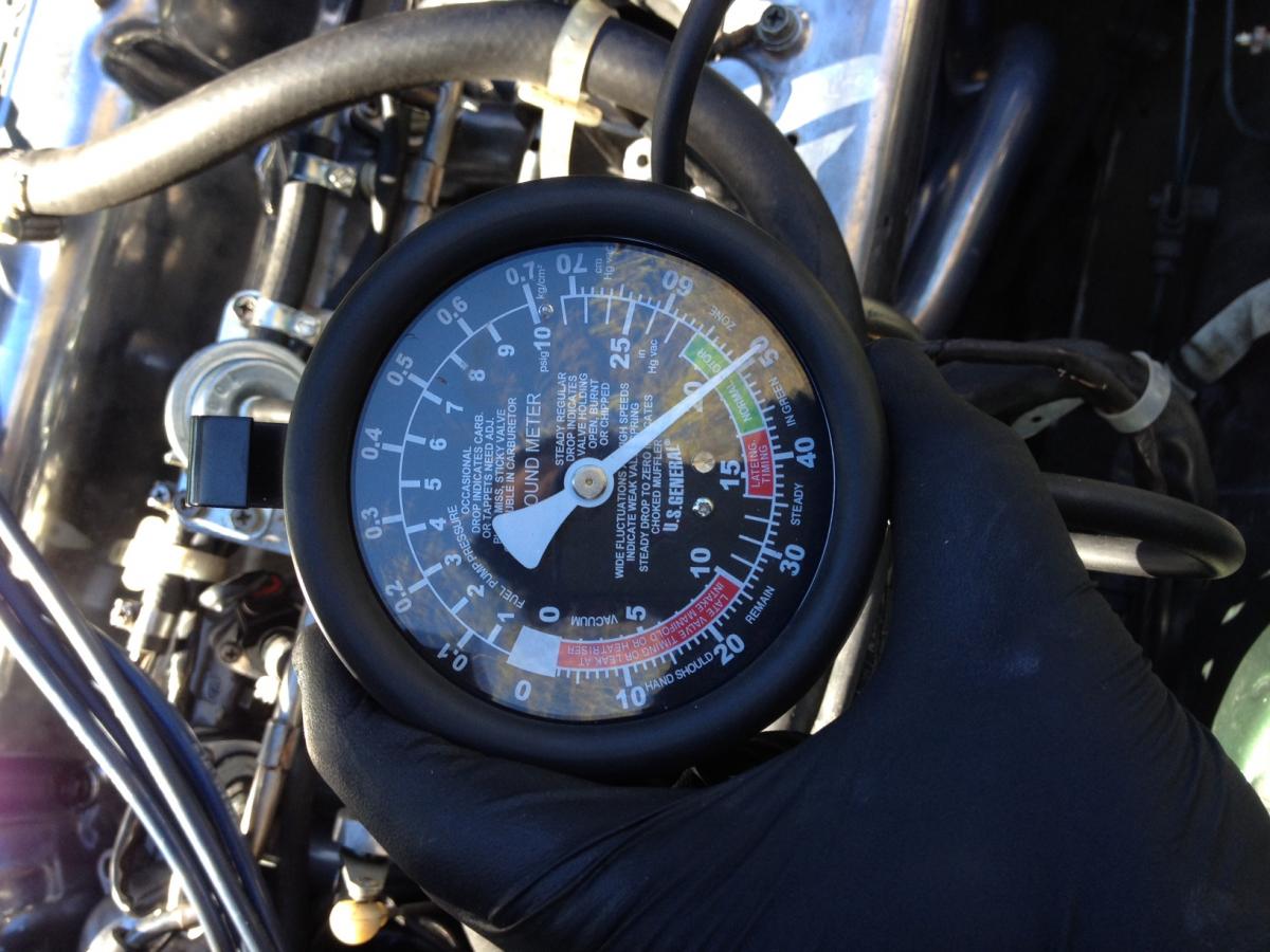

she fired right up and ran smooth as can be. once she was all warmed up i did a hot valve lash adjust, topped off coolant, set the dizzy timing, and just for kicks threw on the vacuum gauge and was amazed to finally see fantastic manifold vacuum! on another thread i posted how i've done everything under the sun trying to solve my low vacuum readings - replaced every hose, connection & associated mechanism, checked compression, played w/dizzy timing, but always had horrible readings. the car ran well enough, but i just bugged me that the vacuum was reading so low. now i believe that the rocker geometry affected my valve timing.

Manifold vacuum looks great,(better than mine) now that you have a well sealed top end & without the overlap of the other cam.
