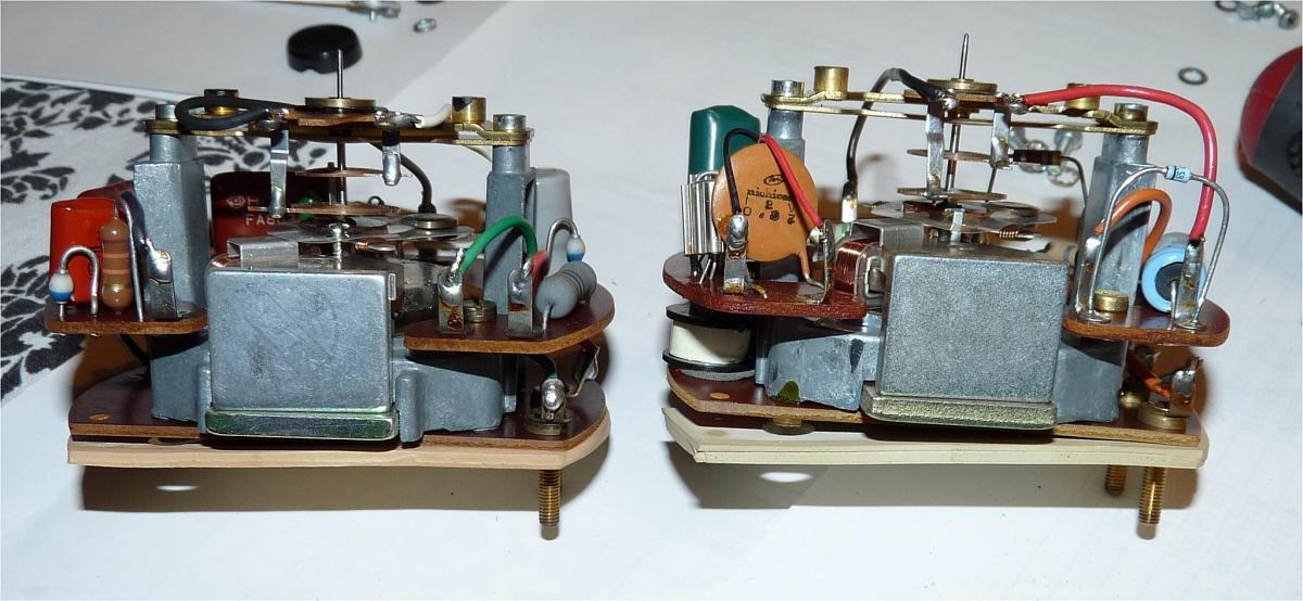

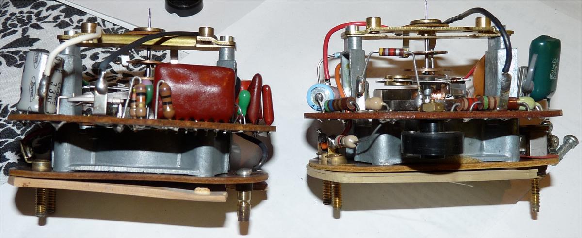

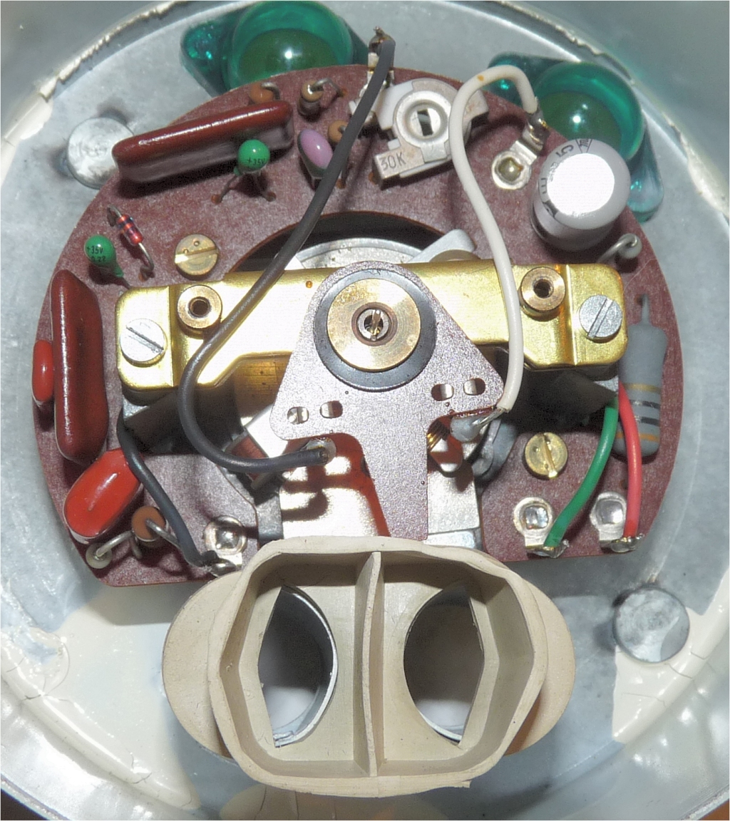

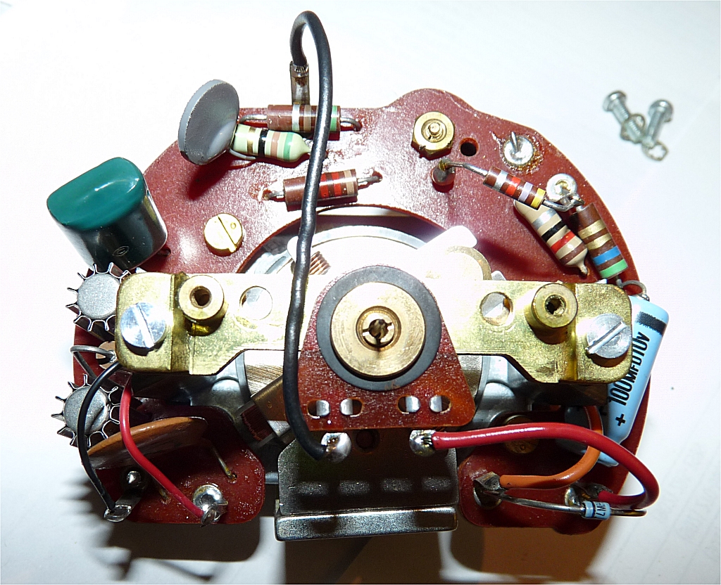

Below is a 280z tach module on left and 240z tach module on the right.
The adjuster is at ~ 12:30 "o'clock".
You can access it from the back of the tach's "can" enclosure.  The access hole is between the two lamps.
post-6852-0-13044500-1417195501_thumb.jp
post-6852-0-26987100-1417195509_thumb.jp
