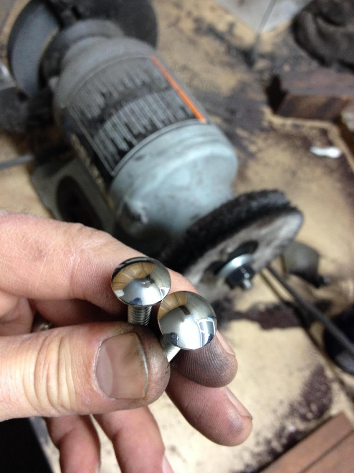

i used a set of sst carriage bolts from a local seattle hardware store known for having a pretty good fastener selection - they are 1/4" and while a little loose, they did just fine. i also got a set of nylock nuts and sst fender washers to spread the load and minimize dimpling of the chrome. the chrome bolts were silly expensive, and the sst ones were .28 cents each. no brainer. 2 minutes on my polishing wheel and they rival the best chrome - and will never rust.

Those look great!  I tried the SS and some Mother's Aluminum Polish I had with a small polishing pad on my Dremel but never came close to that kind of shine.  I need a wheel on my bench grinder anyway so I'll try them again, all 4 bolts and nuts with washers was only $4 at Lowes.

yeah, a wheel on a grinder is the way to go - get some red and white polishing rouge (red for taking the surface smooth, white for the color/shine) and there'll have no end to the fun you'll have making things shiny! suddenly the ice cream scoop, that old belt buckle, the cheese slicer all become jewelry :)

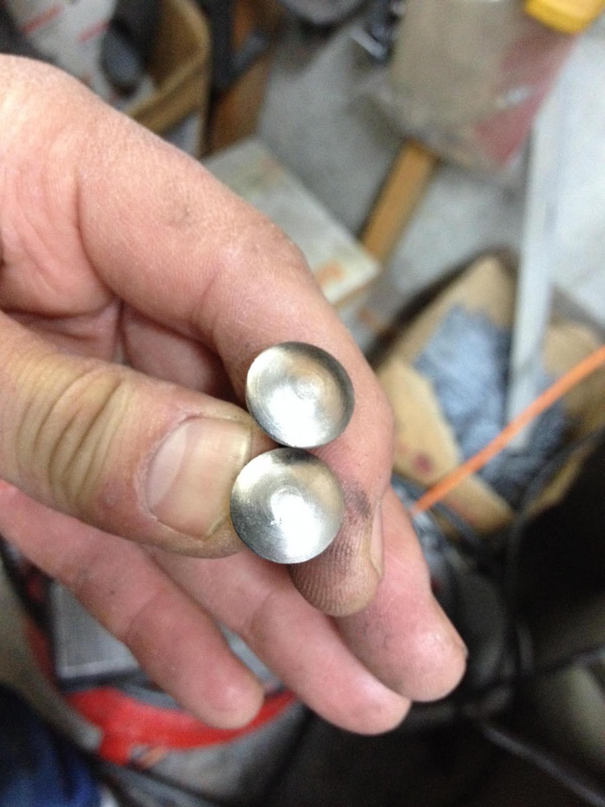

I did what you said and they came out good, enough for now.  Cheap arse "chinese junk rant" stainless bolts had some casting marks I couldn't get rid of but like I said they look OK for now.

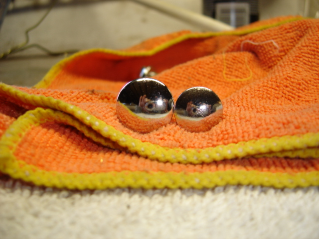

The 5/16" chrome ones from Jegs vs the right size 1/4" stainless after polishing:

polishing is like that - the more shine, the more flaws you discover.
if you want a real perfect finish, take out the casting marks with a fine file, then sandpaper starting with 220 and move up to 600 or 1000 then hit the polish wheel with red, then finish with white. you will get a mirror finish if you want.
