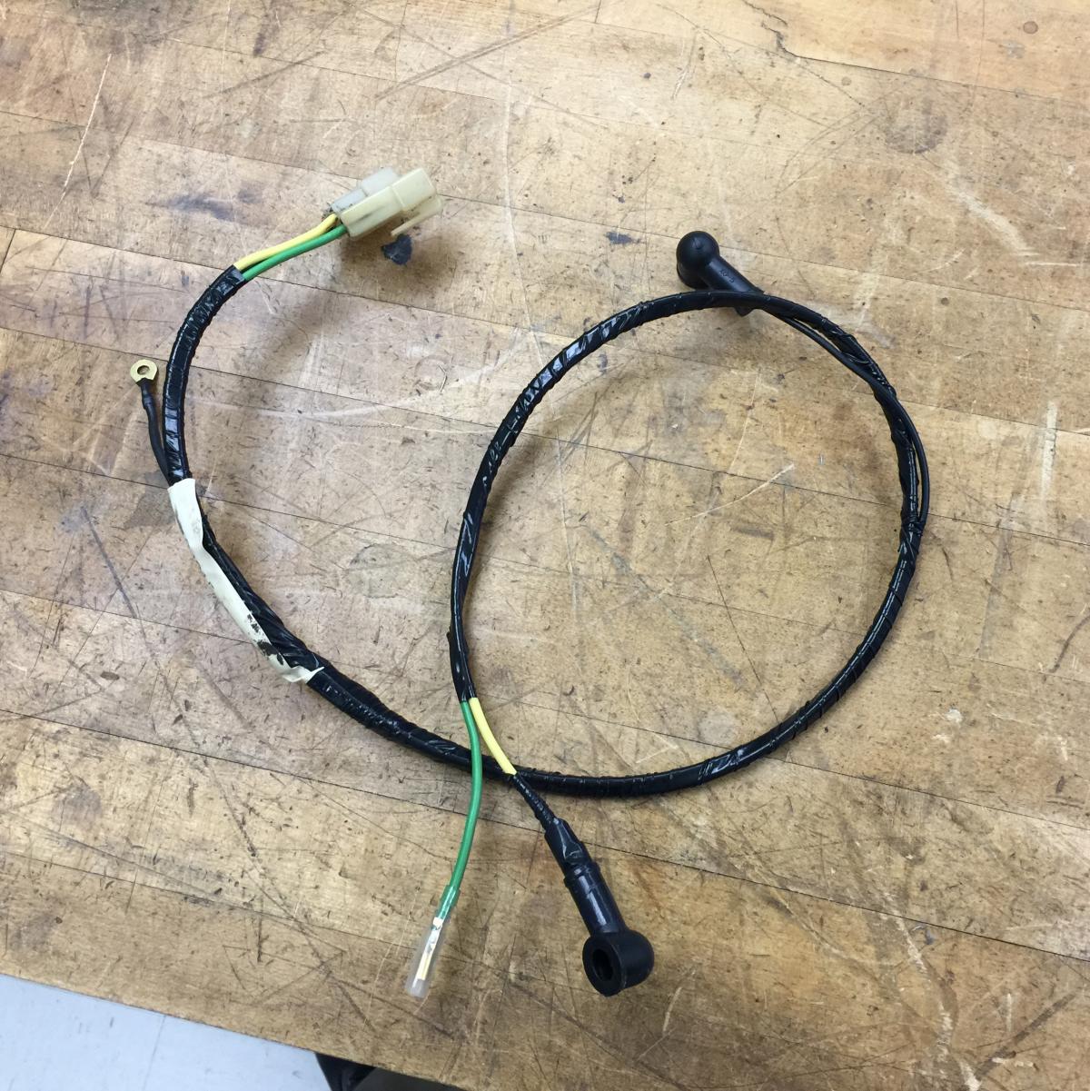

Can you guys clarify the purpose of the green wire on this harness? For a fuel electric fuel pump connection? I think by default it is just taped to the harness and unused? (stock 71 240z)
For whatever reason, from the stock harness only the larger connector was attached to my fuel sender. An additional wire had been run down to attach to what I believe is the negative/ground terminal of the sender. This wire snakes into the car through a grommet and through the interior of the car under the carpets to somewhere in the front (I had assumed to a ground somewhere).  Not sure why this was done, maybe the wire was faulty and that was the solution to replace it. I haven't fully traced where the wire went, but I don't plan to reuse it. The grommet it enters the car through is very close to the connector it originates from. (under the rear deck carpet in the rear passengers side section) Maybe the connector wasn't visible though because its hidden behind the rear trim panel, that could explain it.
Assuming I am using OEM fuel sender, mechanical fuel pump and oem harness I will refurbish.... the yellow and black wires from the 2 wire connector go to the two terminals on the fuel sender. (In addition to the ground screw to the frame along the way)    Green wire in my case, does nothing and just hangs out?
