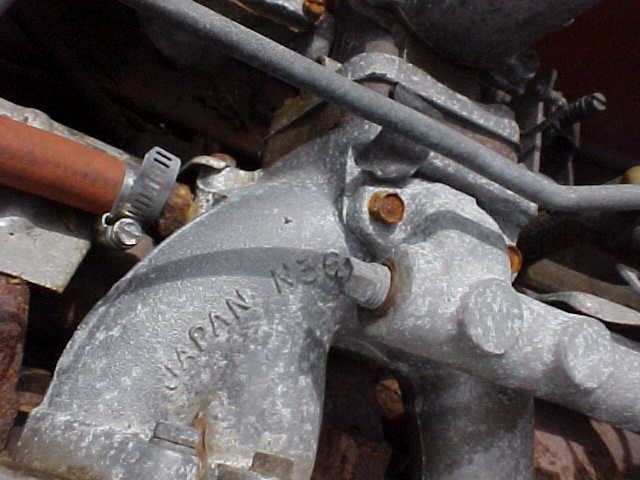

I read about the N33 manifold which from my reading appears to be found stock on 1973 240Z's. Then the N36 was found on all 260's. Someone mentioned in one post that I found that the N33 and the N36 were essentially the same thing. How true is this. I am assuming that sticking an N33 on there would bring me the same benifits as sticking an N36 on my 240z. Is the assumption correct or would there still be another benifit to having a N36 or a N33?
Also it seemed that the majority opinion on the N36 regarding HP was that only a highly modified engine would benifit a HP increase. If this is true would the same car experience the same thing from an N33 and if so how close would the benifits be compared to the N36.

you ansered your own question the 33 and 36 are the same. here is a vary good web site for this kind of info. geocities.com/zgarage2001/engine.htm I doubt that you would be able to feel the difference between the manifold that you are useing now and either the 33 or 36 . On a dino maybe. try the web site there is a ton of information there . Gary:classic:
