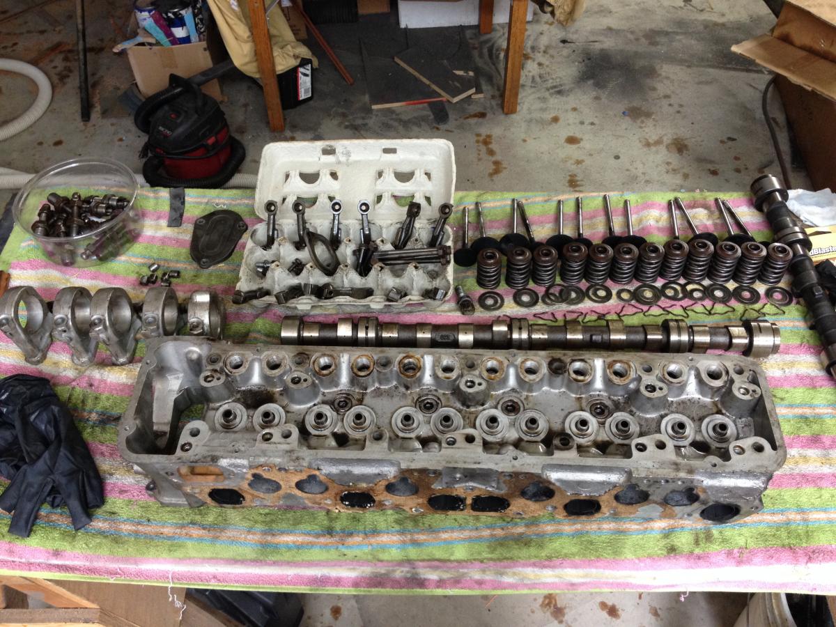

attacked the head today - 45 min and i threw my hands up and yelled "roped & tied!"
post-28907-0-92685300-1431208493_thumb.j
will take it in for clean-up and surfacing, cc for current volume and shave if necessary to get c/r up to 9.75:1

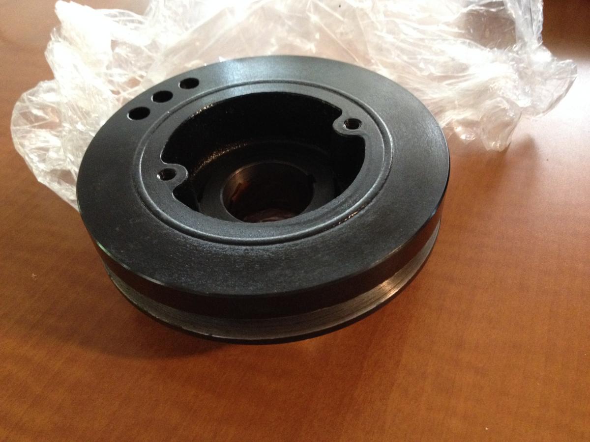

new single-row balancer
post-28907-0-07057100-1431208496_thumb.j

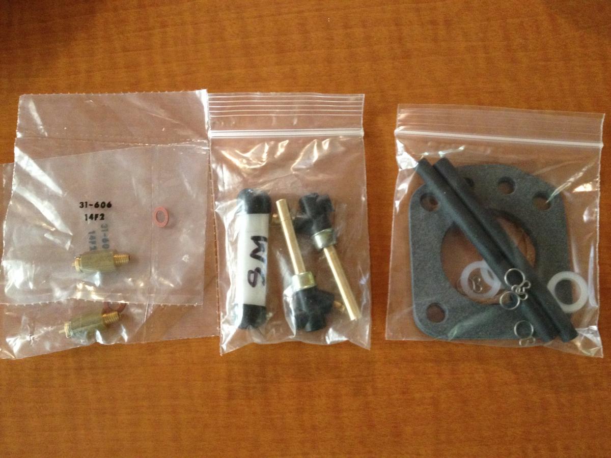

ztherapy rebuild kit
post-28907-0-96130700-1431208490_thumb.j
