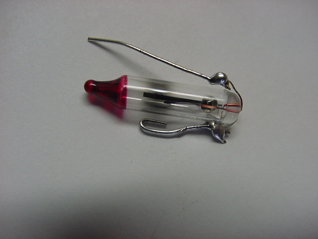

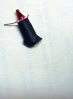

Here is a photo of the completed bulb-timer:
Photo 1:
I clipped the leads from a willing resistor ad formed a tint loop in the ends of each.  Then I used very fine sandpaper to clean the black coating (which prevented soldering) from the leads of the bulb. I made a little hook in the bolb leads and hooked them to the resistor wires, ad soldered.  then I bent the leads up s the new leads  went t the top of the bulb.  Then I got a short piece of heat-shrink tubing ad encapsulated  the whole mess, so the new leads stick out enough to solder wires to. Photo 2.
It still works!  I was afraid the think leads of the bulb would break off after soldering so that's why I covered it all wit the heat-shrink tube.
I tested the bulb again with the dinger to see if it had any kind of preferred "orientation."  It doesn't.  Just hook it up inline with either the +12V or Gnd wire of your dinger.
The dinger was listed on eBay as "HYUNDAI ACCENT BELL CHIME  96820-25100"  Oter models on eBay  has similar chimes.
Photo 1:
I clipped the leads from an old resistor and formed a tiny loop in the ends of each.  Then I used very fine sandpaper to clean the black coating (which prevented soldering) from the leads of the bulb. I made a little hook in the bulb leads and hooked them to the resistor wires, and soldered.  Then I bent the leads up so the new leads  went to the top of the bulb.  Then I got a short piece of heat-shrink tubing ad encapsulated  the whole mess, so the new leads stick out enough to solder wires to. Photo 2.
It still works!
I was afraid the thin leads of the bulb would break off after soldering so that's why I covered it all with the heat-shrink tube.  All I need to do now is to solder some short  wires to the leads that stick out, and a small connector (probably from the old buzzer.)
The dinger was listed on eBay as "HYUNDAI ACCENT BELL CHIME" Other models on eBay  have similar chimes.

That's awesome! I love the simplicity of the solution and I'm thrilled that the easiest solution actually worked! Of course, they usually don't,
The bulb is glowing a little brighter than I think it should, so you might burn it out sooner than it would in normal application, but unless you purposely leave your headlights on, it probably won't matter. And even if it does go south, it cost what... fifty cents?
If you find you're popping bulbs like gumdrops, then just use the flashy bulb to drive a transistor. Similar to what you drew for using the self-blinking LED to drive the transistor. You can use a resistor or two to adjust the current down a little and also to generate a base voltage for a transistor switch.
Just remember, that the dimmer it glows, the shorter the off cycle, and the longer the on cycle will be.

That's where I got the leads from the resistor. I was trying a couple different values (1k, 470k ohms) to see if I could get the flashing to slow down, but neither had an effect, and the lamp didn't even light! (due to the black coating on the leads?)
The cost isn't the price of the  bulb;  it's really the hour I needed to solder on stronger leads, and probably another hour to  crawl under  the steering column to mount and plug it together. If a better, permanent thing comes along, I'll consider it.
In any case, The thing  is only there to alert you that the headlamps are on, which usually only happens occasionally instead of all the time, as well brake lamps illuminate. So I think the bulb should last a long time.
Any way, thanks for the educational discussion!
You gotta remember that the filament resistance on a bulb like that is only going to be a couple Ohms, so if you put a 1K resistor in series with it, you'll drop 99.9% of the voltage across the resistor and the current will be throttled down way too low to glow the filament. If you want to cut the brightness I'd start looking at adding maybe an Ohm or two. It might not have been the black coating, It may very well have been the resistor. Academic at this point however.
