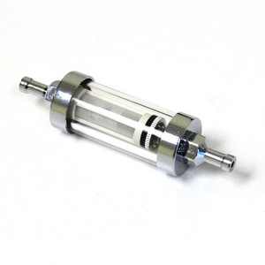

My car has the following clear fuel filter installed since 2011:
http://www.jcwhitney.com/p2031712/sku-1044796.jcwx?filterid=c2018d1659u0j1
The leak comes out from the black screw on adapter which are plastic.

Here's what mine have, http://www.oreillyauto.com/site/c/detail/MGD0/33087/02515.oap?year=1972&make=Nissan&model=240Z&vi=5142640&ck=Search_02515_5142640_1149&pt=02515&ppt=C0359
first, then I use these before the pump.
$T2eC16dHJF8E9nnC8IHdBRE,5o7bHw~~60_35.J
then these before each carburetor,
Not sure if those are very safe. They can leak where the hoses clamp to the hose barbs (like any filter), also where the hose barbs screw in to the filter. There are O-rings at each end, they can leak too, especially if they're made of rubber that's not ethanol-
resistant.
If there's a fuel pump before the filter it can leak gas. If it's a mechanical pump after the filter it can let in air bubbles.
