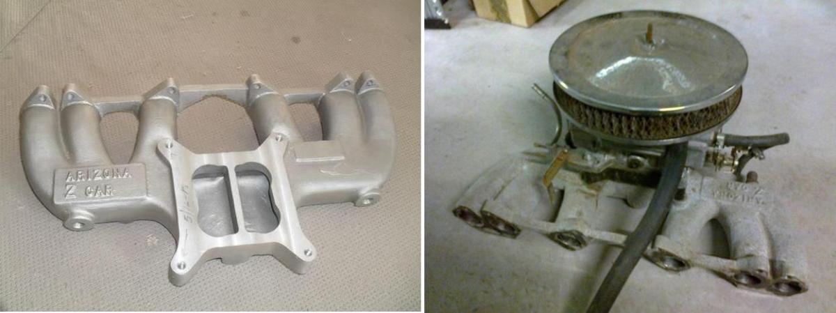

picking up a 71 240z on Saturday that has a 4 bbl intake manifold on it.  Anyone know much about them?  This car has been hacked up.  Going to make it a respectable driver, parts car already acquired!  Not my first Z build, did an rb25 swap in a 240 for a guy a year ago.  This one is mine though :)

I havent seen one in person, but they dont come with a great reputation.  Supposedly they dont evenly distribute the air/fuel mixture to the outside cylinders.  You should be able to make it run though and the holley should be easy to rebuild

The holley 4bbl manifold was a common swap on the old Nissan patrols to replace the old single downdraght carb.
I have a couple photos of one on a patrol somewhere. Its considered as a replacement and not a performence add on. IMO SU's will work much better. The holley tends to be rich in cylinders 3 and 4 and leans out in 1 and 6.

thanks for the comments.  Haven't been able to do much till the car comes in on saturday.  Gotta get the parts car off the trailer first.  haha  I thought the 4 bbl setup would be worth some money and i could sell it off to buy more parts, oh well..Have a set of factory carbs on the parts  that will probably go in.  A lot to do on this one.. ANYONE NEED A FUEL CELL?  EEKS!
