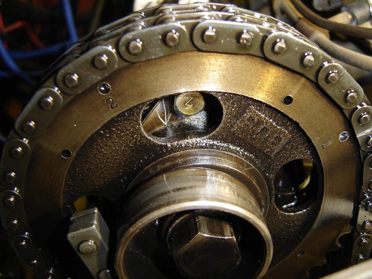

Well, cam timing is good then. Thanks for the link!
Flywheel is there, all the teeth are good (starter and flywheel), but the gear on starter don't kick out. So a new starter is in order as well as a new oil pan (or I can have my friend weld it shut). Cylinders 3 and 4 are the same height, cylinders 2 and 5 are the same height, but cylinders 1 and 6 are not. Cylinder 1 is where I'd expect it to be but cylinder 6 is acting like it's maybe 7-11 degrees ATDC where as cylinder 1 is closer to 20 degrees ATDC. So $5 on a spun rod bearing for cylinder 1 and the crank being wore down. Which also would mean that valves got tapped. Thus meaning a new oil pump (and possibly sump), intake and exhaust valve, pistons, rods, and a crank (basically a bottom end rebuild). But if I have to go that far, might as well as deck the head some and do new valves all the way around. Gonna have to refrain myself from getting the exhaust ported too... I hate visiting the machinist. I always walk in with a set budget and double or triple it by the time I leave. What can I say, I love building for power. Which is why I need to get a running RB or I'll have a $5k bill. Haha.
