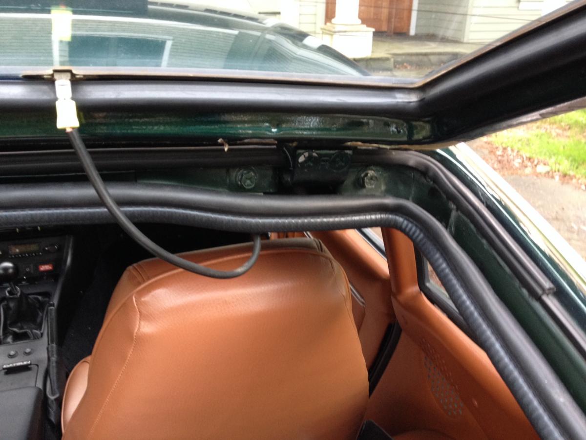

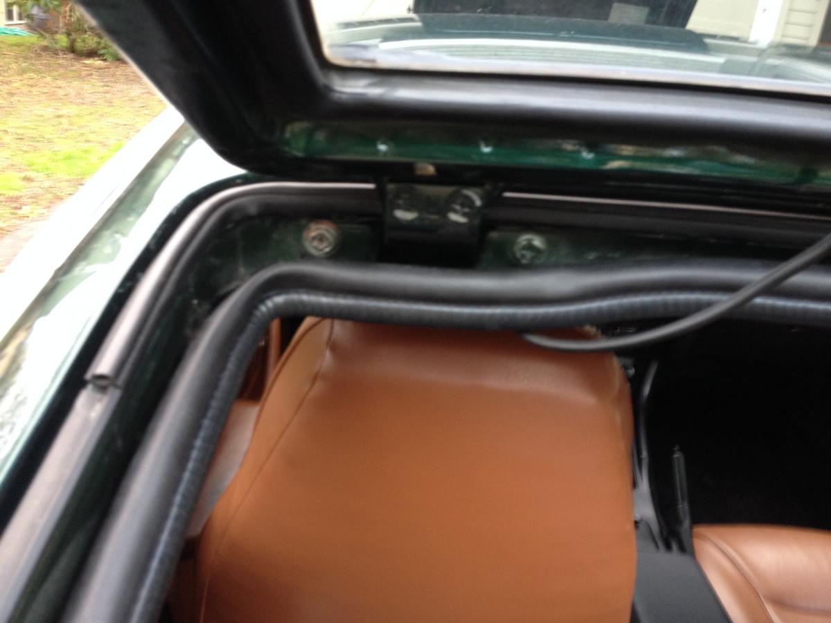

the kia seal is super easy to install, but it did bump into my interior plastic panels in a couple of places, which makes the fit a little wonky, but it does the job fine for the price.

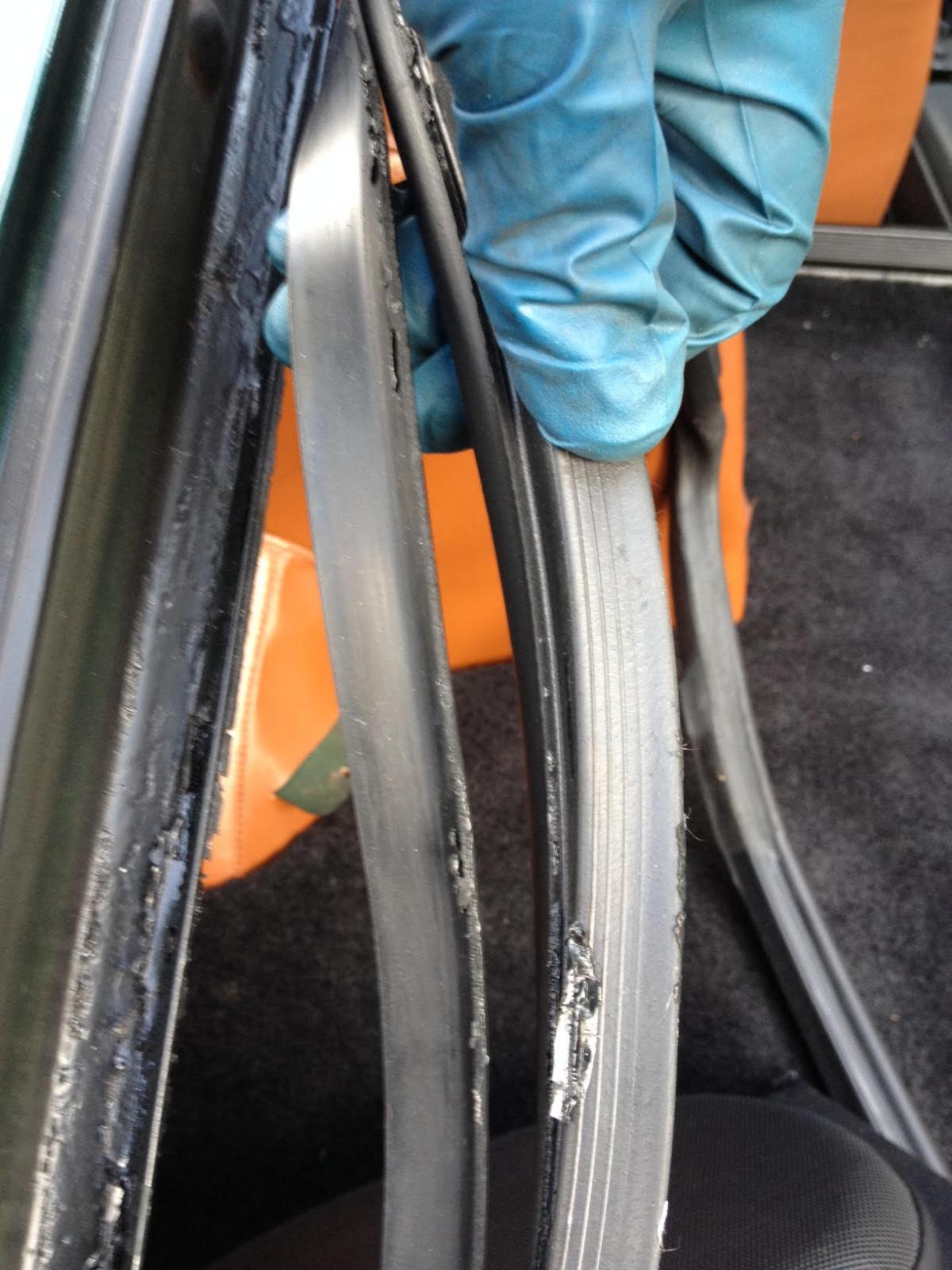

post-28907-0-13226300-1422288591_thumb.j
post-28907-0-80114500-1422288592_thumb.j

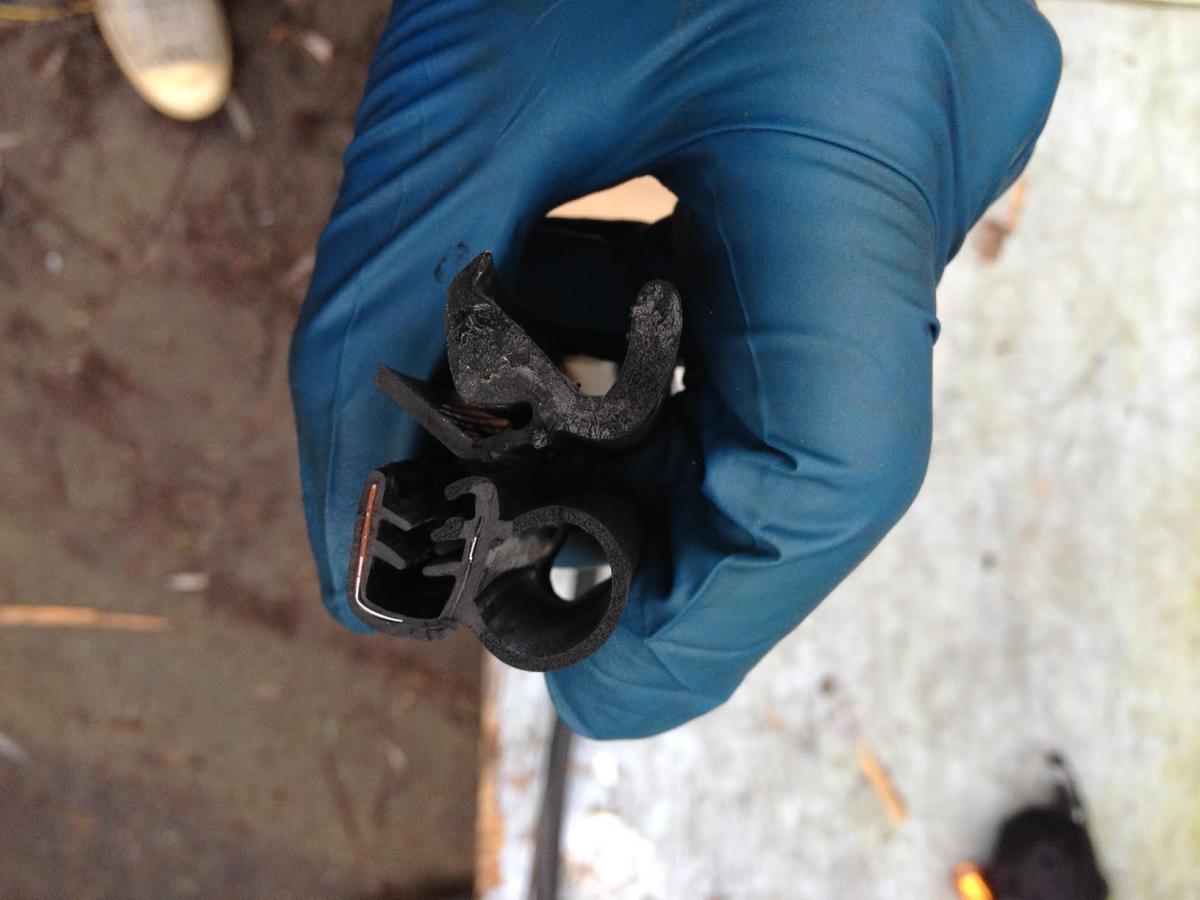

comparison of oem to kia profile

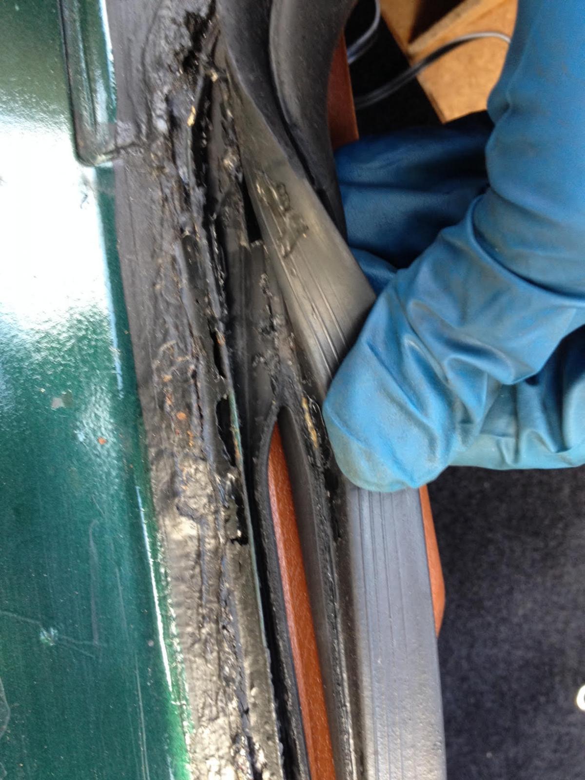

post-28907-0-68086000-1422288605_thumb.j
my old seal was falling apart

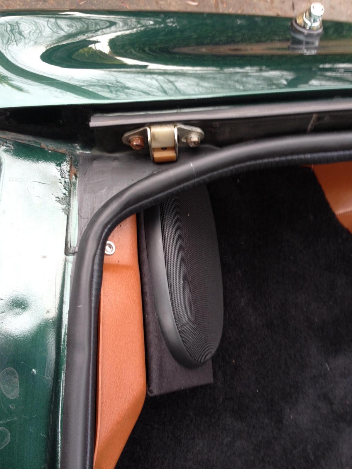

post-28907-0-38141800-1422288594_thumb.j
post-28907-0-72273300-1422288595_thumb.j

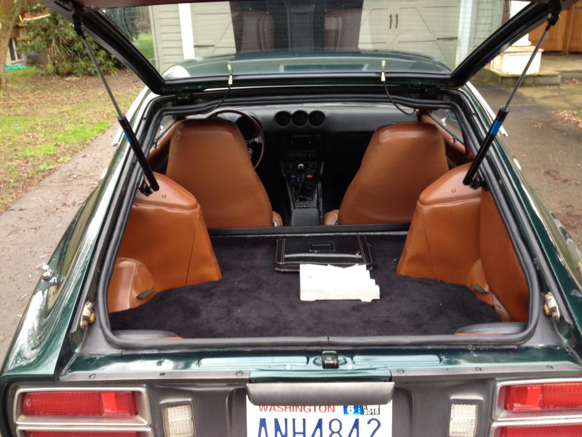

press it on, trim the ends and done

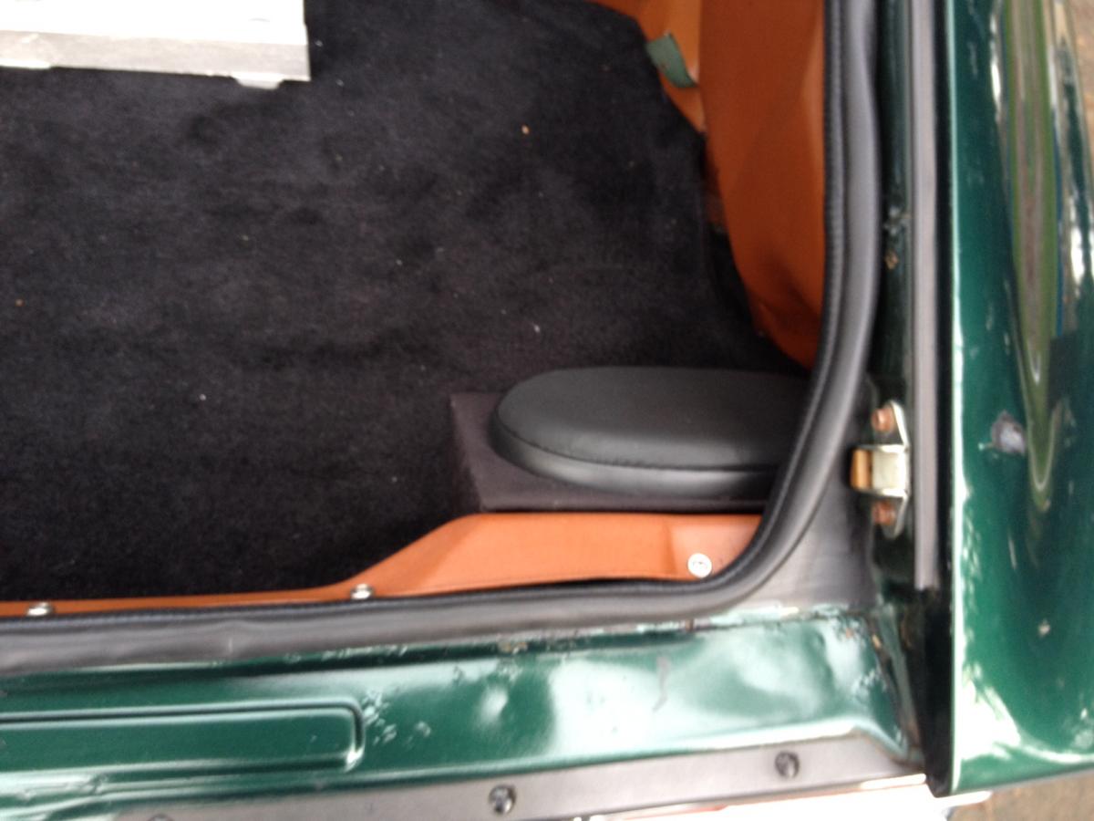

post-28907-0-20664900-1422288597_thumb.j
post-28907-0-22513200-1422288599_thumb.j
post-28907-0-97784000-1422288600_thumb.j
post-28907-0-78806600-1422288602_thumb.j
post-28907-0-65515500-1422288604_thumb.j

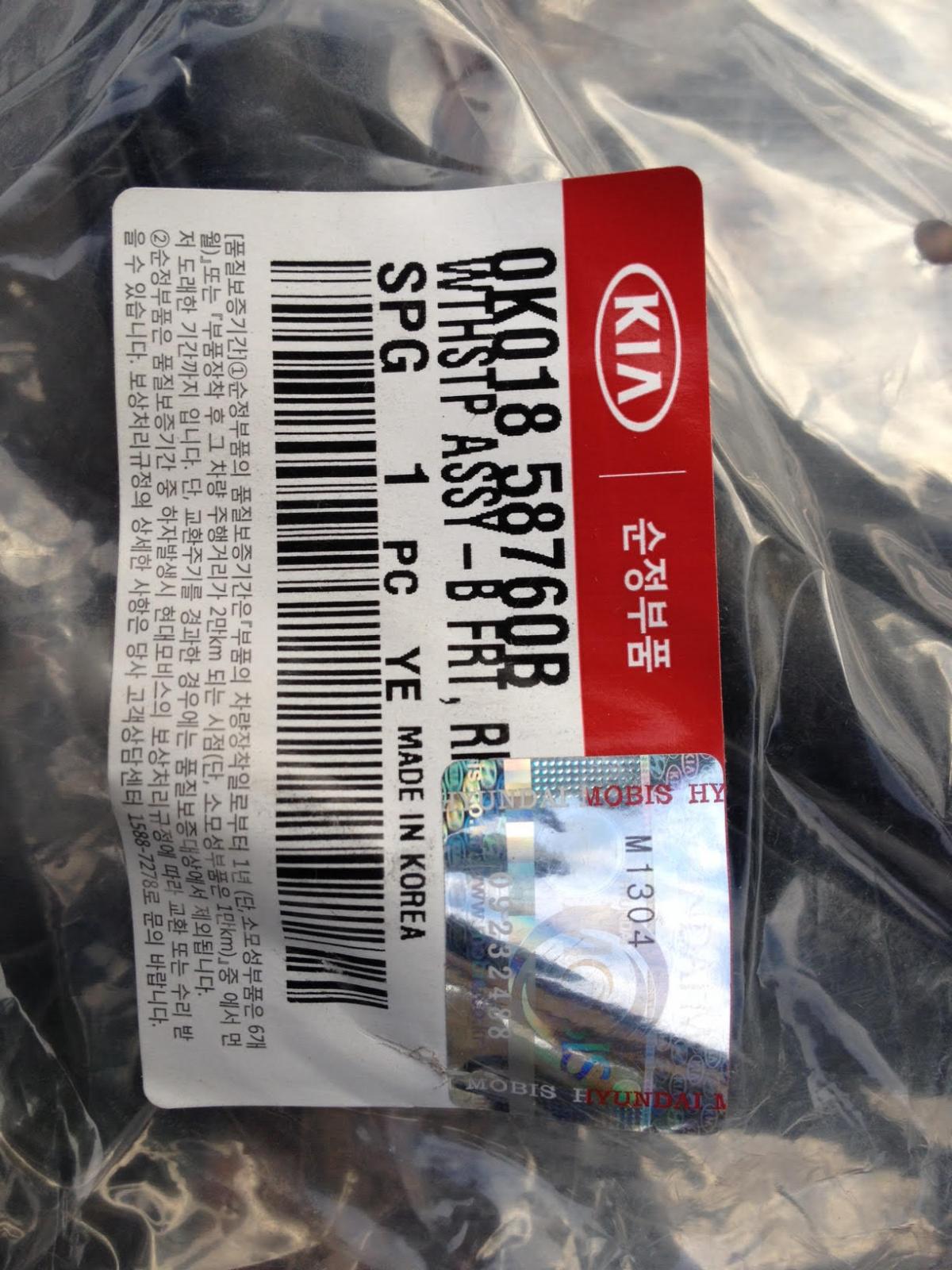

Someone, I think Tomohawk, asked a while ago about how many seals it takes to do a whole car.  Looks like you used a front door seal (http://www.kiapartsnow.com/genuine/kia-wthstp-frt-door~0k01858760b.html) to do the hatch, is that right?  So three door seals will do all three openings, but a person might not want the Kia Sportage hatch seal.
I didn't think a door seal would be long enough for the hatch but looks like I was wrong.
kia sportage - part number is:  0K01858760B
a single door seal will fit the hatch - hard to believe, but true. you will have about 1 1/2" left over.
