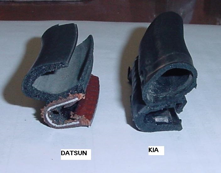

One problem I am running into after installing the Kia seal is my tail light cover trim piece does not wan to go back on.  The seal is thicker around the pinch grip and will not allow the trim panel holes to line up.  I would either need to lengthen/oval the holes in the panel or install a customer speaker box or something if I did not want to alter the original panel.  Right now I have the panel wedged in to place but it is not a permanent solution.  Did anyone else run in to this after installing their Kia hatch seal?
That is good to know, it's so easy for info like this to get lost.
maybe we should start referring to this topic as the Kia/Mazda seal.
FYI: You can also use a Mazda MPV van hatch seal. It's super long, and is pretty much the same as the kia one, and grips the hatch pinch-weld very tightly.
I like to press the seal flat with the palms of my hands before installing to the car, and it is pretty damn good at staying one. Just don't try to get "extra grip" by squeezing the steel channel in a vice or something. It will deform the steel grip channel and cause it to be bumpy in some areas.
Looking at the photo in #31, it seems that the little 'wing' on the 'interior' side isn't even needed for the S30, so that is the only thing that looks to me like it could possibly interfere with anything at all.
Compare to the photo of the Stock Datsun weatherstrip below, you will see the lack of the 'wing.'  In that case, I'd say the Mazda or the Z31 weatherstrip  is not a good substitute, without some modification.
