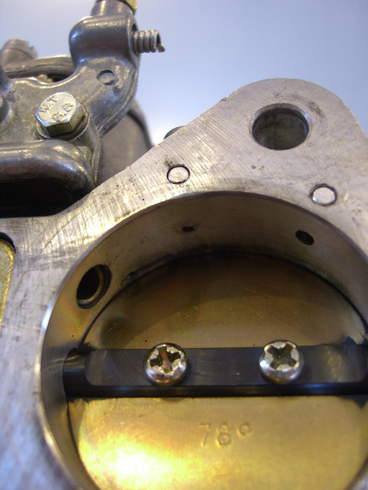

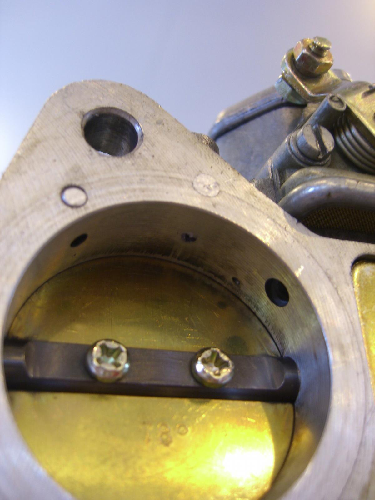

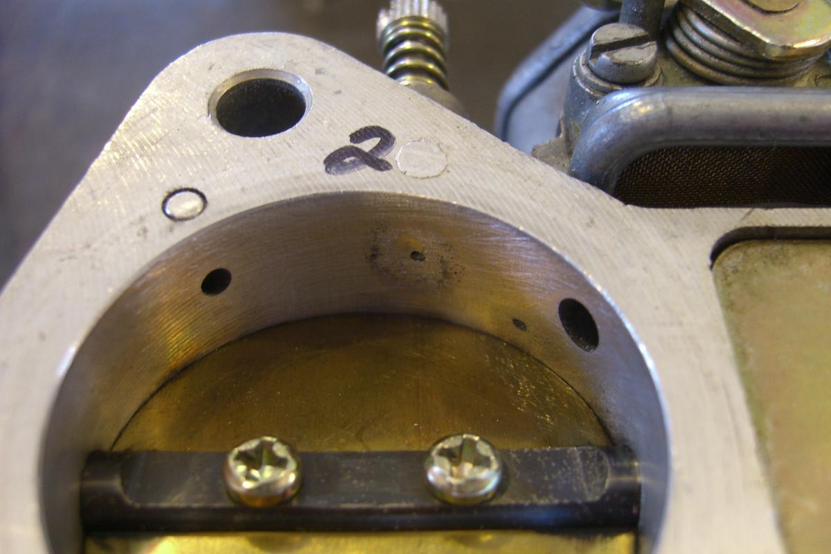

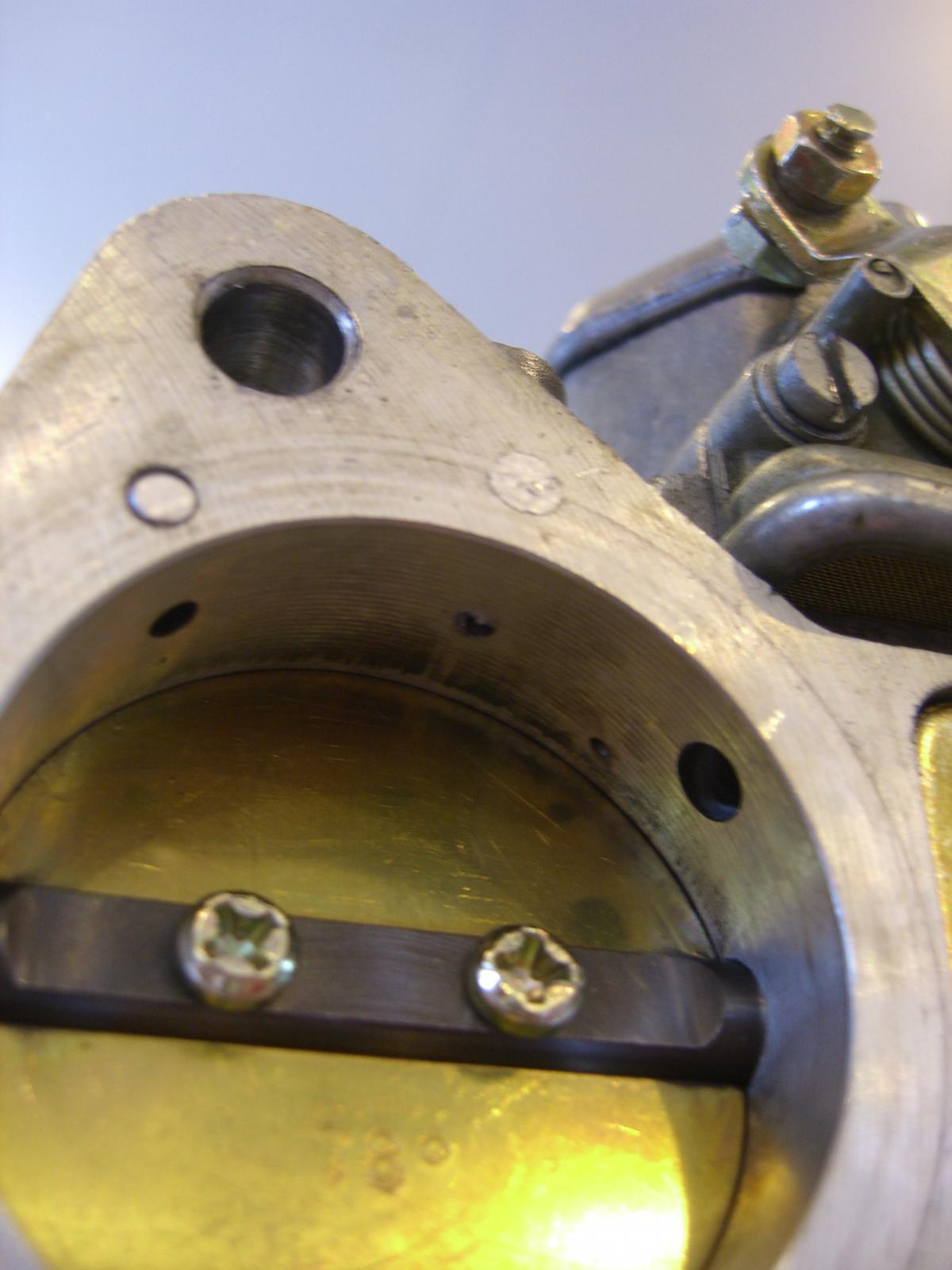

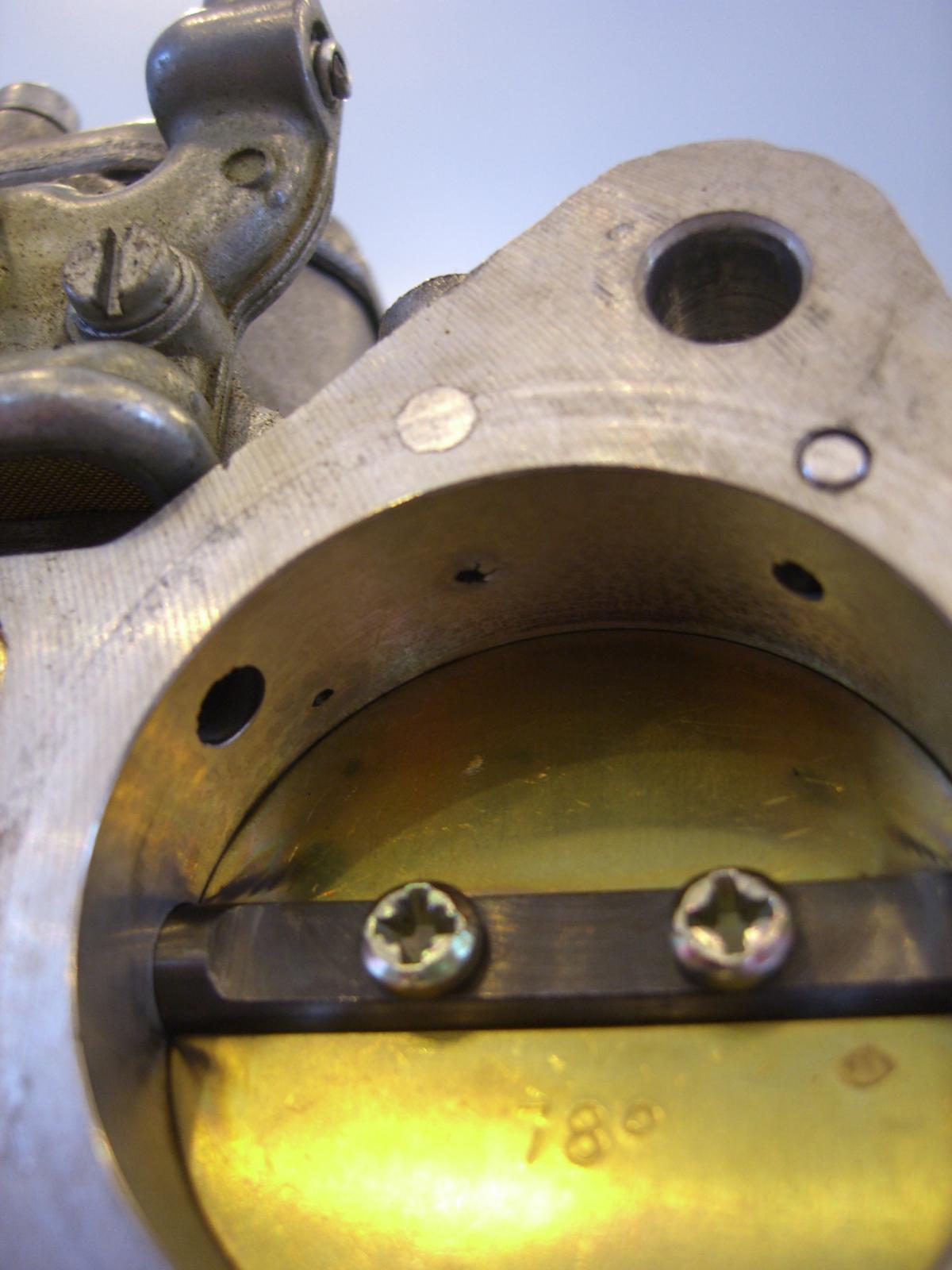

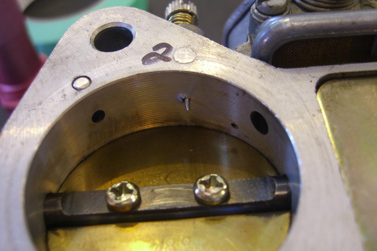

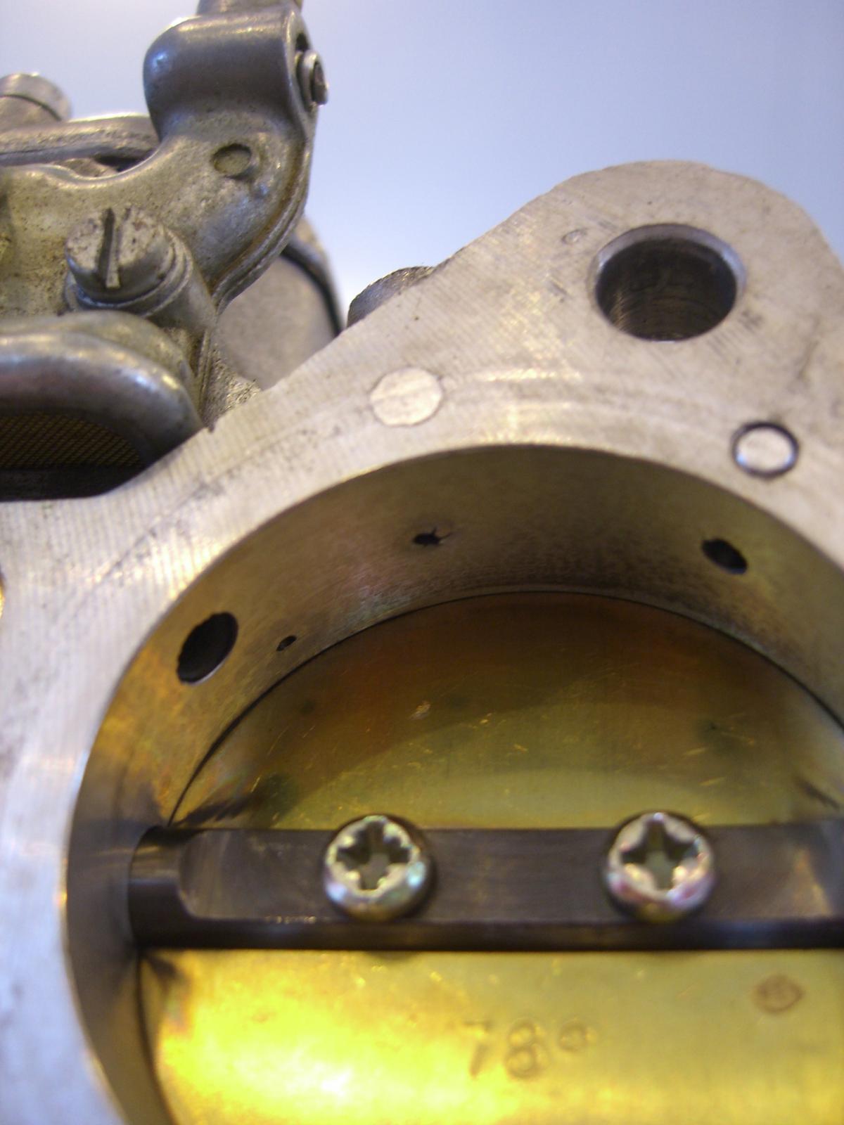

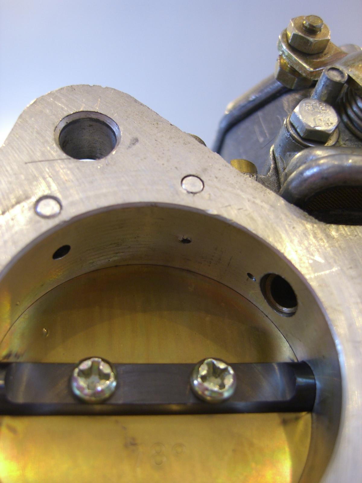

Later, when assembling a new airbox, I took out one of the mixture screws and realized it was now mishapened. I took them all out and they were all damaged. Clearly, I had overtightened them. No worries, right? I just ordered 6 more. Then I wondered about whether or not I had damaged the carb bodies...so I took the carbs off...and sure enough. The mixture screws had all poked through making the hole bigger, cracking it around the edges, etc. See photos (number corresponds to cylinder).

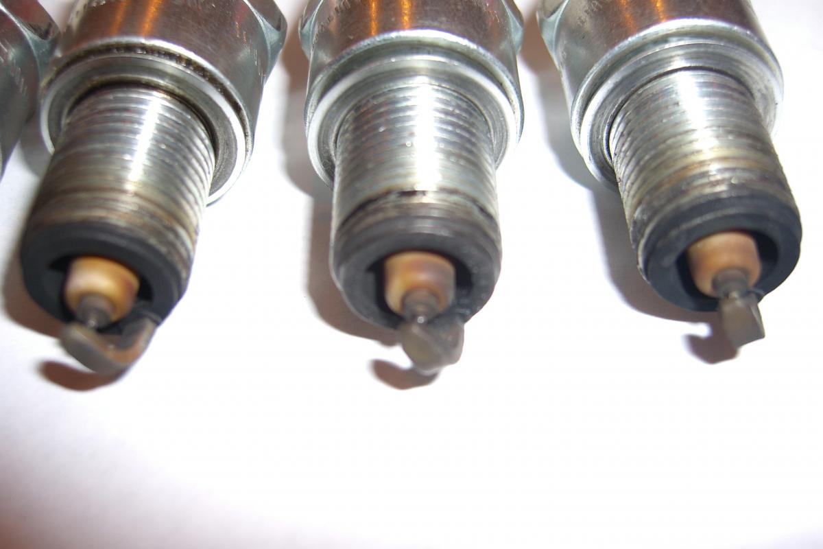

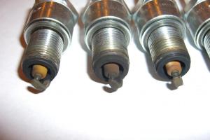

I got to these by running the car, pulling the plugs, and repeating. It took about 30 times, mostly to get #2 to go tan-ish instead of black. Here's what the plugs look like now (from 1-6):
post-24660-0-93739100-1422566077_thumb.j
post-24660-0-77881100-1422566091_thumb.j
I think the plugs look pretty good overall, much better than they did when we first tuned it (they were pretty black/dark even then), but the car now hesitates pretty badly right at the 2,000 mark and it didn't do that before.

Well, unfortunately, my suggestion would be to either live with it the way it is or get replacement carbs. The ones you have are "repairable", but not without extraordinary means.
If you can adjust the screws so that it idles OK and the plugs look good, then that's about the best you can do at this point. I know it's eating at you just knowing the damage is in there, but unless you've got the machines to do it and your labor time is "free", it would cost way more to fix those than to replace them.

Yeah, I'm sure you've thrown off the whole sensitivity of screw movement vs. mixture change because the holes are busted through. I'm guessing they're much more sensitive than they used to be.
A couple notes on the pic I posted... For a sense of scale, the tip of the idle mixture screw is maybe .020 and the hole is maybe .040? Also, you figured out that I didn't include the spring or sealing washers and O-ring on the mixture screw, right? Took 'em off for the photo. They're probably very similar to yours.

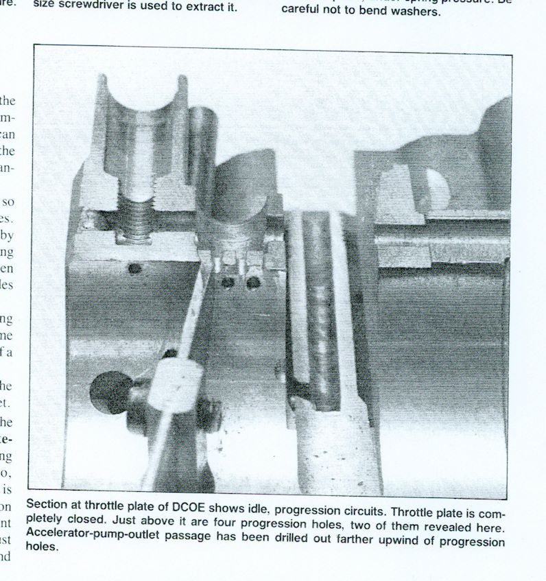

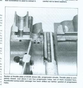

Thanks for your comments everyone--I just wanted to provide a final update here with information that might help others. I met with a fabricator/welder and we looked over the carbs, the damage, and the cutaway I've attached here (it was in the Weber book). We considered JB weld, plugs, bushings, etc., but in the end decided a very light weld over the hole would do the trick as long as it didn't overheat the carb or fill the void completely so we couldn't use the original hole (from the inside) to re-drill the hole.
We measured the original hole and it is somewhere between .052" and .055". They don't make bits in the middle size, so we went with the smaller one thinking it's easier to make it bigger, holes are always a hair bigger than the bit, and the reference hole we were measuring was probably enlarged anyway. .0535" would probably have been perfect, but we went with .052".
I've attached photos of the before, the after, and the cutaway image. Hope it helps!
